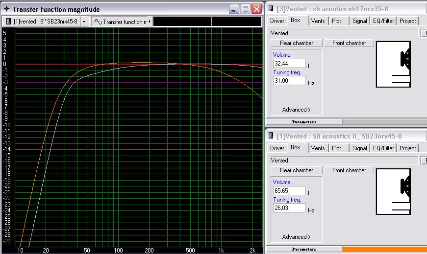

sb-acoustics

as of now the SB17 seems to be the winner. However, I would certainly like to talk more about the idea of using a larger driver with a midtweeter. assuming that optimal crossover frequencies for both drivers is not an issue, are there any other cons to this approach ?
