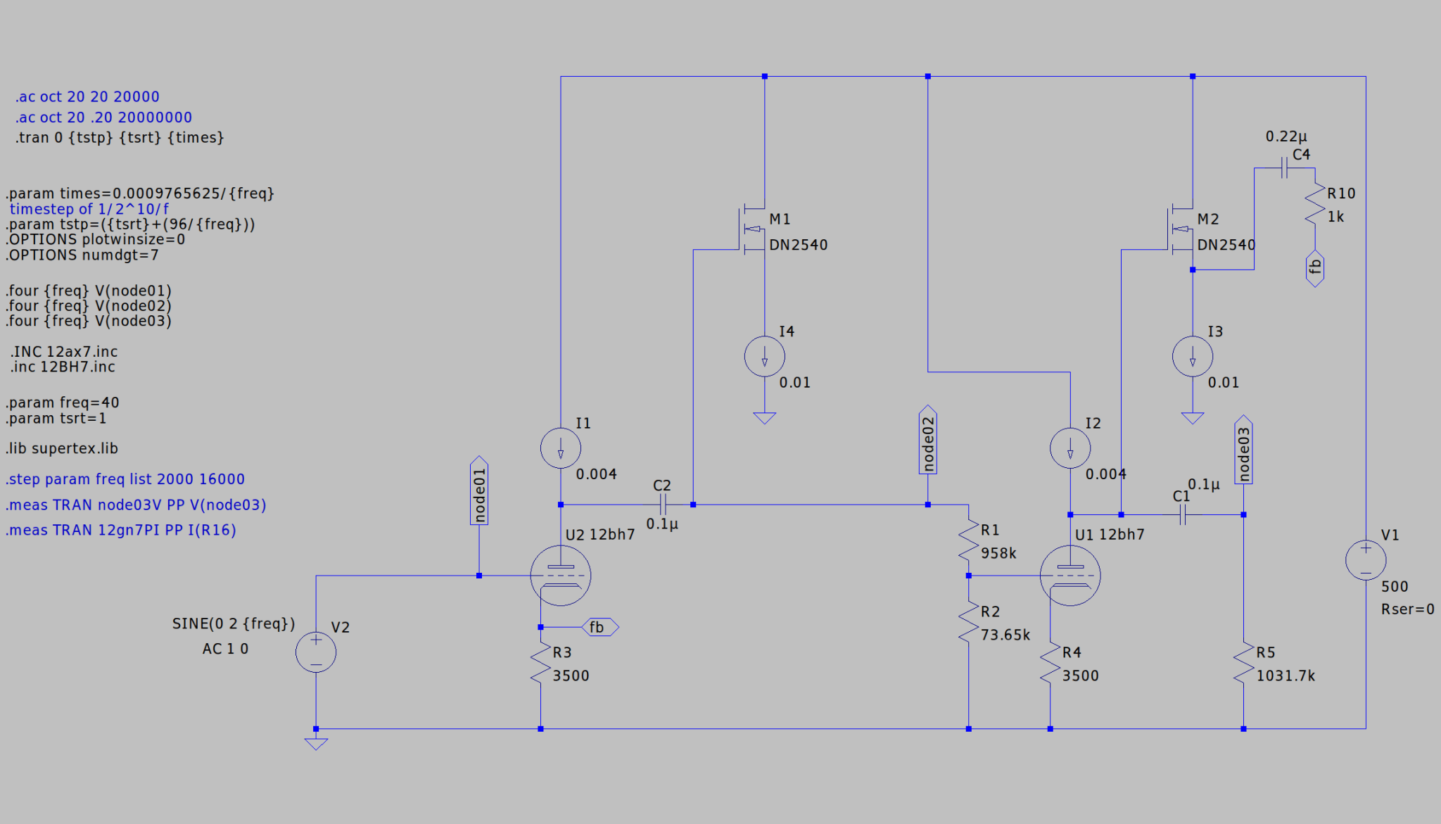

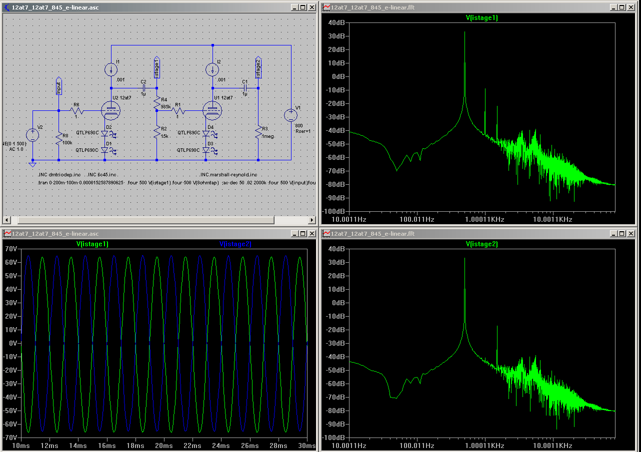

The circuit I posted isn't intended as a recommended input stage. It's solely a demo circuit to interrogate interactions between stage distortions under open loop and feedback conditions. The only requirement is that stages generate 2H. Ideal CSS loads and constant currents in this application lock two potential variables and simplifies analysis. My preference would have been to simulate a pair of ideal three terminal device (infinite input Z, zero output Z, in+, in-, out) with programmable 2H distortion but I couldn't figure out how to accomplish this in LTSpice.
Referential ambiguity on my part. "Increasing effectiveness as frequency increases" could have been clearer. The finding was that feedback's effectiveness increases with distortion harmonic number, not input frequency. 7H is reduced much more than 2H as feedback is dialled up for example. All sims were run at 40 Hz in the interest of calculation speed.
