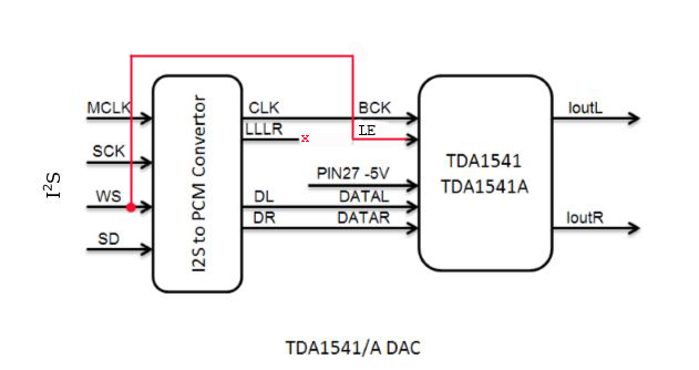

I would like to motivate all those who use an I2S-to-PCM board with a TDA1541a to try the following:
(1) Feed your Dac with a 44.1 khz signal (non-oversampled) and listen carefully to get an impression.
(2) Disconnect the LLLR out of the I2S-to-PCM board.
(3) Split the WS signal that goes into the I2S-to-PCM board and feed it both into the I2S-to-PCM (WS in) and also into the Latch Enable input of the TDA1541a. If you have a McFIFO just take a second u-fl cable and connect another WS out of the clock board to the LE in of the TDA1541a.
(4) Listen to some music and see if you notice the difference; specifically at 44.1khz.
In the case of my AYA Dac the difference was not subtle. Before the mod described above the heights sounded so recessed and muffled when feeding a 44.1khz signal that I contacted Pedja because I thought that my DAC was faulty. Oversampling in SOX to 88.2 or more solved that and clearly improved the sound. After the mod the music sounds brilliant at 44.1khz and with 44.1khz material I cannot hear a difference between a 44.1 and 88.2 or higher signal.

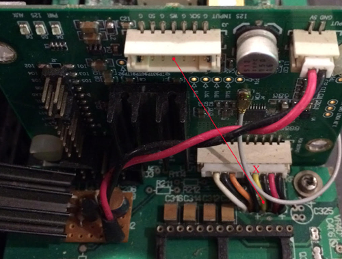

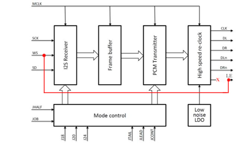

To confirm that you have reconfigured as per images.
If WS from re-clock board is okay driving both PCM board WS and 1541A LE without buffering, a simple cut and shut using the input header on the PCM board to jumper off to 1541A.

The wiring diagram you drew is correct and your pics show the right points to steal the signal and feed it back in.

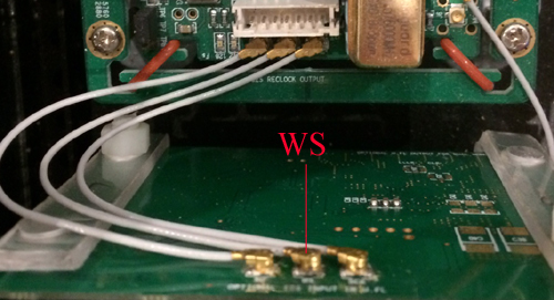

I built a quick-and-dirty setup to check whether my McFifo can drive both the PCM board and the DAC (see this picture), and this works. The yellow wire is connected to a u.fl cable using Ian's Raspberry adapter. (My permanent setup is to take the WS signal directly from the McFifo with the u.fl cable that you see connected to the yellow cable).
You seem to have the first generation clock board, so you have to try for yourself whether the signal is strong enough. Please describe your listening impression.

Ian I2S to PCM block diagram shows PCM outputs are re-clocked (presumably together), this will then be different. Maybe someone with some more knowledge can provide insight, and also to the additional loading of WS from the re-clock board... Mr Ian ??.
