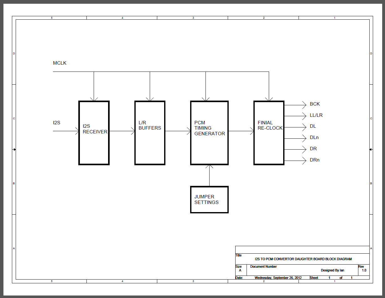

Maybe it should be highlighted that this board will also deliver the inverted data.
Especially for AD1865 as a stereo DAC, you can use one per channel.
As one channel is inverted, some currents will cancel out (eg Iout R = -Iout L), this can lead to improved performance, less modulation on the supplies and less ground bounce etc.
I like this feature as I want to have an all balanced setup from DAC to power amp.

Revised block diagram
Sorry, forgot put the DLn, DRn on the block diagram. Actually they were shown on the PCB silkscreen. Good eye! Here is the revised block diagram.
Inside my FPGA/CPLD design, DLn and DRn are not simply inverted by NOT buffers. They were synchronized by MCLK with the same raising edge. So, there is no delay between DL and DLn, as well as DR and DRn.
Yes, this feature is useful for configuring NOS DACs working at differential mode. It's very easy to setup two or four DACs into dual mono mode with those signals.

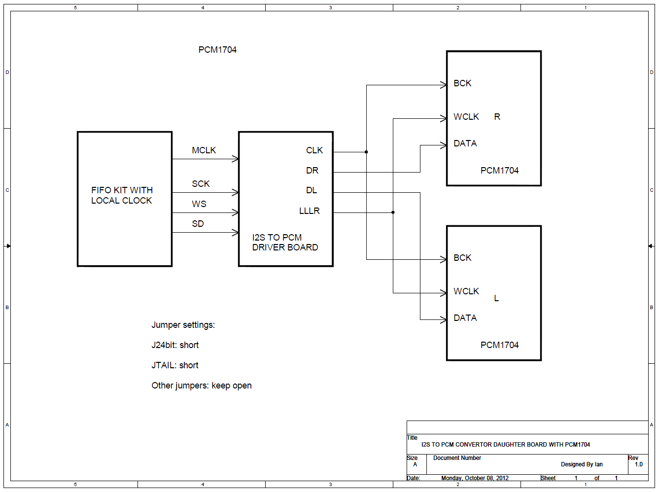

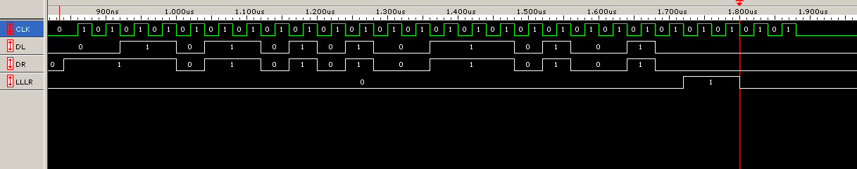

Testing result of PCM1704 timing from logic analyzer

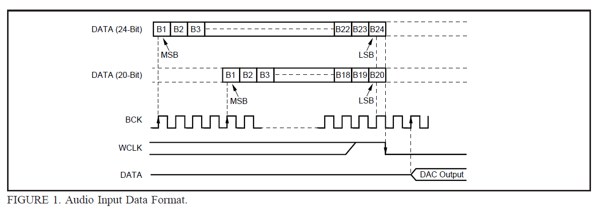

To get perfect timing for PCM1704, after 24 bit DL and DR shifted into left and right PCM1704, LLLR will go low, CLK will be continued for two additional times before stopped. This is because the special timing requirement of PCM1704. Please see the datasheet of PCM1704 for details. I also attached the waveform from the datasheet. Please correct me if there is anything wrong.
All of the signals will keep low for rest of time to reduce the noise. Please see the waveform from my logic analyzer.
Jumper settings:
J24bit: shorted
JTAIL: shorted
Rest jumpers: keep open
