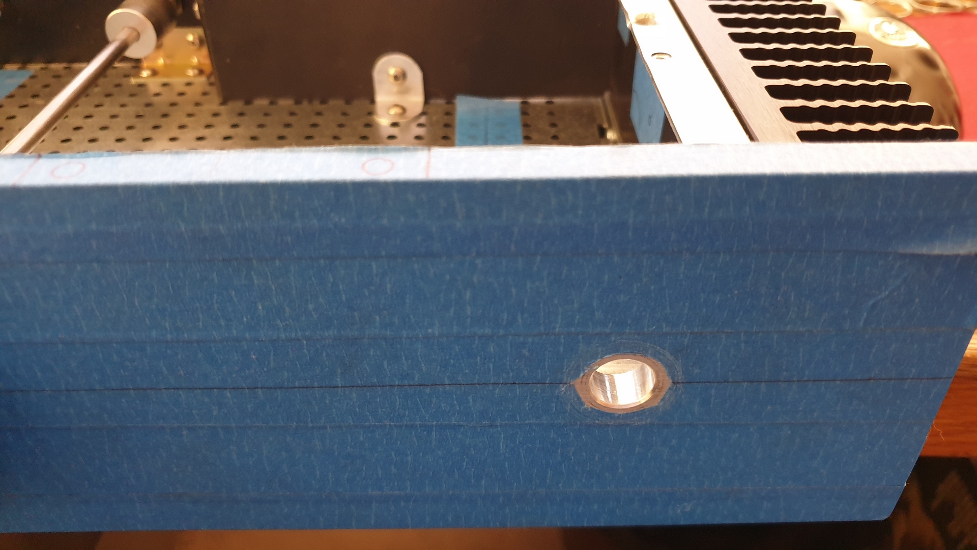

My method is basically as above,
-Cover the entire panel with blue painters tape to prevent scratches
-Mark out where i want to drill. Remember the old rule, measure twice, cut once.
-Center punch the hole
-Drill a small pilot hole ~3mm first (The larger the drill bit the more likely it is to walk around)
-Move up sizes, 4mm, 5mm, 6mm, etc
-Switch to a step drill bit and move up-to 10mm, then lightly touch the next stage, usually 12mm to de-burr the hole.
-For thick panels like 10mm, you will probably have to flip the panel over and do the same from the other side.
