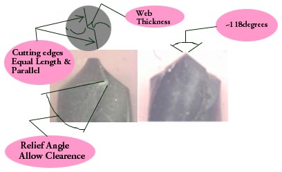

Hi Koy,
It's real tricky to do well, but here are a few pointers and an illustration.
The tip should be ground at about 118degrees included angle. a smaller angle (pointier) for softer materials. The cutting edges should be equal length and parallel. The web should form a chisel point at about 110degrees with the cutting edges. The relief should be ground back from the cutting edges at an angle of about 5 to 15 degrees. The softer materials get a steaper relief.
When grinding, hold the drill with the cutting edge parallel to the floor at just above spindle height on the grinding wheel. The drill should be held so the cutting edge is also parallel to the grinding wheel surface (about 59degrees from straight). Now drop the shank for the drill down about 5degrees and you're ready to start sharpening.
Move the drill into the wheel and as it starts to make contact, move the shank down and the tip up asyou move the drill in toward the wheel in a smooth motion. Rotate the drill 180degrees and do the same on the other cutting edge. Alternate from one edge to the other making sure they remain the exact same length and parallel to each other.
Practice on some junk drills to get the hang of it. The shorter the drill gets the thicker the web becomes. It's even trickier to thin out the web, but it can be done.
...or you can go buy a drill sharpener from the hardware store. In any case, have fun.😉

Thanks a lot, guys! Esp. Rodyama. This picture I needed! It is for my father ( beeing retired he has lot of time) he is going to learn it (and than he will teach me 🙂.
