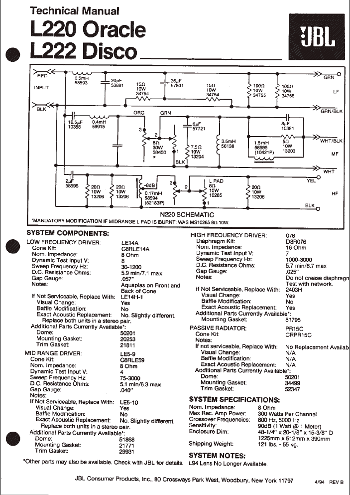

Ideally I'd like solid state on the low end and tubes on the mid-high but dunno if my L220 crossovers can be used in biamp.
It seems possible that you could modify the L220 crossover so that the LF section was one input and the MID/HF is another. Here is the schematic (from audioheritage.org)
You could start with one Firstwatt (Aleph J, F4, F5, M2, F6... etc) and build a second Firstwatt later and have biamp mono-blocks.
I think so too, the crossover are very old fashioned, you can see from the attached pic (I had the electrolytic caps upgraded with new film ones), it won't be bad to use the tubes on the mid-high section and solid states at the bottom
