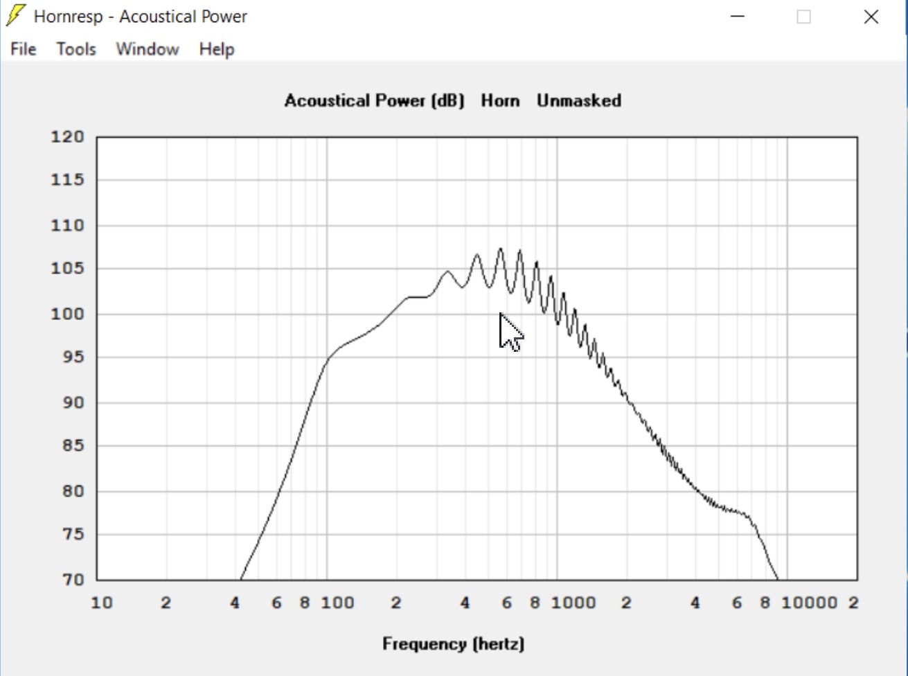

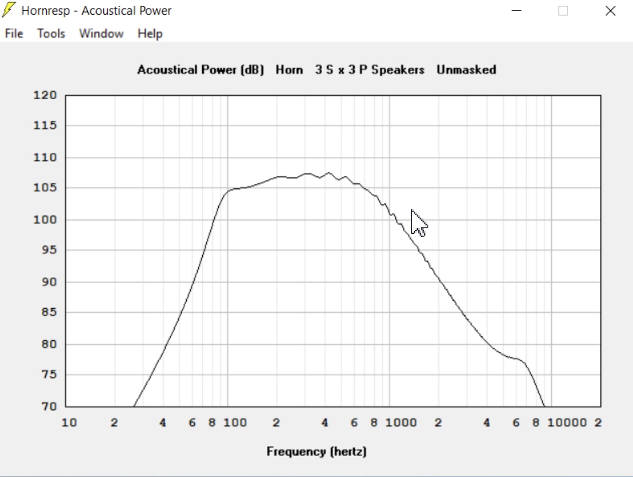

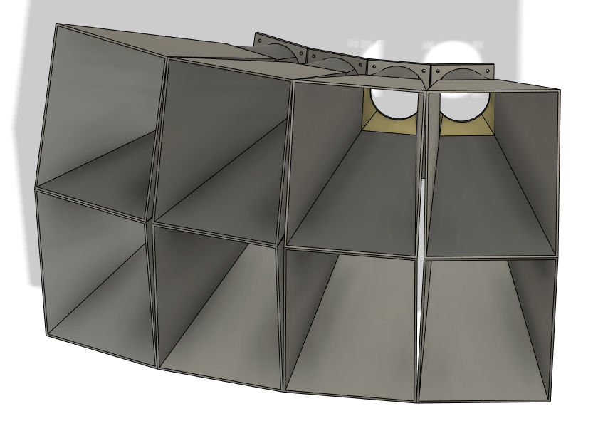

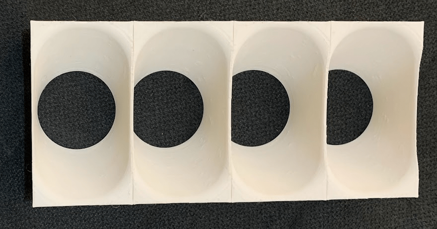

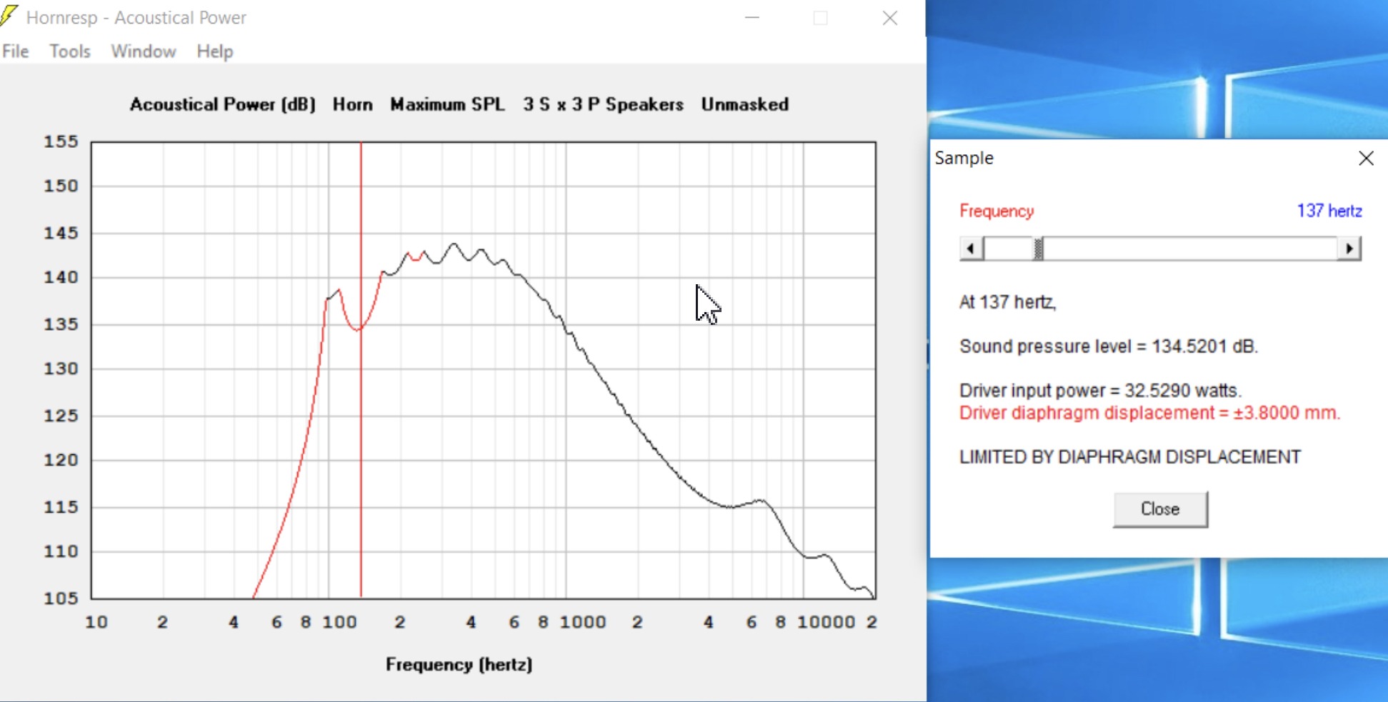

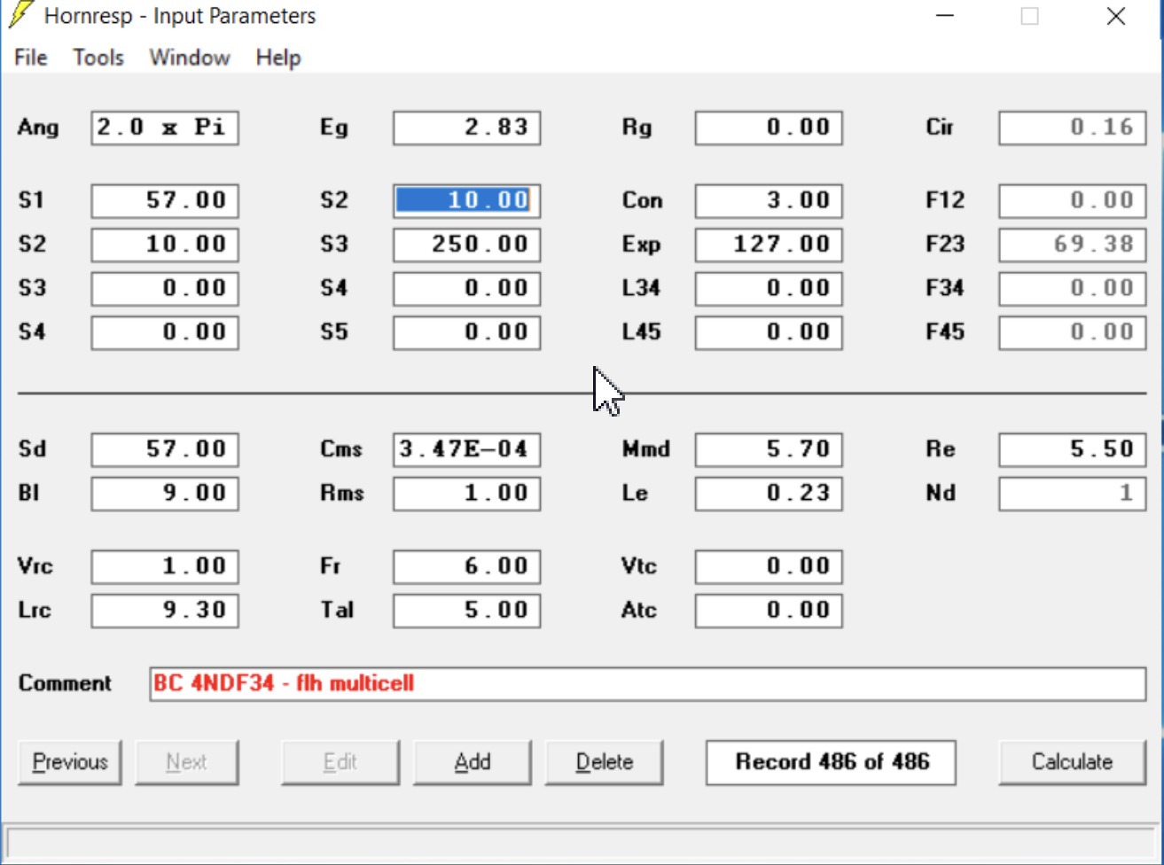

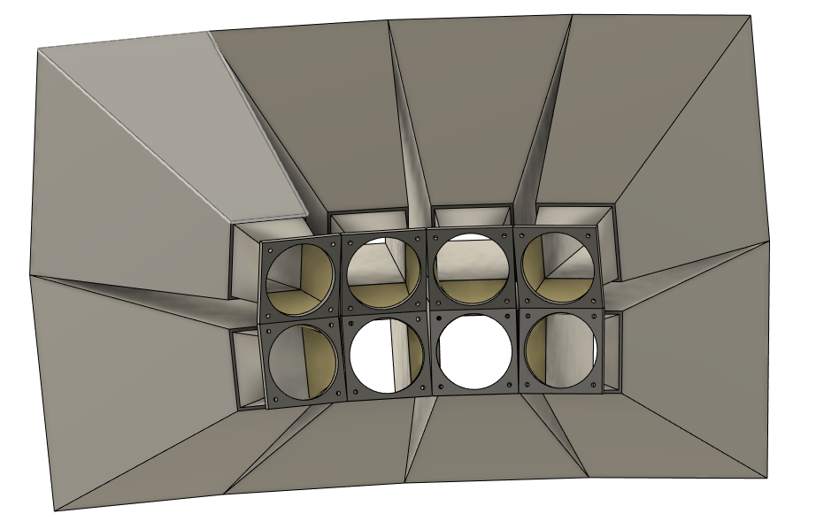

I sure would like to see somebody do a reality check on the concept in a more advanced program. It is one thing to fiddle around I hornresp and get a nice frequency response. But can it even be built? I haven’t made a drawing yet so I don’t know.
Oh by the way, I’m the Swedish guy you gave you model to so I could shrinking your 2khz multicell to my toy VOT A7. And it was back in February we discussed the concept at the “Horn loudspeaker forum”
I remember a company that no longer makes speakers that combined multiple 4” Faital pro in to a single horn. It’s not the same but similar.We can't be the only ones to have thought of this over the past 90 years. But I have not seen it done.
How many hours have I spent with Hornresp doing sims of hons like this, but never built one. Would it sound as good as a single diver (almost) single point horn? Or would it wound more like a typical line array with all the phase issues that entails?

Do I imagine it correctly that it is something like a giant compression driver made from single units with a "phase plug" at the output?
