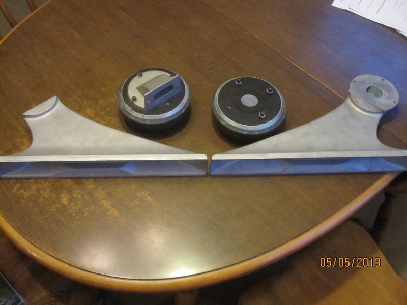

I get the impression that Earl has never been into putting lipstick on a pig, whereas I do a lot of work in car audio, where we're often using waveguides that are wildly axisymmetric, and a lot have reflectors in them!
Ironically, I eventually realize that putting lipstick on a pig is a bad idea. I reached a point where instead of using wildly axisymmetric waveguides, I just started using mostly symmetrical waveguides that were smaller.
Old school car audio waveguides looked like this:
