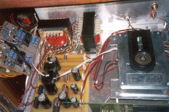

First, I comleted the CD-PRO2 cd player and I was quite satisfied from the outcome. Although from its internal DAC, the sound I got was way better from my previous Marantz CD-52.

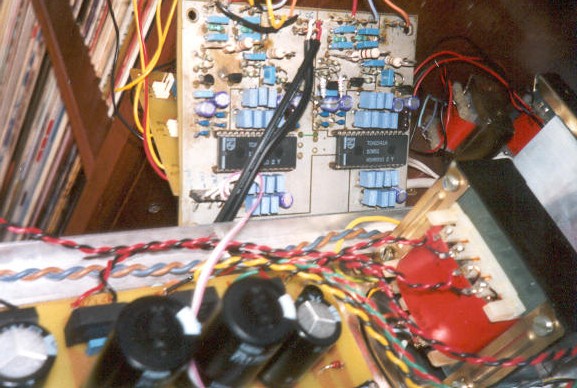

After that, it was time to build the DAC. I had already searched in the Internet and had found a number of implementations. What I finally decided was two paralleled non-oversampling TDA1541s, TL431 shunt regulators on each chip, passive I/V conversion and tubed output buffer with a 6C45Pi.
The DAC worked perfectly from the first moment I fired it up. From the first notes I could hear a great difference between the built-in and the external DAC (I connected the TDA1541 DAC to a free input of my preamp, so I could have an instant comparison between the two). The sound turned out to be more “analog”. There was much air around instruments, while the soundstage was wider and deeper.

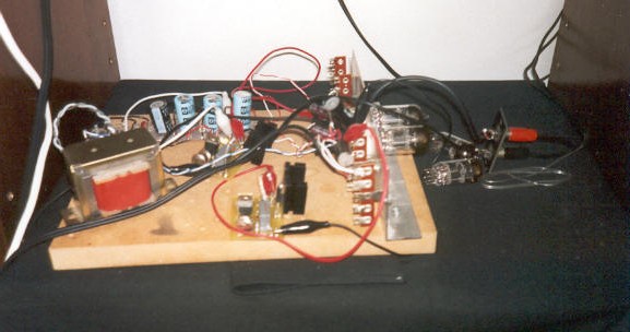

Then, I decided to try something diferent. Instead of a resistor load, I wanted to try a CCS load on the output buffer tubes. It seemed that Gary Pimm’ s BBMCCCS should do the job. After completing and testing the two CCSs, I connected them to the circuit and fed with music. God, this was a HUGE improvement! Suddenly the soundstage aquired a great width and depth, resolution was superb, macro- and micro-dynamics were great, analysis was really high, sound is sweet and physical lacking all the harshness I was used to hear from digital, in all, I can say it was an unbelievable sound. I had never heard digital sound beeing so analog. One more thing I noticed is that, although many say that a NOS DAC lacks highs due to the sinx/x effect, I must say that highs are much better than those from the internal DAC.
Although the tube circuit is still in a breadboard form, HT power supply is the simplest I could make just to check the circuit, I’ m so satisfied from the sound, that I can’ t take the decision to take the whole thing apart and build it properly, I just want to listen to music.
Next, I will have to build a proper HT power supply, separate the parts in two cases (one for the transformers – quite a lot of them – and raw power supplies and one for the CD-PRO2 unit, power supply rgulators, DAC board and output buffer) and take care of the esthetics of the cases.

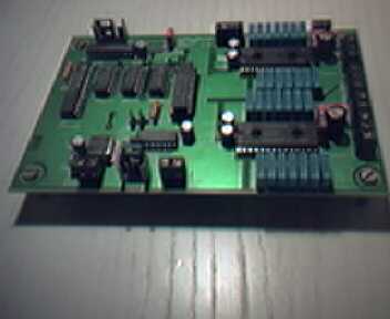

You got me very interested. I'm looking for a nice output for the pcb below! Is it possible to post some schematics or a link to them? Also the powersupply you used is interesting.

The output stage I used is very simple: a single triode (6C45Pi) in common cathode configuration, with a constant current source as an anode load. You can see a basic schematic at Lesha' s site:
http://users.podolsk.ru/boga/DAC.html
You can also check A. Galavotti' s design:
http://www.geocities.com/agalavotti/zerodac.htm
Both these are almost identical and they use a choke as an anode load. Having read a lot about the merits of a CCS, I decided to use Garry Pimm' s BBMCCCS, as it is simple to build, costs almost nothing compared to an anode choke and it doesn' t need so much space in the cd player box such as an anode load choke.

This got me confused: "Then, I decided to try something diferent. Instead of a resistor load, I wanted to try a CCS load on the output buffer tubes." Did you mean choke instead of resistor?
Thought you were talking about the resistors on the DAC output. I'm not so much into tubes.. I'll checkout BBMMCCCS.
I was talking about DAC powersupply, are you using TL's? Think i see three of them per DAC. I was thinking of trying a different PS for the analog and digital (TL's) DAC supplies.

Guido,
No, I was talking about loading the anode of the outpur buffer tube, where I used a constant current source. For the BBMCCCS check out here:
http://home.pacifier.com/~gpimm/
Yes, I use three TL431s on each dac chip, that means a total of six TLs. A lot of experienced enginneers support the idea of using different PS lines for each supply input. I even used different transformers for the digital (+/- 5 V) and analog (-15 V) supply lines, both with an ES shield.
