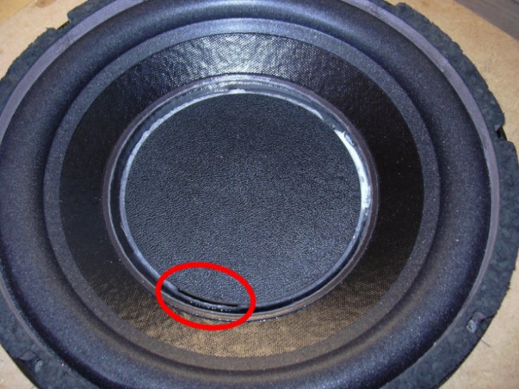

A couple of threads ago, I complained about my adire audio DPL 12 woofer which was making strange noises. After relocating the speaker, things got WAY better. However, it stil made a little bit of noise. Add the midranges and the tweeters, and it is almost completeley masked. Almost...
This weekend I hooked it up to a friends 2x250W RMS carver amp. Sounded like **** to him, and I had to agree it wasn't quite all that. So I took a knife and cut off the dustcap (yes, pure loudspeaker horror). There is a plastic-ish disc under the dustcap, which is glued to the cone. Apparently the manufacturer didn't use enough glue. If the cone moves backward, there is some pressure under this disc (a pole vent helps, but doesn't get rid of all the pressure), so if there is an opening between the disc and the cone, the air can move from under the disc to under the dustcap. Since the dustcap is just paper, it starts deforming/rattling/etcetera. Without the dustcap, it makes a lot less noise, and I think after glueing it properly, it won't make any noise at all. I'll glue it next week, when I have both the patience and the right glue...
I attached a picture with the 'evidence'. Since this is a manufacturing problem, the speaker should be under warranty. I won't go through the trouble of sending it back to the US, I'll just ask Adire to send me a new dustcap. I think they'll agree, since this is less expensive for them, and saves a lot of time.

Im happy that you figured out what was wrong otter, and if I recall correctly the second dust cap is only for aesthetics, and I cant imagine the loss of a cosmetic dustcap affecting its Fs much.

Guys, guys, guys... Stop fighting please. I only wanted to mention that a badly glued disc can cause noise, although the woofer looks intact, so people would know this kind of problem exists and pay attention to it if they experience something similar.
