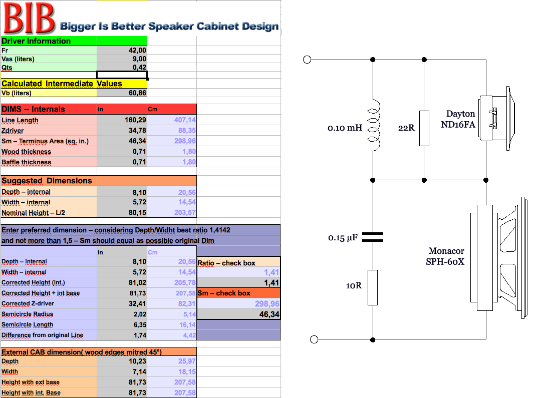

Lotsa recent changes regarding work has forced me to rethink my BIBs and cut costs. Getting the BOFUs to Sweden is gonna be $78 in shipping alone, smaller cabs will help in more ways than costs, etc. Im on post #1576 in the BIB post and Ive learned a bit more.
As the reprioritized plans are now its Monacor SPH-60X with the Dayton ND16FA. Scottmoose mentioned lowering Fs by (max) 0.707 in a post. Since I like a musical and convincing bass Im gonna go for that. Im guessing it will help with cone excursion as well? Wether I can trust Monacors specs is another matter.
Im gonna try a series filter as Ive found I like the sound of them. I have no idea why that is. If someone has an explanation for why that is. Please let me know. Gonna order filter parts in different values. Namely: 1R, 2R2, 4R7, 10R, 22R, 2.2μF, 15μF, 0.1mH so that I can try different series and parallell filter versions.
Attatching a screen dump of the spread sheet calcs plus the filter wich at this point is – at best, an ill informed sketch and a shot in the dark. Not sure if thats the correct way to dampen the tweeter or if the component values are feasible. Found this topology while googling for info on series filter and ran some calcs I found. Advice is greatly appriciated.
Yet another option is to skip the tweeter and filter, trust that the tonal balance will be okay without BSC. Peter Brorsson has this setup in the big BIB thread.
Best regards /Bo
PS. Ive also included an overlay I made of two different graphs for the Monacor SPH-60 and SPH-68. If someone other than me has a use for it. Awesome 🙂 DS

FWIW, the SPH60X is a drop in replacement in TC's RS 40-1354 BIB, so shouldn't need any BSC.
GM
Thanks GM. Think Im gonna go for a tweeter + XO. Gonna need that wide upper range dispersion.
Any thoughts on the series filter?

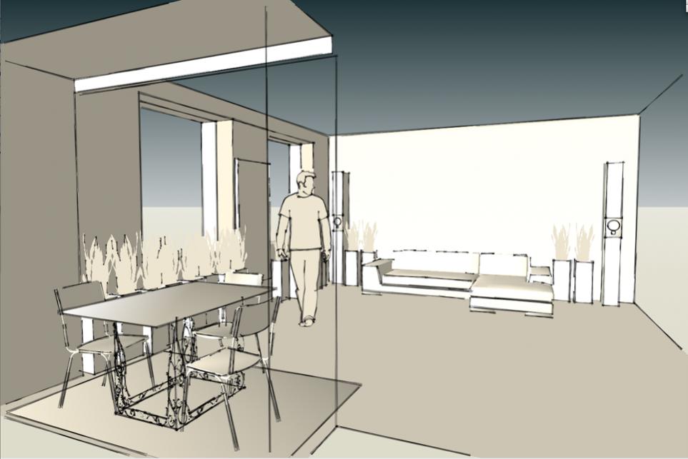

The blueprint for my apartmaent was a bit off so Im redoing my Sketchup with fresh measurements. Heres the latest render.
