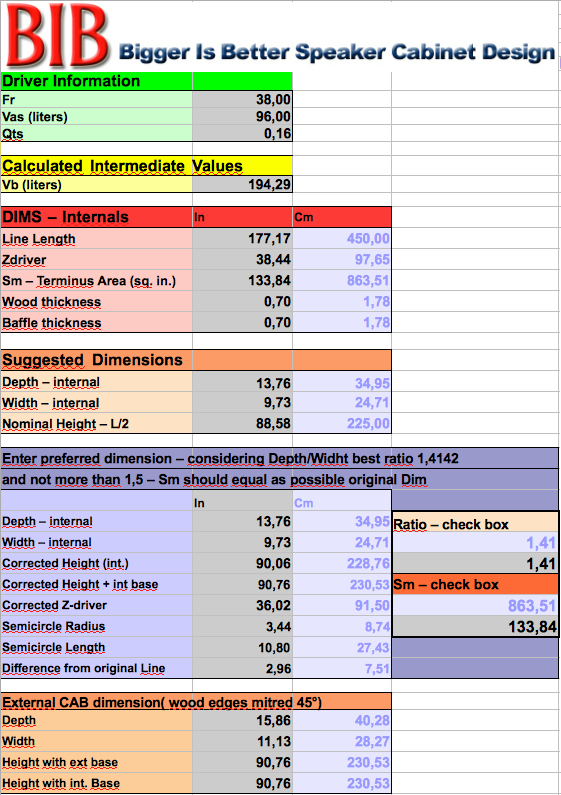

Quick question? Has anyone tried undersizing a BIBs footprint and not the length? What will generally happen? Im guessing an overdamped bass? Can that be rectified with a lower damping power amp, ie higher impedance?
Reason Im asking is Ive been oogling all the rave over the BOFU and the BIB but doing the math in Zillaspeaks spreadsheet. Its humongeous. The attachments shows my fiddling with the qts value to reach less tank like proportions.
Whats ur opinions on this?

Ive been thinkin 10" x 12" (to keep the depth/width ratio) and my BIB spreadsheet says 90.5" tall.

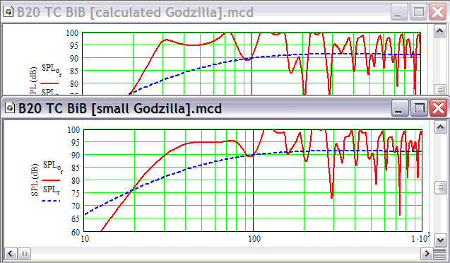

"Can someone generate a frequency response chart for a BIB using the B20 in an 80" x 12" x 12" BIB. I would if i could but i don't have the software to make the chart. That's 144"^2 and with corner loading in the sketch it may work."
Godzilla here's what I get:
Using the original (fullsize) B20 BIB from the dimensions on your website (Bigger Is Better 'BIB' Cabinet Dimensions - ZillaSpeak) I get:
This is a little bit different from the frequency response you show.
Using the smaller dimensions above with zdriver = L*0.217 or 13.36 inches I get:

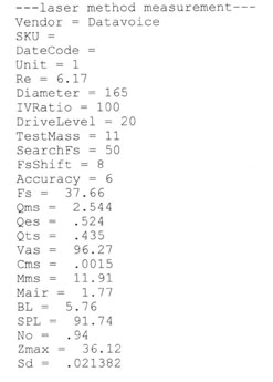

Wow. Thats quite a difference... Dont know if this helps but heres some parameters for the BOFU. Many, many thanks for doing the sim 🙂
Hmm, 13.36"/0.217 = ~61.57" path-length, but for an 80" internal height that I assume GZ means, the sim needs to have a 160" path-length. Regardless, for a given tuning (Fp) with such an acoustically small mouth (Sm) will kill off much of its mid-bass gain which is where you usually need it most and what I meant by 'ugly'.

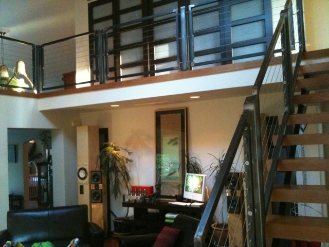

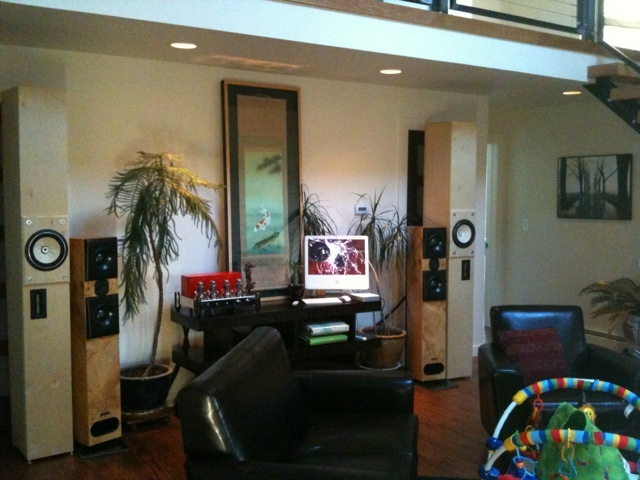

Here is a photo of my newly completed (but not finished) BIBs. They are 80" tall and about 12" x 10" and built close to the specs per the BIB calculator for the main driver, the Fostex 208 sigma. I added a super tweeter, the Fountek CD2.0 for kicks. Probably not needed.
They are quite imposing. Next to them are a pair of Acoustic Zen Adagios for size. The Adagios may be for sale soon 😛
I am going to post my own thread, since I have questions and thoughts on these and don't want to hijack this thread, but a thought for the OP:
If you notice in my pictures the speakers, at over 2 meters tall, come close to the ceiling and that creates a big bass amplification. In my LR, the ceiling over the speakers is an overhang and most of the room is up to 18ft (6 meters) tall and super open. If I stand under the overhang...boom...boom.. too much bass. In a room like yours I would be concerned that a box this big will be overpowering.
I will try to listen to them in a lower ceiling-ed room, but moving them, and everything else is a pain.
I could be wrong and I am getting less bass than I want. I have some digital room correction (very rudimentary) and I do get a low frequency distortion from the woofers, I think due to under damping of the big box and I plan to try to fix it with stuffing above and around the woofer as well as with the DEQ. Anyway that is for the other thread.
I think in your room, you may get plenty of bass with a smaller driver and box. Bigger is better, but you may not like it if it is too big...

Godzilla BIB comparison using MJK's original MathCad software - note that I used some older driver measured specs I already had loaded, but for comparison purposes it's good enough to see how a smaller Sm/slower expansion rate affects a simple conical horn's gain BW:
