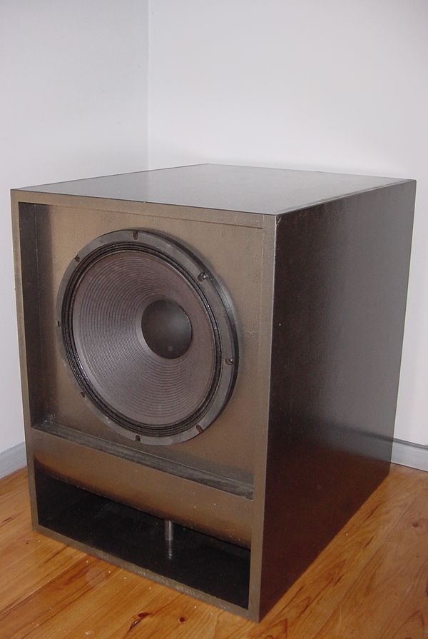

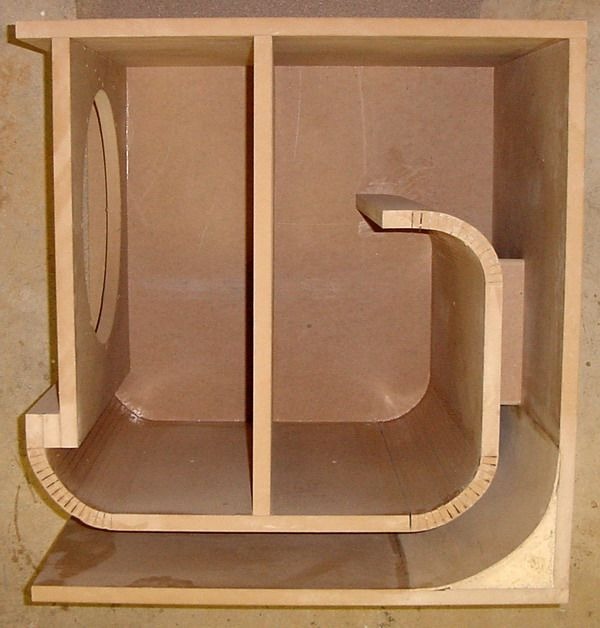

This box has a port that is Sd/2. Driver is an 18LW1400. Port compression and noise were low enough. Usable box volume is 250L, the port added 100L or so to that, from memory.
An Sd/1 port would be crazy big, with little benefit, IMHO.
