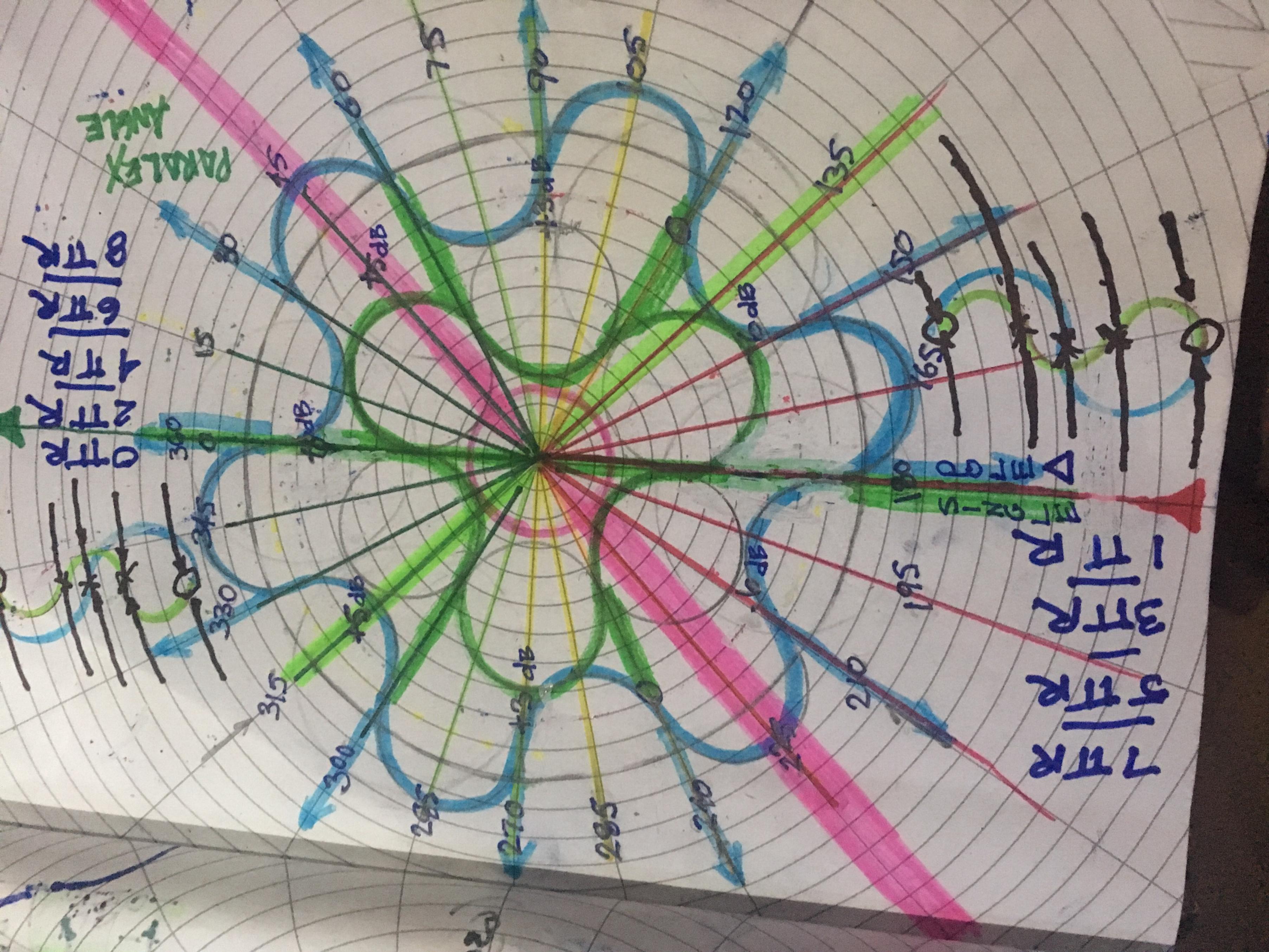

I think 30 degrees is where we space that. The compression ratio is likely the actual 30 degrees in the way pi/6 is in 2 pi r? This is hard to think of as degrees, but whatver the length is in a theoretical Pipe of 360 degrees, theres the 30. S two pipes on each side would have to be. Its has to exist and at 30, its good to go in every way that matters on the way out. I guess it's 30/60/90 in the position it is for its own wave? That might be 30/45/60 but im just not looking at the start because it gone if you start at an imaginary 30? Only to show up at 11/4? Of a qw? I think ?
I hope this shows what i mean. Put 60 degrees at start. Or put it at 45? The explanation sucks, and i apologize in advance but the fact remains the orange a nd yellow are perfect pairs in every way if their are part of the functioning length. Including another sides output. That dimension is okay in two ways but the exit or last of the impedamce encounters cant be too small either. As seen in throat chambers trying to cheat it. To fit in a way that then will expand theres a good video of slot and ill find it. Its better than my-drivel. Lol!

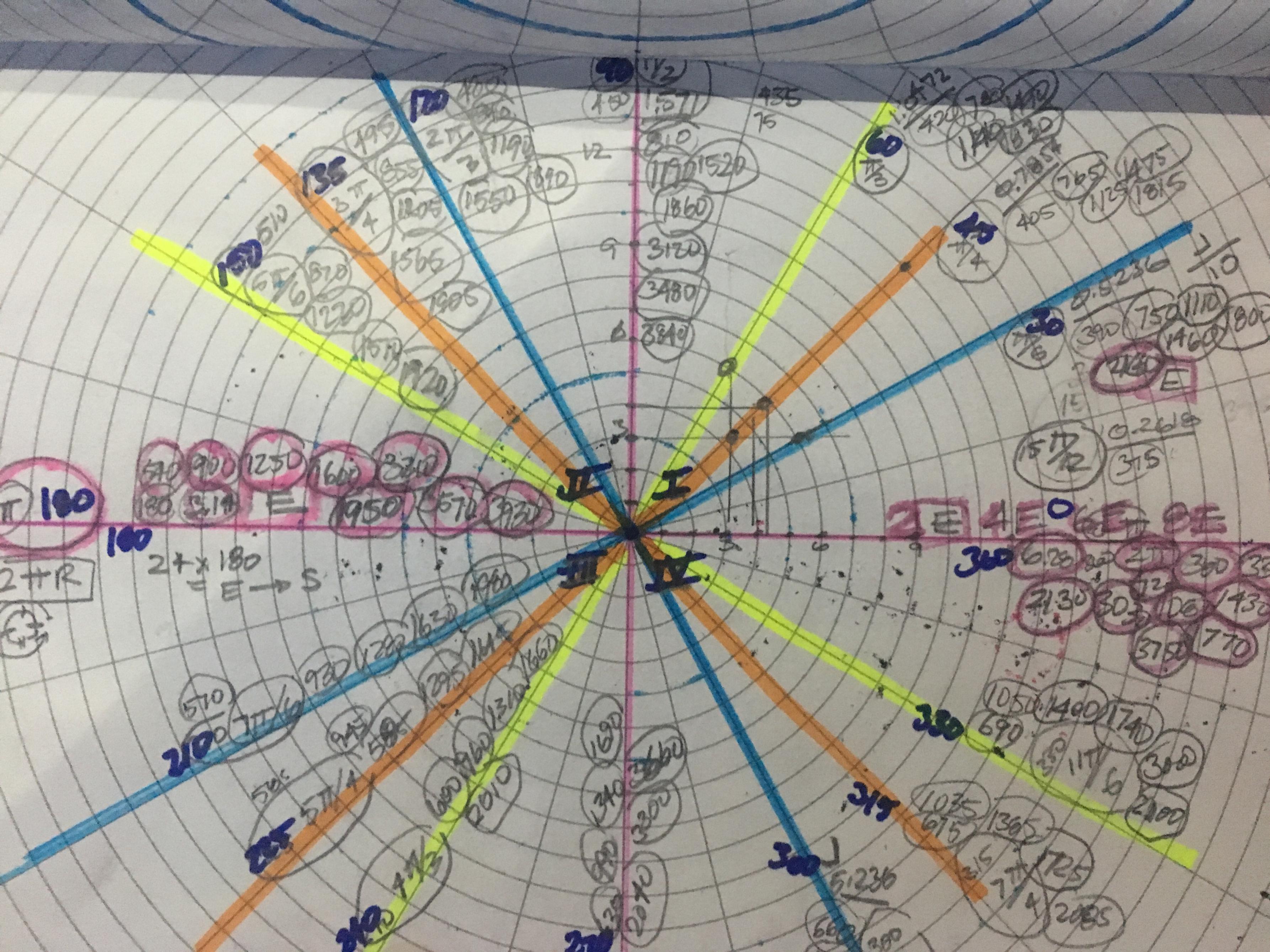

The issue of cancel isnt random as suggested? Inthink its part of that compression ratiio, but theres a length too. And it can be width or long. And both is when we ‘see’ it doesnt matter much anymore? Fingers crossed
