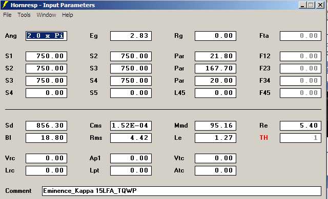

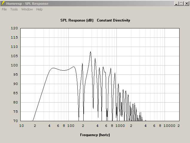

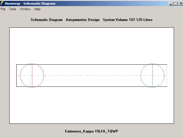

Hi screamersusa,
Bjorno came up with a TQWP for the 3015 a while back, I'll attach something similar for the Kappa-15LFA. Just play around with the Hornresp model, and see if you come up with something you like.

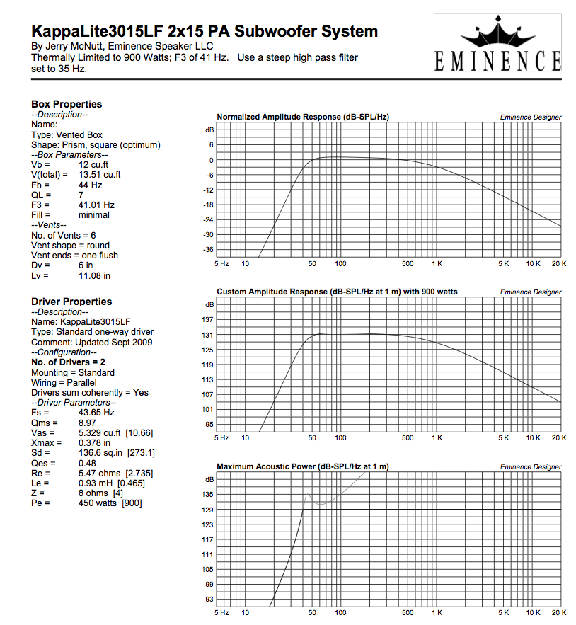

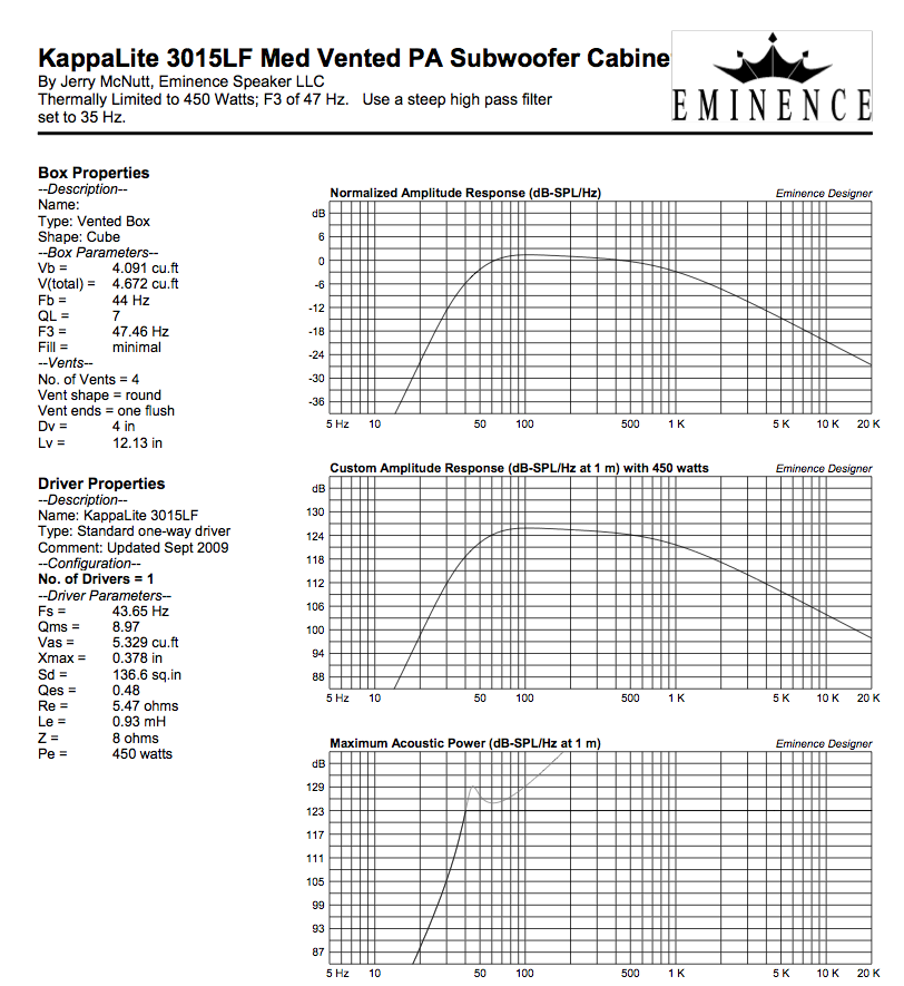

Just take a ported cabinet and point it down.
Since it does not have to be super loud, you could build small, port low and EQ up the bottom if needed.

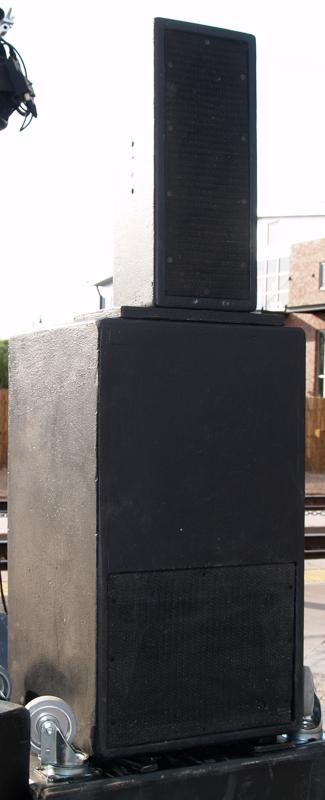

Jim,
Been posting here far too much to have fallen off...
This cute TH uses a Kappa 10, is only 26.5 by 15 x 15 inches, use it for a drum sub with 2 x 5" and tweeter on top.
Four of the cute monitors take up about the same space, a whole system including 4 mains and two DFLH subs fits in a 4'x8' trailer towed by the Mustang.
Art
