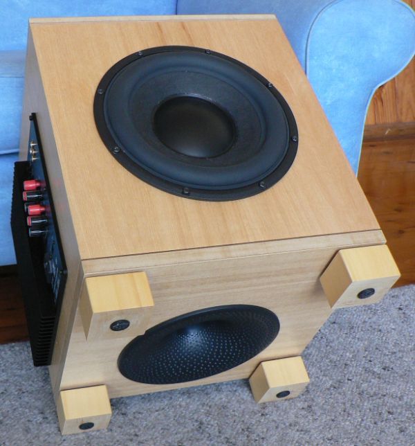

The original enclosure is rated to go down to 27Hz and is in a 2 cubic foot enclosure. It was a compromise between performance, cost and customer acceptance. My calculations show a bigger box / port for a better response (2.5 cubes / 3"D x 8"L).
We have 2 options.
Duplicate the design as is in a new enclosure.
Build the “optimum” enclosure and make it as good as possible.
What do the more experienced people think?

Agreed. The starter is rebuilding a JBL PB12 and wants to know whether he should clone or change slightly. At this point I would suggest change to front firing driver, down firing port.
"I prefer front myself. Down firing, firing at the wall, corner loading, Ports & passive radiators are all attempts to increase the loudness of under sized woofers at the sacrifice of sound quality (Exception to the rule, Klipch Corner Horn, uses the wall to increase horn length). If you want to reproduce a 16Hz pipe organ note size does matter, just take a look at a pipe organ."
Again, agreed. The starter is also trying to decide if he should change the volume of the box along with diver orientation. I would suggest he change to "optimum" size.
So my suggestion to him is:
Front fire
Bottom port
Box made for optimum results.
Keep in mind the calss D amp on the sub broke and he replaced it with a PE amp that will not fit in the same location as the original. That is what started the whole box re-engineer process. Now if your going to do a lot of work, you might as well do it RIGHT.
My calculations suggested 2.5 cubes with 3" diameter port 8" long. Tuning of 24 Hz.
Can I get a second opinion on that?

3 inch diameter is too small for a 12 inch driver with anything more than paltry xmax in my opinion.
I agree Troy, Sense he has all the specs then the modeling software should give very good predictions of the outcome so pick your favorite poison and built it. Personally I much prefer seal box front fire woofers. Just call me

I saw Tee-Bruce's sub enclosure today. Very well constructed and although not perfect it is still light years ahead of the original factory enclosure.
He should be getting some pictures soon. Thing to note is the dampening "wool" that was rubber cemented to all the internal walls. He will be using poly-fill but he had a really neat 3/4 - 1 inch padding that starts out very dense and gradually thins out. I think he used a "rubbery" type of glue so it stays compliant.
He bought 2 of the flared ports from Parts Express so we can experiment with one then when we have it "right" set up the other permanently.
