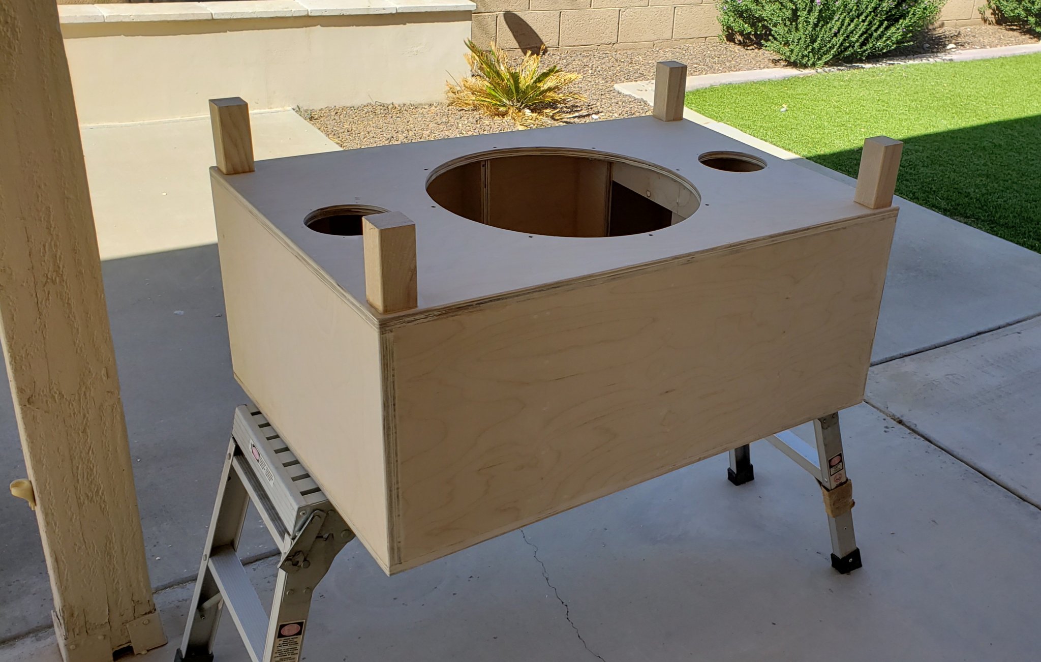

Has anyone ever dealt with the issue of minimum floor clearance on a downwards firing subwoofer? I'm building a pair of low profile subs for a local church - most of the seniors there hate the look of any visible speakers (LOL) so I'm trying to help them out with a compromise. The design is just a simple ported enclosure with a downwards facing 18" driver and ports. I was planning on having 3.5 inches of clearance from driver face to the carpeted concrete floor. Is this sufficient clearance to not affect performance at higher SPL?
The performance won't change at higher SPL any more than it would front or rear firing, but there will be a cavity resonance associated with the enclosed area, as well as Fb may be slightly lowered depending on the proximity of the ports to the exit.

The drivers used in this project are Lavoce SAF183.03. They have a dual spider setup and fairly large stiff suspension, so I'm not concerned about cone sag too much. It would be a different story with a high compliance single spider driver with a heavy cone.
Placing subs near a wall is not going to work because the only locations available close to a wall have hand rails for the steps leading up to the stage and must remain free of any obstacles. The subs will sit spread across the steps leading up to the stage and the steps span across the entire stage front. Placement behind the stage won't work either due to drum set proximity and potential feedback from kickdrum mic.
There isn't any boundary other than the concrete floor around the subs, so they operate in 2 pi field.

I appreciate the warning about the cone sag and I can see how it will eventually become an issue, but due to the majority of people involved with the decision (too many opinions) and the pressure from leadership not budging with proposed sub placement, I've decided to give this a shot and see what happens with longevity. I opted for a 4 inch floor spacing which should be more than enough to avoid skewing free air tuning or restrict output. I will be keeping a close eye on cone sag and report back about it in some time.
The bass heavy youth will definitely push this setup hard and I doubt any amount of limiting and LF high pass will fully idiot proof the subs from their predicted eventual demise. When it does go south maybe they will learn to not ignore my advice which is similar to what you gave me here. This will obviously be an interim setup until they have the funds to build something bigger ie. tapped horns with several smaller drivers that wont be pushed as close to their limits for desired output levels.
