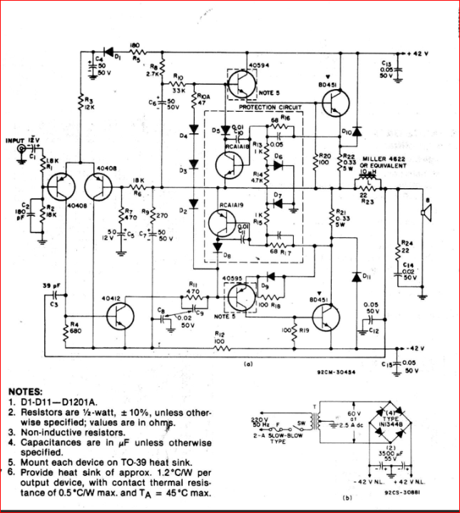

This is the input section of the amps from a Heathkit AR-1500A that I built in 1971 and cleaned up recently.
On the LTSpice attached, the transistor types are as close as I could come to the original Heathkit types.

You have the actual hardware available - this will give a more credible result than a simulation - what are the dc levels on the output terminals and is the value of R13 10k in this.
Taking a few voltage measurements to show drops across components and applying Ohms law is a lot easier than going to the trouble of drawing up simulation.
The simulation looks like an RCA application and I have attached a copy to allow comparisons between the two. One notable difference in the application is the value for R13 of 12k rather than 10k in the simulation.
Looking at the simulation as an exercise in theory, the level of dc at the output is too high. I think this is out of line because of the choice of .models and that you will need to find more accurate ones.
Anyway working with your simulation within the limits of its accuracy, increasing R13 to 12k reduces that a bit and 18k will get the current levels in Q701 and Q702 close to equality.
In the present setting is the consequent reduction of the LTP tail current will erode the slew rate - you can cross the 18k change out.
You can measure voltages at points to work out currents passing through resistors using Ohms law and compare the results with your simulation to see where the differences lie.

Thanks for the reply. Yes, it sure does look like the RCA app. For the sim, I was not able to find models for all Heathkit transistors, so the ones in the sim are not the same as in the real hardware. In addition, the input pair in the sim would be 'matched', while in the real hardware they are not. Despite that, the voltage/current readings on the real hardware are close to the values on the sim. The sim shows an output offset of -222 mV, the real unit had one channel at -130 mV, the other at -90 mV if I remember correctly.
And yes, increasing the 10K to 15K improved the offset, as did changing the 680 to a 470. But I do not have the theory or the test equipment to determine what effect those changes would have on stability, so I left the factory values. Did end up injecting a bit of current into the FB input to reduce the offsets.
I substituted some .models from Bob Cordell's website and the dc offset with R13=10k then=12k the simulation results were -150 m.V. and -97 m.V. There are a couple of departures from the RCA stability set up in the Heathkit amplifier. The impacts of Miller capacitance of C4 etc need considering.

C2/R8 is not a true feedback path. Similar to the way in which C1 acts as a bootstrap for positive excursions of the output, C2/R8 working against R21 act as a bootstrap for the negative excursions.
While the voltage at the emitter of Q703 is modulated by the output signal, the same change is appearing at both ends of R15. Since the collector of Q1 is a current source, and the output of the Q703 is also a current, changes in the emitter voltage of the VAS have no effect on the output of the VAS.
Oh, and the miller cap (Cdom) in the RCA circuit is the 39 pF C3. Equivalent to C4 in the Heathkit.
But none of that explains why the static operating point of the input LTP is so extremely unbalance by design.

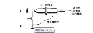

How does the oscilloscope measure SR, is there a specific introduction?
