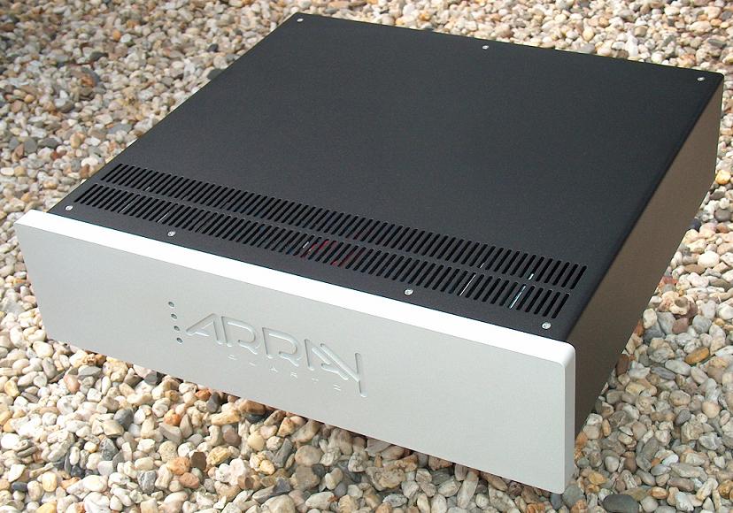

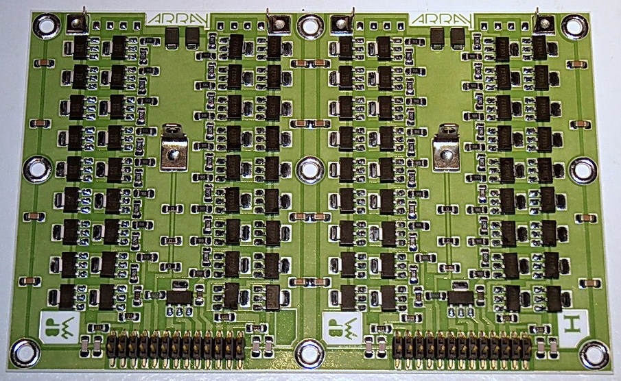

In nomine veni sancte spiritus, i christen it the poor man's Array S-1.
(also has 32 output "devices" per channel)
