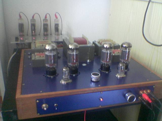

i'll keep them in mind for replacing the py500A's (42v, 300ma heater) when they are worn out....!
got the sockets etc...
(even on this bad picture you can see the 'blackish' residu around the top caps, sorry don't have a close-up)
