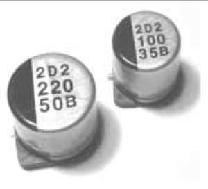

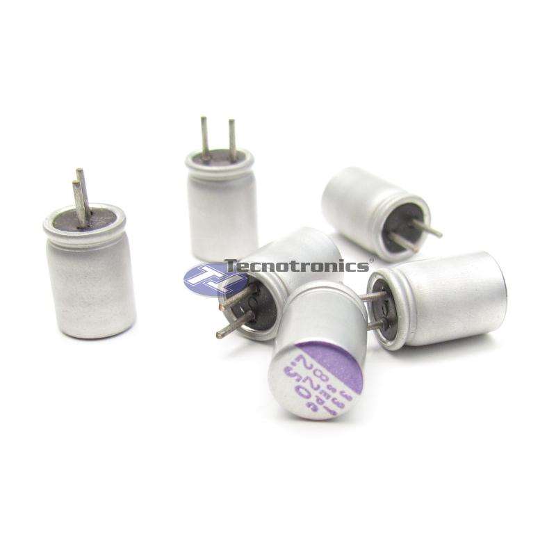

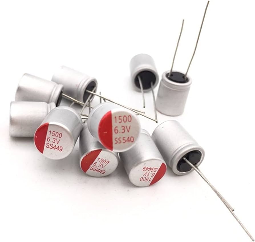

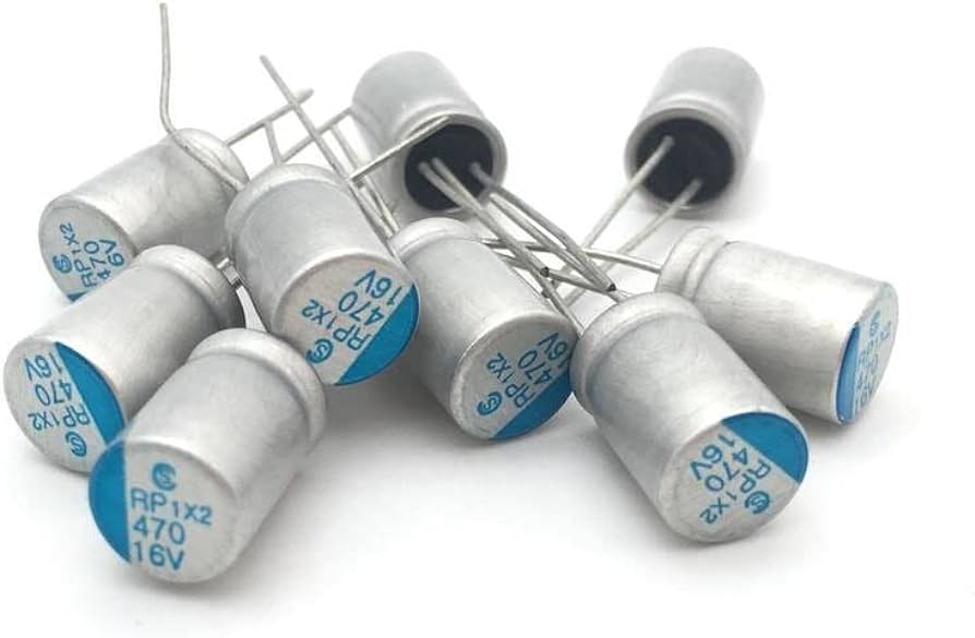

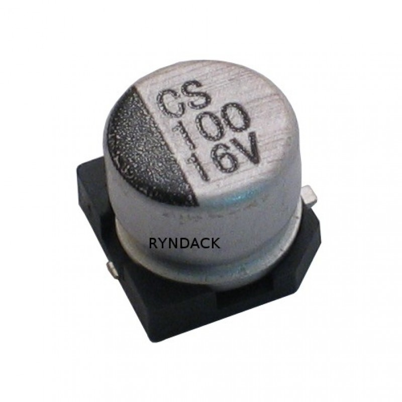

Is turning on electronic devices that use SMD electrolytic capacitors (those with a silver casing) for 20 to 30 minutes enough or not enough to renovate them so as not to have failures due to disuse and store these devices for another 12 months?
I'm confused about the correct type and technology of these capacitors with a silver metallic casing because I've read several names for them: SMD electrolytic capacitor, solid capacitor, polymer capacitor, SMD aluminum electrolytic capacitor, if there are several chemical technologies, how can they differentiate? They come in different colors black gray red blue purple
Which one is used on external notebook HDD case boards?
