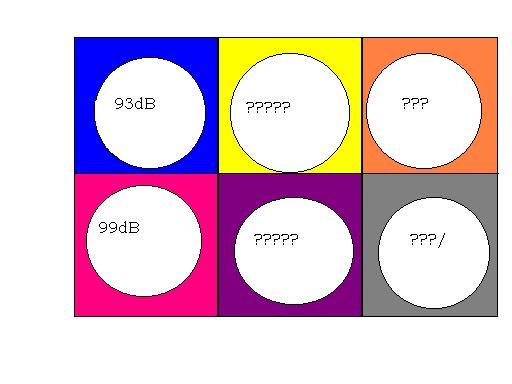

Hello all,
I know if you have 1 driver, say 93Db , powered by its own amp (1 watt), and then add a second powered by its own amp you end up with a 6Db gain. What happens if you continue this as in the attatchment below?

Very well worded Rob. The separate amp gets around that issue.
Every doubling of the number of speaker/amps gives you 6 dB. There is also a small potential gain with mutual coupling (small compared to the rest)

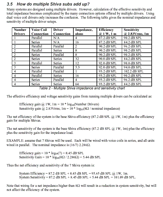

If you look at the Shiva white paper, they have information about using multiple shivas. The paper is at:
http://www.adireaudio.com/Files/ShivaWhitePaper-V2.PDF
Here is a screenshot of the information that I am talking about. This goes from 1 to 4.
Brian
Brian

RobWells said:If I can get a highish (112 - 115 spl) at fairly low watts this would be nice
I did a calculation earlier, and if you are using the shiva subwoofer, it would take 160 shiva subwoofers in a 4 ohm configuration to obtain 120.24 dB...
Brian
