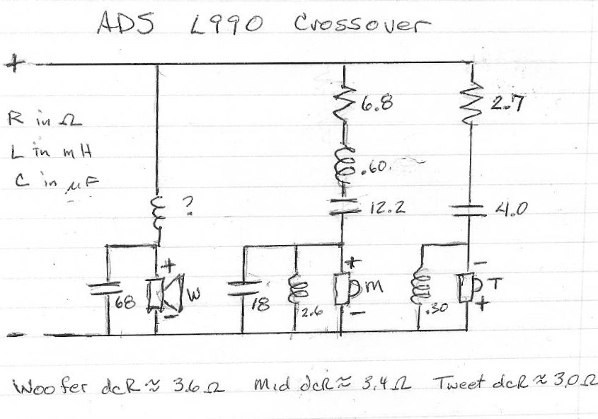

I have a pair of woofer and its crossover networks. I obtained a pair of the same. I’d like to make the dual-woofer system. So, I put a pair of them in a cabinet. Since the driver resistance is low, approx. 3.6 ohms each, I wired them in series connection. The impedance now is about twice of the original, says 7.2 ohms. The original crossover is simply a 2nd order. So thing I have to do is to double the value of an inductor and a capacitor? Is it right? Thank you in advance
What if I half the impedance by placing a resistor with the same value as the driver, says 3.6 ohms, parallel to those series woofers? I know that it will be a heat loss on a parallel resistor but the placement is the nearest to the driver and behind all crossover components. An L-Pad circuit might be the same way. What do you think?

If you supply details of your woofers and crossover networks then I may be able to give you more targeted advice.
I would certainly never use resistors to alter impedance in the way you suggest. The large loss of power and the need for very high power rating resistors to dissipate that power as heat would not be acceptable.
The woofers and crossover networks are from ADS L990 speakers. The woofer DC resistance is 3.6 ohms. Crossover network is 2nd order consisting of a 68 uF capacitor and a 3 mH inductor. Please note that this combination is for a single woofer.
For power rating of resistors, I’ve seen the resistors in midrange and tweeter sections. They are placed at the beginning of the path, series connecting direct to the speaker terminal. They are rated at 7W. I’m not sure if it will work for a parallel placement nearest to the drivers?
To cross over a series pair of your woofers at the same frequency as one requires the following values of C and L:
C = 34µF and L = 6mH
If you have four of the original crossover boards then you can obtain the above values as follows:
Place two 68µF capacitors in series and you have a 34µF capacitor.
Place two 3mH inductors in series and you have a 6mH inductor.
You would then place the 34µF capacitor in parallel with the series woofer combination and the 6mH inductor in series with that combination.
P.S. Whatever you do, do not put resistors in parallel with your woofers to make them look like half the impedance!

As you can see on attached, there are 2.7 and 6.8 ohms resistors on tweeter and midrange circuit for attenuation. They are connected directly to the speaker terminal which also connect to the amplifier. Do the components below them help alleviate the dissipating?

The components below the resistors are the crossover components which provide a low pass filter on the woofer, a band pass filter on the mid and a high pass filter on the tweeter.
Check your drawing. The top of the '18' capacitor in the mid's section should go to the junction of the '.60' and the '12.2' and not to the top of the '2.6'.
