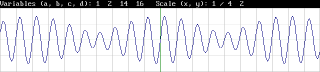

One example of how powerful the human psyche can be on what we hear, and may help you understand the problem here is this effect that happens with two notes very close together. When you have two notes played that are very close to each other, say one is slightly flat to the other, they tend to warble or modulate. The closer to each other they get, the faster that modulation is. Once you have them at the same frequency, it stops, and you simply hear the two tones layer each other. Now, and I might have this detail wrong, as its something I was told in a recording class (Free Elective:D ), that is not actually happening. You could not measure the warble, as nothing is warbling. However, our brains can not process the two discimeral but close notes, and so it creates the warble, its a psycho-acoustic effect. Musicians, my self included, use it to tune instruments as its very accurate. What this tells us is that our brain, universally so, has an effect on the sound, in many cases an effect that we all share collectivly, but can not measure, we can only express it. So the key is to find a way to objectify our subjective experience as much as possible, and that starts with consistency. The other way, and its what reviewers do now, is to simply get to know the reviewer and all of his or her quirks and styles, terms, tastes, biases, etc. Then when they review something, we can remove all of those from the review equation, and what is left is what actually exists for everyone who listens, or as close as you are going to get.
No, the warble is actually there. When you linearly mix two frequencies very close, the amplitude appears to modulate. In fact, AM itself is a carrier with upper and lower sidebands, no suprise the waveform is very similar. The difference is easiest seen at maximum modulation, where the envelope defined by the peak voltage appears as rectified halves of a sinewave.
The following graph was produced with the equation:
f(x) = A * sin(Theta * C) + B * sin(Theta * D)
Where Theta = Pi * (1 + x/2).
Tim
