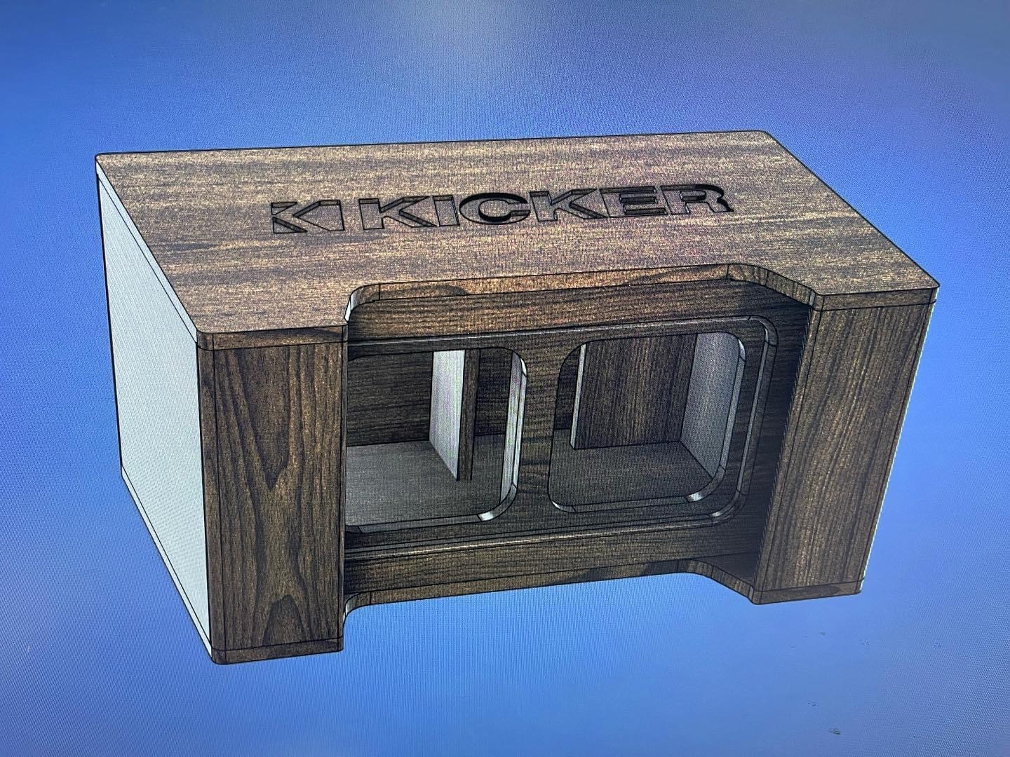

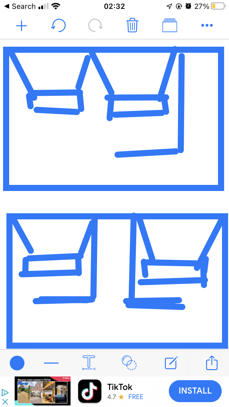

Will the port arrangements in the photo below function the same?
The view is down from above the box. In each case the port is a slot that spans the entire cabinet vertically (it forms a rectangle by butting against the walls).
I was thinking perhaps the short sections in the second picture need to be half the volume of the long section or similar?

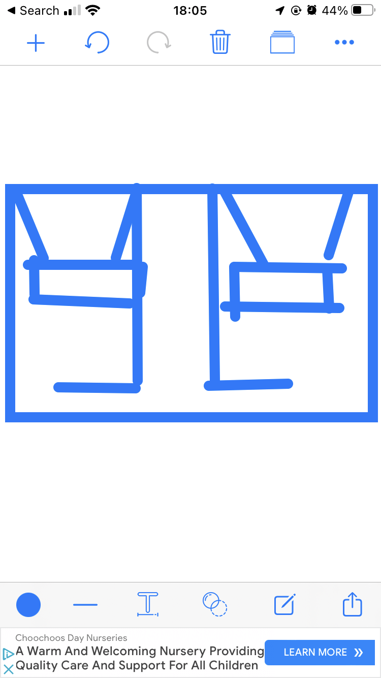

ah, I don’t think I was clear enough in the op.
By function, I meant sound the same.. IE if I make the T shaped port in the second picture, what area should the shorter sections be, now that there are two of them rather than one.
I’ve realised now they must need to be half the area of the long section in order to perform the same as the L shaped port in the first picture.
I know that’s probably obvious to most people on here, I just wanted to double-check I had my thinking right.
