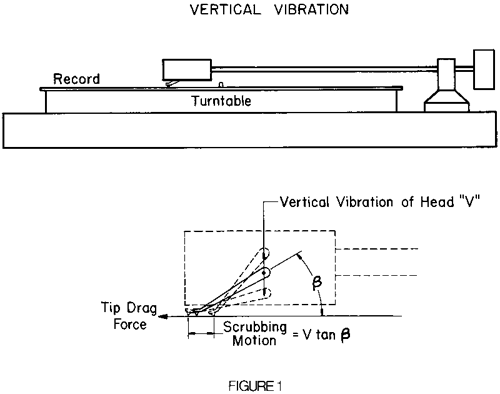

Here is a graphic (from Shure tech notes) which shows how scrubbing that results from vertical resonance is influenced by the Vertical Tracking Angle of a typical cartridge:
[20] Shure Figure 10 Simplified Vertical Scrubbing
Shure’s graphic shows a simplified relationship between vertical motion and scrubbing along the groove and a simple formula that describes it. Here too, the scrubbing motion is asymmetrical WRT headshell/cantilever displacement. For a symmetrical vertical displacement of the headshell, the stylus scrubs more aft than it does forward.

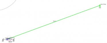

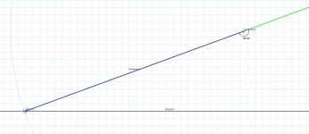

Here’s a Linkage2 model of a typical “Arm 3” and a cartridge with a 20 degree vertical tracking angle:
[21] Arm 3 Linkage2 Model
[22] Arm 3 Linkage2 Cantilever
Here’s a video of the simulated mechanical motion during vertical resonance:
I won’t do a separate analysis for vertical mode resonance and scrubbing because it’s essentially the same concept as the 9” “Arm 1” model for horizontal mode FMD. The vertical tracking angle is in the same ballpark as the offset angle for 9/12” arms and the scrubbing behavior is comparable (see the Linkage2 video animations). Unfortunately, there’s no magic bullet for solving FM caused by vertical mode scrubbing, since you can’t eliminate the VTA built into the cartridge by the manufacturer.

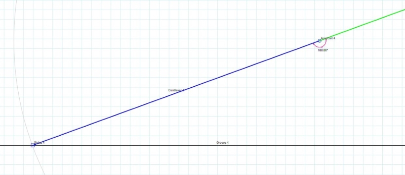

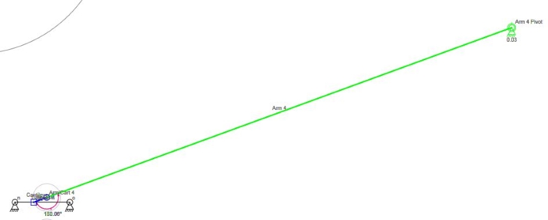

Here’s a Linkage2 model of what I’ll call “Arm 4”, inclined to match a cartridge with a 20 degree vertical tracking angle:
[27] Arm 4 Linkage2 Cantilever
The scrubbing in “Arm 4” is so much less than “Arm 3” that it’s difficult to see in the same scale. Here’s a close-up stylus view of the same video. Notice that in “Arm 4” the scrubbing frequency is once again double that of Fres, as in the case of “Arm 2”.

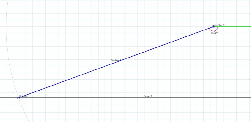

So far, I’ve only looked at horizontal mode scrubbing and FM. I’ll use the same modelling methods for analyzing vertical mode scrubbing and FM. For the vertical mode I will model it generically as “Arm 3”. Zero offset angle geometry has no inherent advantage in terms of vertical mode scrubbing susceptibility.

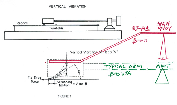

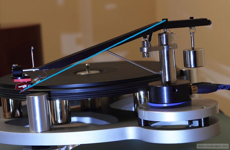

Option 1 - Raise the height of the arm pivot so that the angle of the arm WRT the record surface matches the VTA of the cartridge. This would make the vertical mode scrubbing behave in a way comparable to the horizontal mode scrubbing example of zero offset angle “Arm 2”. The RS Lab “RS-A1” is an example of this. Other not-so-obvious examples of this are the mechanism in the ReVox Bnnn linear trackers, and various mechanical and air bearing Linear Trackers, including diy efforts. I doubt that any of these designs originally had the vertical scrubbing issue in mind as a design concept, and I’ve never seen it mentioned before. The disadvantage is that, while these would be expected to perform well vis-à-vis vertical mode FMD from scrubbing, they become more susceptible to the audible effects of 0.55 Hz warp wow scrubbing. It’s an unavoidable trade-off that is one of those pick-your-poison scenarios.
[25a] RS Lab RS-A1 Simplified Vertical Scrubbing
[25b] RS Lab RS-A1

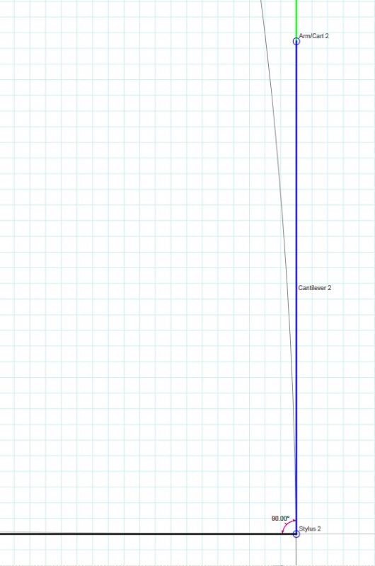

[26] Arm 4 Linkage2 Model
[29] ARM 4 – Linkage Stylus View
Sorry, I don’t have one of these arms to demonstrate a sound clip.
