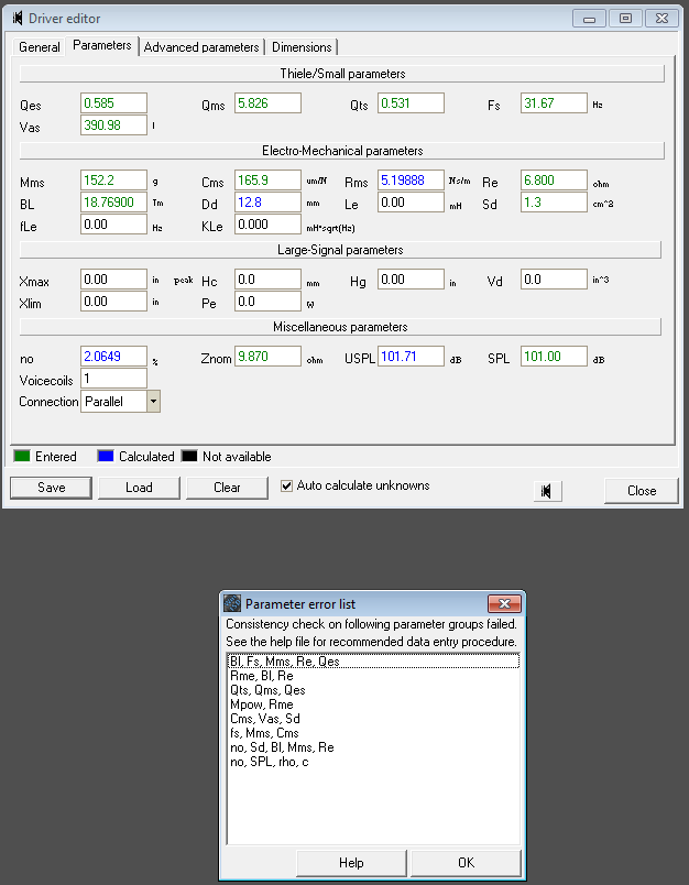

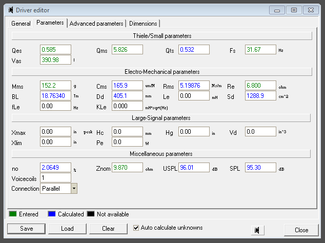

But uhh its failing when I go to go forward with this, I've included a picture.
Seems the issue was with the BL, QTS and SPL.
I put things in, in the order you told me to and BAM it worked.
So I tried filling in the extra things one by one to see what extra information I could add in and I got this far...
Still missing some things tho that I assume would help with the driver but hey at least I can save it now!

Let the program calculate the values, because you have that box checked in the parameter window. See for yourself, first enter Qes and Qms. Then click some other empty field and it should calculate the correct Qts for you, the calculated number comes in blue color. The calculated and inputted value only needs to be off by one decimal and you get that error, that's why it's best to let the program calculate those. Of course it's wise to check the values afterwards.

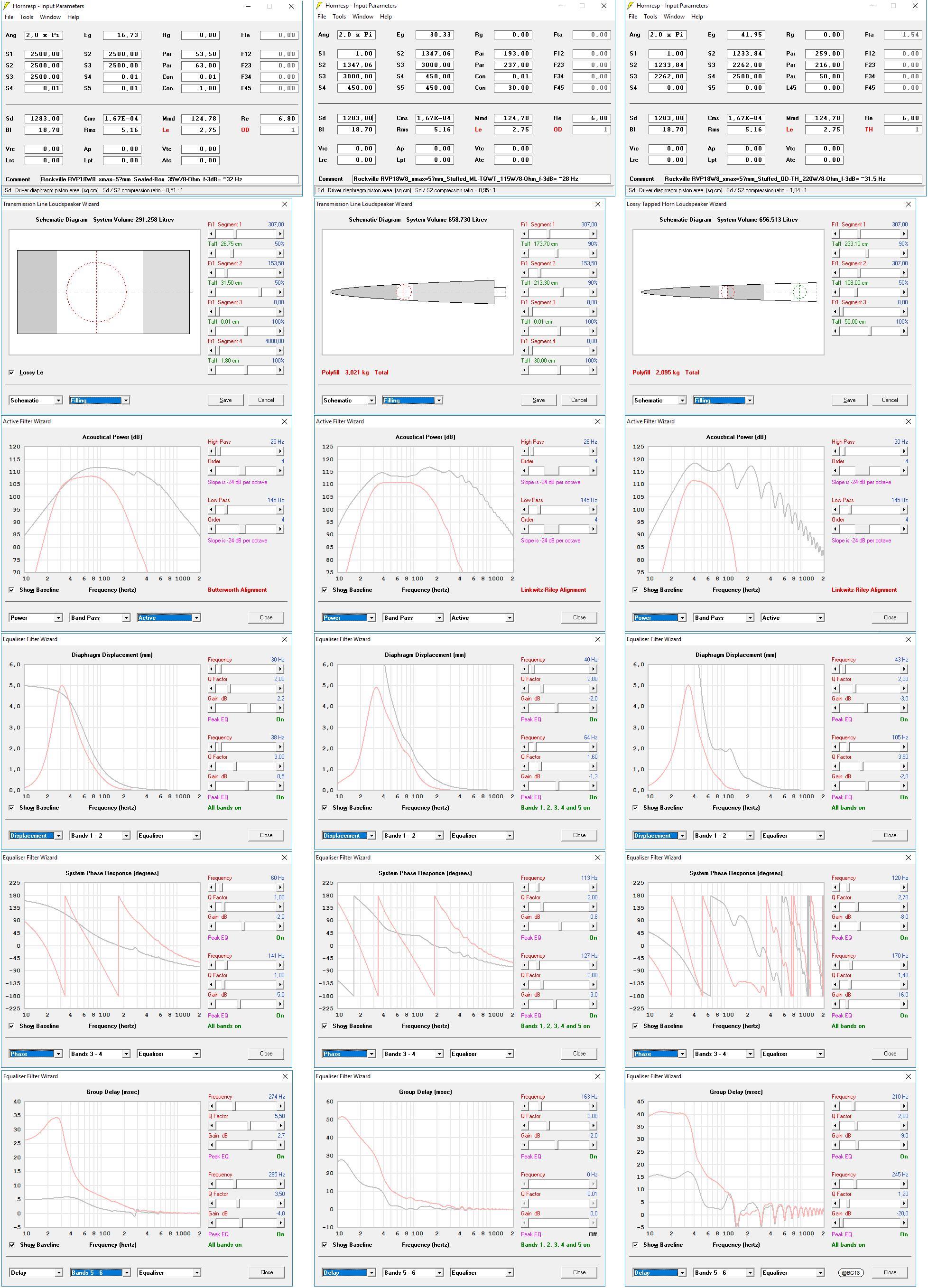

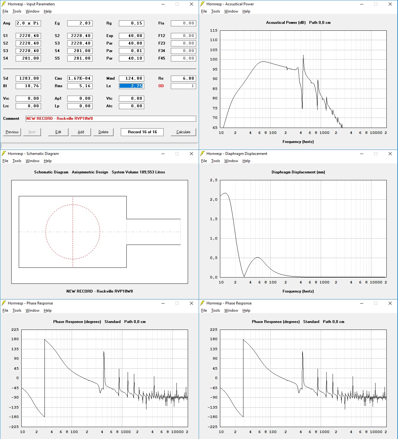

Hi All,
Checked this Driver squeezed into Boxes using HR Plots + where a PEQ were essential to achieve any SQ. i.e. a Box for Music listening.
b🙂

Looking at your charts tho I like the results your getting with the 2nd option. Thats BR box B? That seems to be around what I'm looking at and trying to get on winisd atm. Also is that with one driver or two?
Mello:
That was a box with almost 660 liters internal volume, I think he was just demonstrating the fact that these things like big boxes.
Here is a slightly more "compact" thing with ca 190 liters internal volume.
Do note that since they are more compact, it is difficult to get away from that "party hump", but it could work really nice in a PA setup where one often would boost those frequencies anyway. It does have output to 30hz, which is port resonance, but not a whole lot below 40hz really. Pending on your setup it can work without eq, just filters, depends on implementation.
It will sound "impressive" but not 100% optimal for accurate sound reproduction
To keep it short: Hornresp is better than winisd, but a little bit more complicated, the box numbers are mostly just area/distances/volume, most of it is very basic math, so once you get your brain around, it really is very simple to play around with. If you play around with it you should learn how to use it very fast.

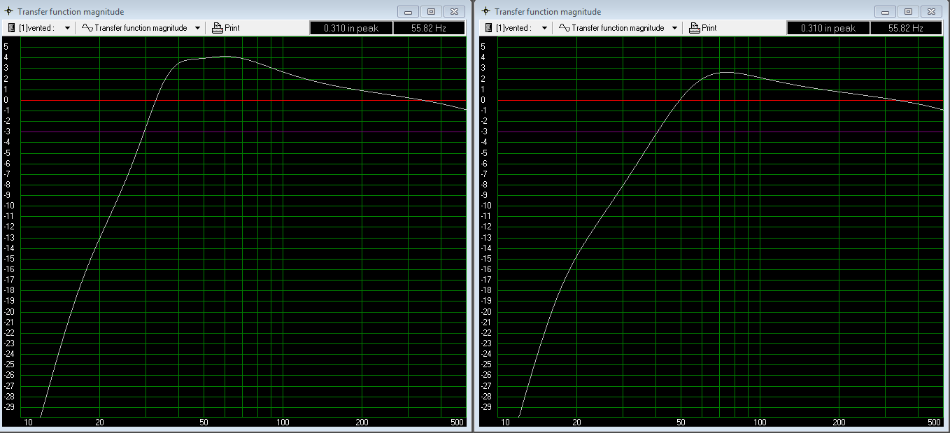

I mean just quickly tossing the drivers into winisd on a ported cab without pEQ looks okay on the max spl tab.
I'm getting
118db at 30hz
123db at 40hz
126db at 50hz
128db at 60hz to 106hz
0.310 peak cone excursion at 55hz
I'm getting this without pEQ with the following settings:
2x drivers
380L volume
30hz tune freq
1x square vent 3x20 inch, 7.96 deep, two free ends.
system input power 600w
distance 20foot

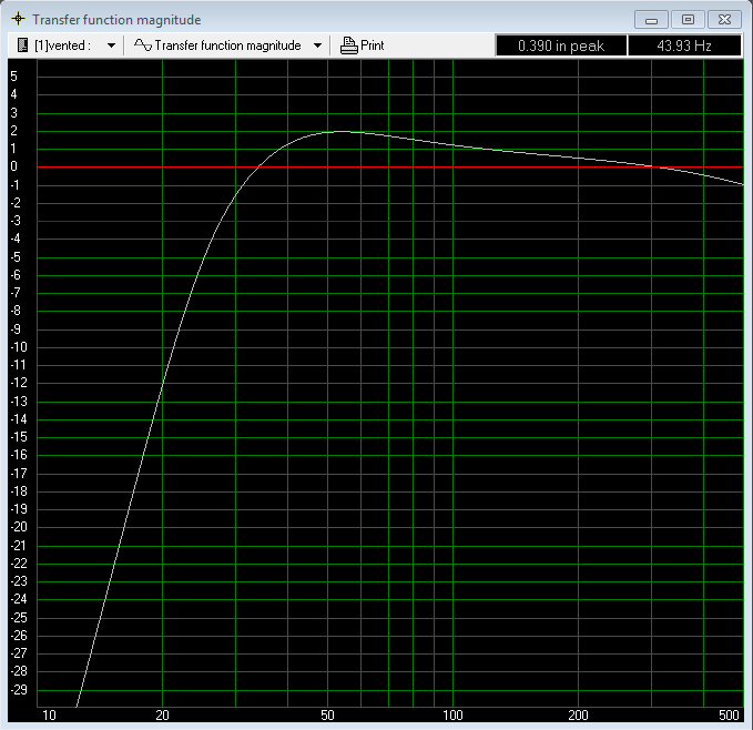

Now same box with pEQ added:
121db at 30hz
125db at 40hz
129db at 50hz
131db at 60hz to 108hz
0.499 peak cone excursion at 43hz
I've included a picture of the transfer function magnitude from winisd with and without the pEQ added.
From what my uneducated eyes can tell, even this quick, rough job of adding some pEQ flattens out the TFM chart... that seems to also tighten up the db differences between the hz bands I plan to use.
From what I can tell, the limits of this is the peak cone excursion that is heavily effected by pEQ. Problem is I'm not seeing the xmax in their specs and winisd didn't auto fill in the xmax when I put the specs in, I assume its 0.5 from what I can tell so thats what I've tried to stay under.
This is more or less the idea I'm going for, would love some input or corrections.
