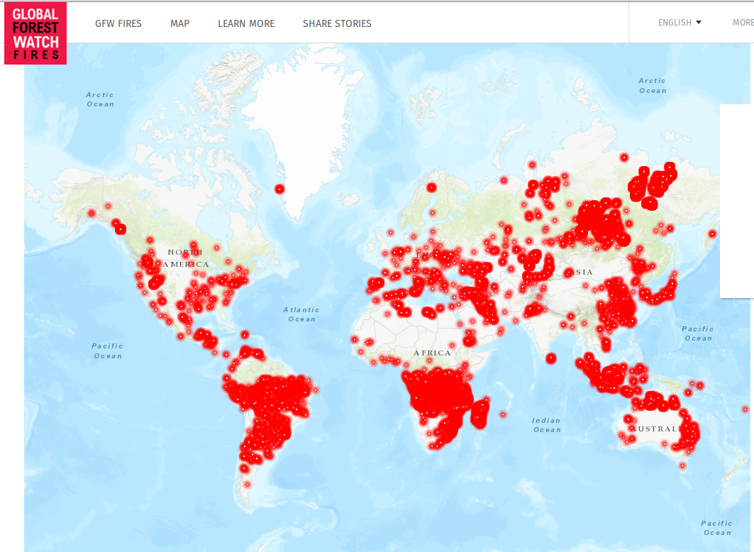

As I write this, France is baking in a record-breaking heat wave that saw nearly temperatures of nearly 43 C in Paris: https://www.cbc.ca/news/world/heatwave-paris-uk-london-netherlands-europe-1.5224555
And Russia is still on fire too, in a repeat of events from 2003, also triggered by extreme heat: Siberia's wildfires 'getting bigger' despite Russian airforce intervention, Greenpeace warns | Euronews
A research study in 2015 found the maximum survivable temperature for human beings was 35 degrees Celsius wet bulb thermometer temperature; this is equivalent to 100% humidity and 35 degrees C, or, say, 50% humidity and 46 degrees C.
A wet-bulb thermometer has the business end wrapped in wet fabric - in dry air evaporation cools it down to below air temperature, in exactly the same way we humans and all mammals use sweat to cool ourselves. Our cooling mechanism fails at 100% humidity, and it turns out that if the temperature is 35 C at the same time, we die in quite a short time, unless we can find some external source of cooling (cold water, air conditioning, luxuries unavailable to hundreds of millions of people in poor tropical parts of planet earth.)
History has demonstrated many times that homo sapiens have a hard time thinking years ahead, and restraint is hardly a key attribute of our species. So I expect we will continue to burn as much fossil fuel as we can manage to extract, by any means possible, for as long as it is possible.
I don't know how to play the fiddle, so I'm off to play my guitar while Russia burns. And France. And the Arctic ( 'Unprecedented': more than 100 Arctic wildfires burn in worst ever season | World news | The Guardian ). And a good chunk of the rest of the planet ( GFW Fires )
