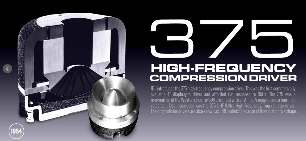

Not to get into the details of patent law, but ring radiators have been on the market continuously since JBL introduced the 075 "Bullet" tweeter in 1954, 65 years ago!Eminence jumped the gun on the expiration of the ring radiator patent (which, oddly enough, is owned by Cerwin Vega not BMS.)
Based on the timelines and the fact that Eminence was first to market with an unlicensed ring radiator compression driver, it definitely makes me wonder if they're just putting their name on a Chinese clone. But that's pure speculation on my part.
The B&C and Faital offerings are clearly an original design.
There were loads of manufacturers making them prior to CV, BMS, Eminence, Faital, and B&C.
I understood that BMS had a patent on a certain manufacturing process which allowed them to make non-metal ring radiator diaphragms quickly, cheaply and precisely.
I never thought they had a patent on ring radiators as such but then I had a pair of 075 on my first speakers. 🙂
Here's what I can see, from a cursory look at Google:
1) US6320970B1 is The Big Kahuna. This is the ring radiator compression driver patent. This is the patent that prevented anyone from selling a ring radiator compression driver, without a license. BMS must have had a license, because this isn't their patent, it's Cerwin Vega's.
2) JBL must have liked this patent a lot, because they hired the inventor and he's patented a whole bunch of ring radiator tech for Harman. For instance, the dual diaphragm ring radiator: US20110085692A1
3) Eugene Czerwinski passed away, and his ring radiator patent expired when the fees weren't paid. And that opened the flood gates from Faital and B&C. Eminence jumped the gun; their ring radiator came out while the patent was still active.
I am no lawyer, but from what I can see, Czerwinski simply patented something that no one else had bothered to patent. For instance, Yamaha had a patent on ring radiators that preceded Czerwinski's patent by THIRTY years, but Yamaha's patent only covered dual voice coil ring radiators:
https://patentimages.storage.googleapis.com/b4/94/57/47b0ebfed19ca0/US3665124.pdf
Yes and if you look at a 2405/2403/2404/2402 and a 2408 the only difference is the 2408 is a polymer as opposed to aluminum. The diaphragm shape and position of the voice coil are the same.
