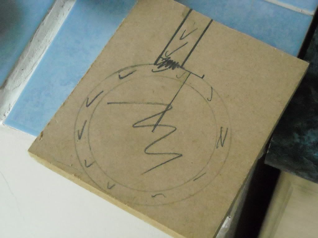

Day One build. This will hopefully show construction much more easily than describing.
One Blanda 20cm Bowl and some very usefull brackets I found lying around which are screwed and glued in place. The circle was cut out by hand with a jigsaw by me, so is very round 😀. Non of these laser cutters needed here.
Next was testing so see that it fitted when screwed on and a little sanding ajustment as the screws pulls the circle over a little. There will be some sort of gasket betwen bowl and mdf to mae a better seal.

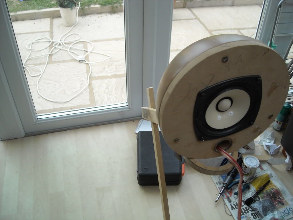

Inserting the port, with another great find around the house being this thick card tube I found(budgets you see).
Day One completes with a quick test. To the right is a half built Fonken I will test them against hopefully when both are built.

Interesting project. Are those Fostex drivers? It's a pity the build photos don't go any bigger, I can't see much detail.

Yes Fostex Fe103e. Sorry about the pictures. I'll try and change them. I realisied why there small, as I only copied the link from the smaller photobucket album section and not the one from the single puicture view like the first post pictures.

These should sound good with a subwoofer, good drivers and no parallel surfaces inside the enclosure are plus points. A driver centered on a round baffle gives rise to a peaky baffle step response, placement near a wall may balance it out a little though.

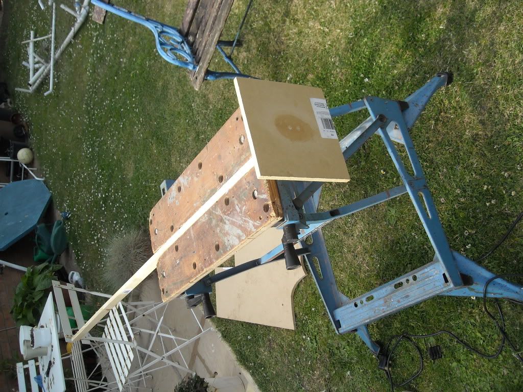

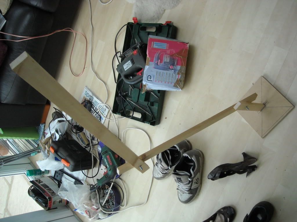

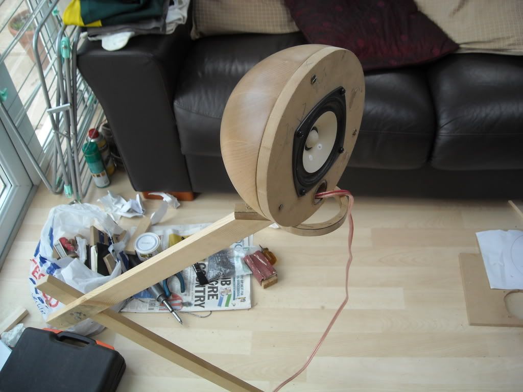

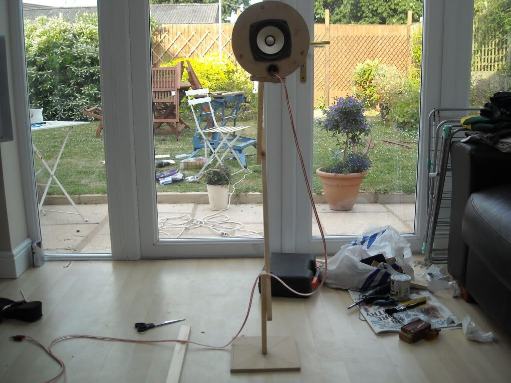

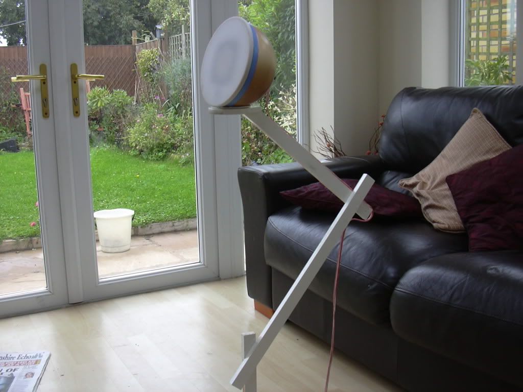

Just a quick update. The stands have been started as shown in the photos. Bit of pine, but the base may end up being made from steel or a metal plate, but that will be worked out when done and if they don't work. They are/will be fully movable, but with a change of plan as the butterfly didnt hold them securley enough. Therefore they will pivot around the bolt and a series of holes will be drilled around the pivot areas and a thin pin will be inserted in any of thew holes through both parts of the wood at the pivot section in the desired postion. Slightly complicated but once done pretty simple.
Shown blow is the actual holder to be cut out in the "P" shape and will also be attached to the top using the pivot system and the ring will be used for the speaker to be sit in.

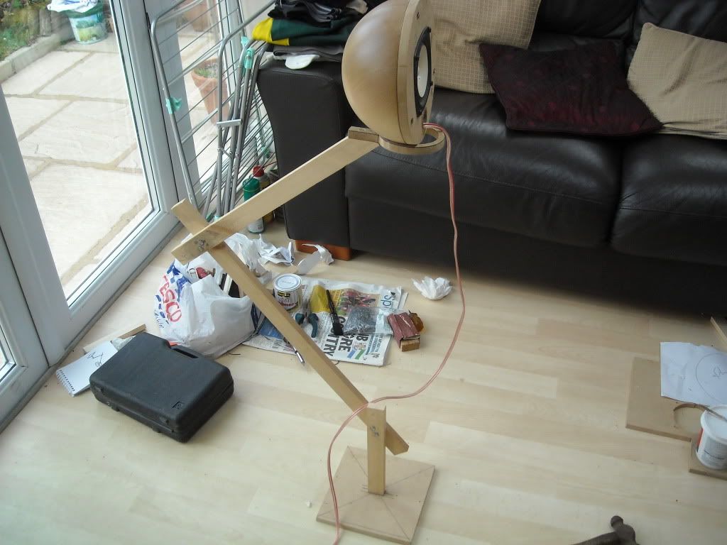

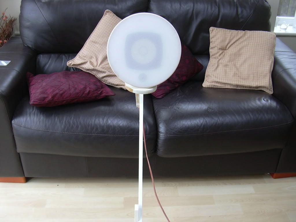

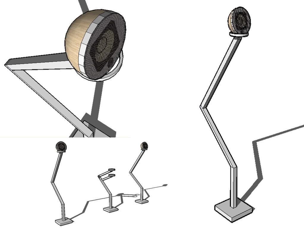

Just a quick update of how things will look when finished with stands. The stands will be sorted (ie holes filled form the many experiments and problems) and then primed and hopefully with a bit of sun to help get a good finish. While there drying the speaker grille rings(MDF) will be cut in hope of the speaker fabric(white-no black here-pure silver, white, light wood minimalism ) arriving on Monday and then can be ‘faffed’ around with to get them fitted/ finished to a high standard onto the MDF rings. I can hear the help of my Mum coming in here. Plus I’m hoping the circular MDF speaker holders that the speakers actually sit in will hold as I'm worried about the twist that I can sometimes see. But they are perfect as they allow the speakers to be directed in any way whatever. Up, right, left and down. Shame that the stands won't be movable, as my many experiments that I conducted didn't work as planned, due to mainly the softness of the pine. However experiment number 5,403 speaker stands will be built another time in the future, which will be hopefully fully movable and fully positionable.

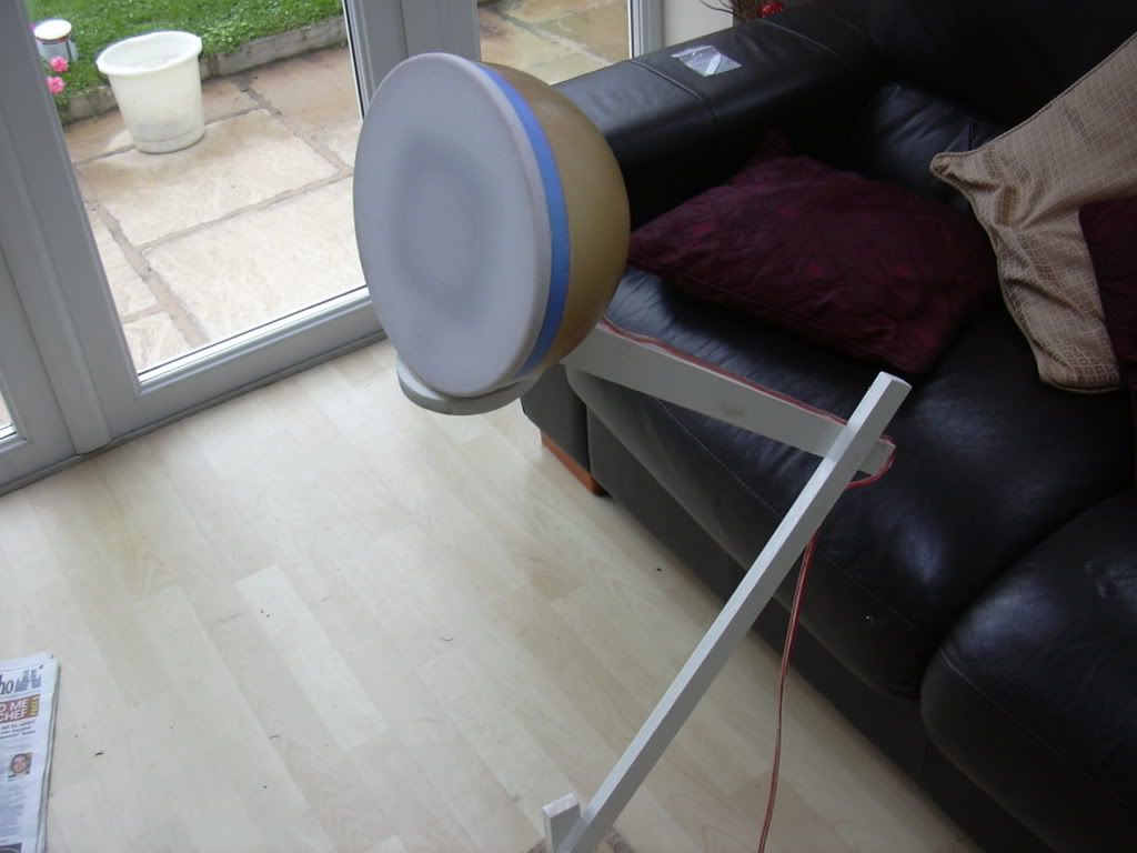

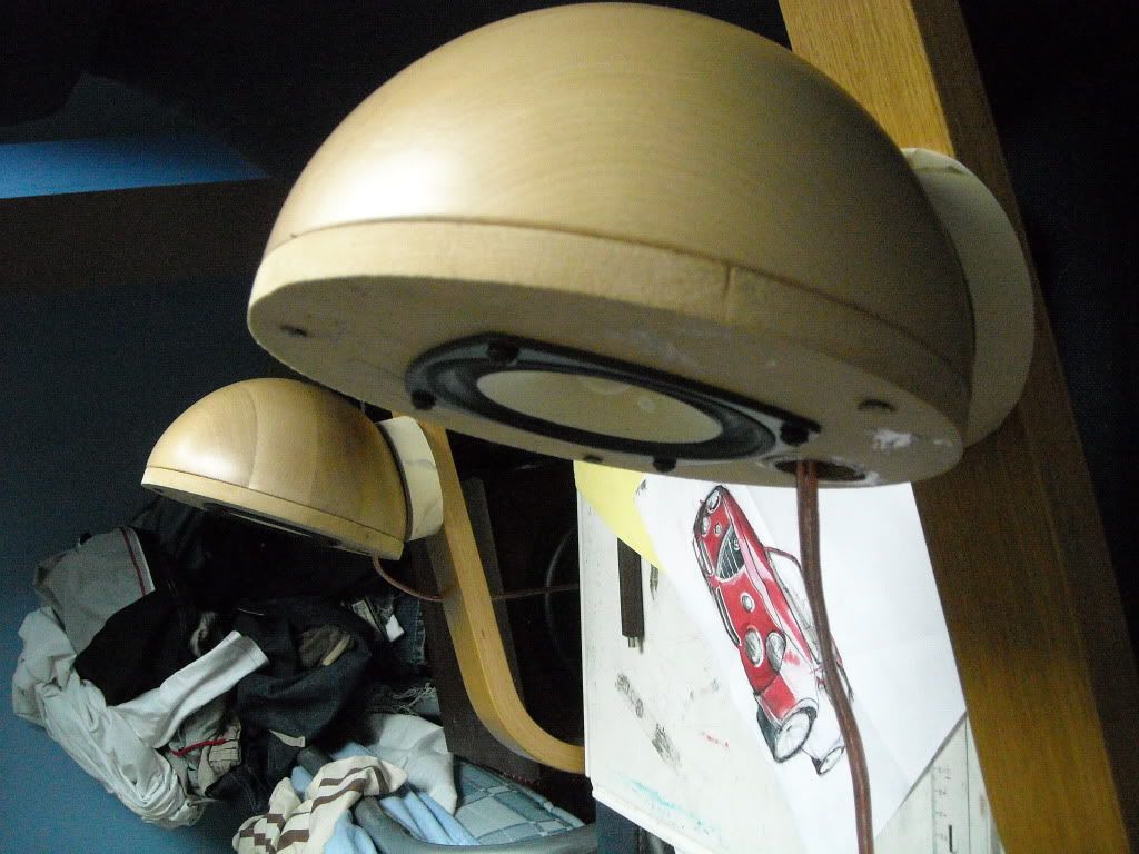

A update, been a while, but here it is. They’re not quite finished as you can tell, as the stands are only prototypes to test the stability and balance.

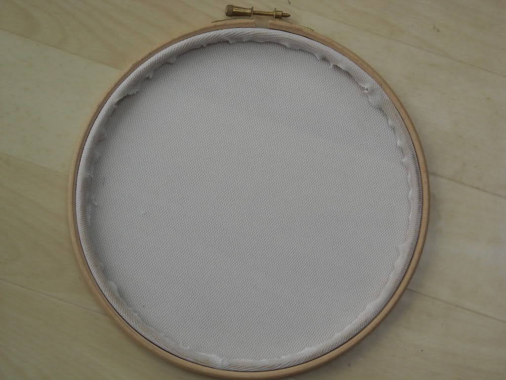

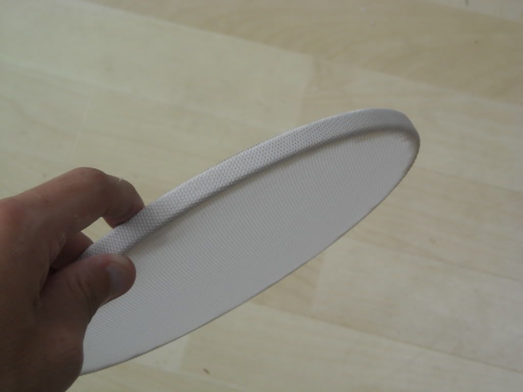

The grilles are pretty much done, they just need mounting posts/ attachments working out and fixing to them. If anyone is interested in how I made them, I used a Tapestry ring and placed the speaker cloth in them as per normal, but then using fabric glue, I glued the cloth to the inside and trimmed off the excess. Then removing the stretcher bar (which helped keep the edges stretched and perfectly smooth) I was left with a perfectly circular speaker grille, although a tiny little bit too big for the bowls, but the best I can do.
HELP HERE PLEASE: The sound however is as predicted lacking base and as they will be used in a uni room I'm trying not to have to lug a Subwoofer there, so need some advice. After comparing them to some mFonkens I quickly built they could do with going down a few Hz (well more like maybe 20hz). Then they would be fine.
If I were to get some stuffing and experiment could I squeeze a little bit of extra base and remove the slightly airy sound?

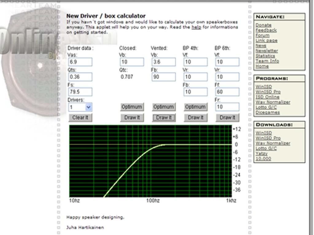

Or what I have thought about is, as I'm on limited budgets is getting some 4" woofers and some tweeters from Maplin (http://www.maplin.co.uk/Module.aspx?ModuleNo=44693 and http://www.maplin.co.uk/Module.aspx?ModuleNo=44697). A quick honest answer please, as some sims at least tell they would go much lower, but would they have any quality to them in the real sound department? Has anybody used similar cheap drivers? As these would be put in the domes (the tweeter or maybe a much smaller tweeter would be mounted on top) and transfer the Fe103e's to some Frugalhorns I've wanted to build and keep them at home. Simply would I be wasted my money?

Hi, I like your design concept, but although not an expert, I would think you are loosing some of the base due to then nature of the stands. The flex will mean for larger driver excursions the whole thing will move and counteract the cones movement.

Yes I do understand what you are saying and that could be robbing me of some Hz's, as there not mighty sand ladden granite stands. However it is proably much more to with my tiny drivers (although with a sub it does sound pretty good) and a small enclosure as I didn't have the money to get the bigger bowls, however also with some sims I believe they would have been 'drowned' (no expert either) and it would have made no difference.
I would go out tomorro and buy them Maplin drivers, as with some sims using their dodgy figures(a vas of 1.098um^2?, so I have presumed that meant 1.098m^3. Correct if wrong , but that measurement should be in ^3 not^2) they would go much lower, but with at what cost to the more important issues of quality and detail, plus SPL. Just don't want to waste my money, as I really do need it at the moment for more important stuff.
