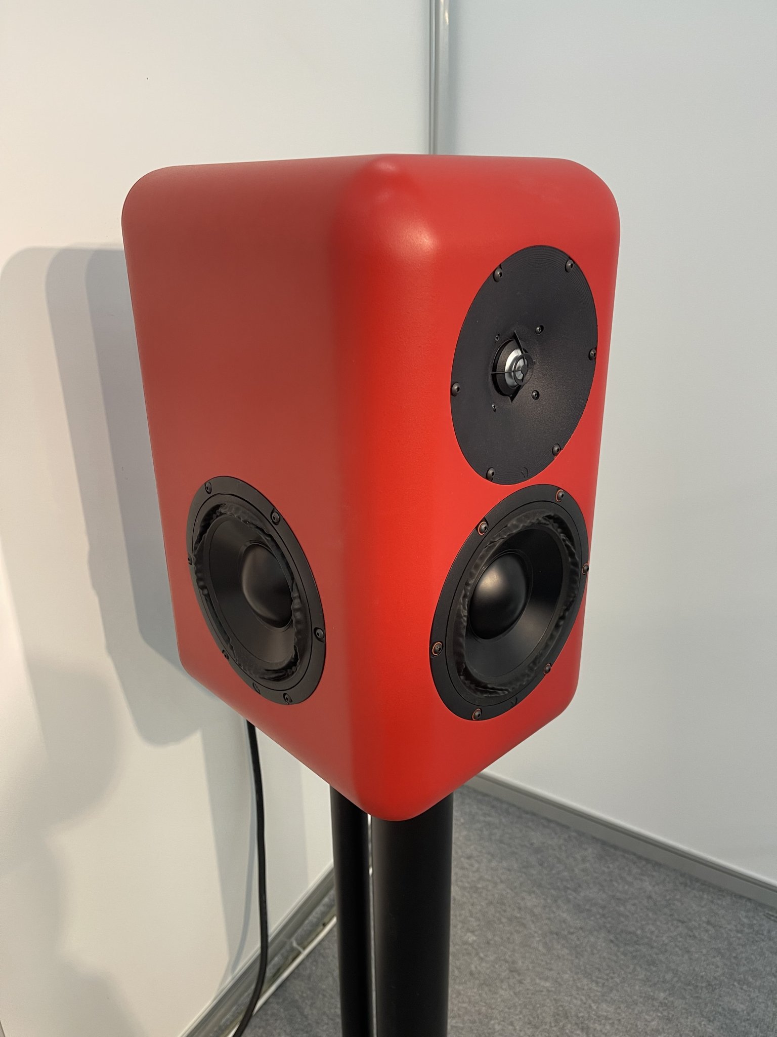

Here is picture of the new Purifi done made from aluminium, as far as I know they have done significant research on the dome material. Sounded pretty fantastic IMHO.
