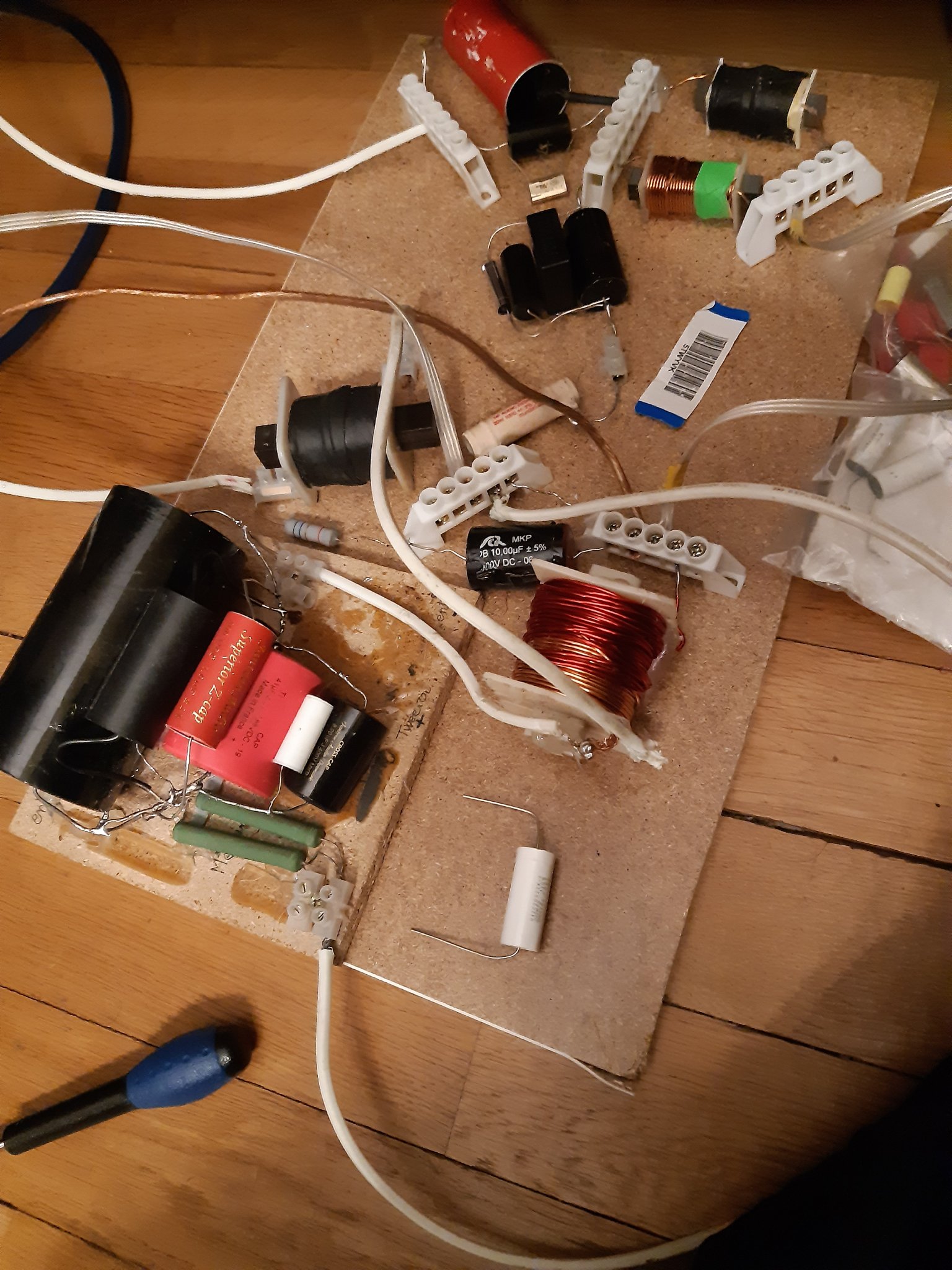

Wonder if a wave guide for a tweeter in a passive filter does supress the advantage of the fine detaiks given by a hard dome ? Due to the extra passive filter parts to lift the post 5k to 10k pitfall ?
SB26 cdc in augerpro 5" WG is planned but also the smoother fabric Morel CAT378 which needs perhaps less parts in the filter.
Reactions: profiguy
I really find those caps coloring it all

What effect is it?
I think back to the time when I thought second order filters were more damaging than first order. I learned that with a higher number of components it's easier to make a second order mistake.. and first order mistakes are much less offensive (perhaps even less resonant).
Reactions: profiguy
When a second order filter is correctly built, you won't have any 'resonant peak'. There is also another benefit
of second order (without resistor attenuation) and that is the parallel inductor across the tweeter provides
natural electrical damping. This situation doesn't happen with a simple series capacitor - first order.
So, the best situation is to have a tweeter of exactly matching output level of the mid. or woofer,
using a second order filter. I have always found second order filters to be quite 'musical'.
Also, as we know, you also have less lower frequencies stressing the tweeter.

I believe (have to do measurements) I need a >=90 dB tweeter <=91 dB (2.8V). I found also some resistors to be intrusive in serie - can be good or a pain according what they add beyond their needed resitance. But that's a detail vis à vis of the rigth electrical values of the filter. Let's say last details of voicing when all is rigth already. Can eat some details with the basic ceramic resistors as well, which sometimes can be good I found when the trebles are too much detailled vis à vis of the mid.
You talk about electrical, but what about acoustical in the end ? I understand it as you cut off always highs (> 3 k hz ?) to be in a linear area of the tweeter to have your electrical order equal to the acoustica lorder. Rigth ?
I would like to staying second order on the tweeter side, at least avoiding forth electrical order because of the more cap. I do not mind yet at the end of the acoustical order cause I think I never tired, so heard yet, the difference between a second order (say acoustical for the discuss) and a fourth order. But sure if the tweeter I choose is strong enough, I try it according what are saying the sims and off axis measurements at sweet spot.
If it's rolling off 2nd order within the transition band, then you have 6th order. Not that there's anything wrong with that, if used well, same as anything else. Everything's a compromise in design terms, we just select according to specific objectives we have for a given set of design requirements based on the best data available. Assuming we avoid the voodoo magic, obviously. 😉
