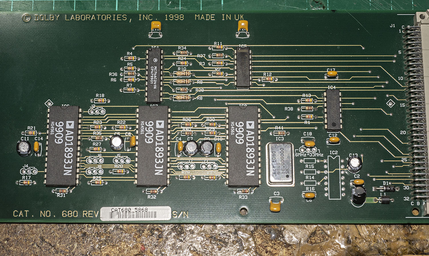

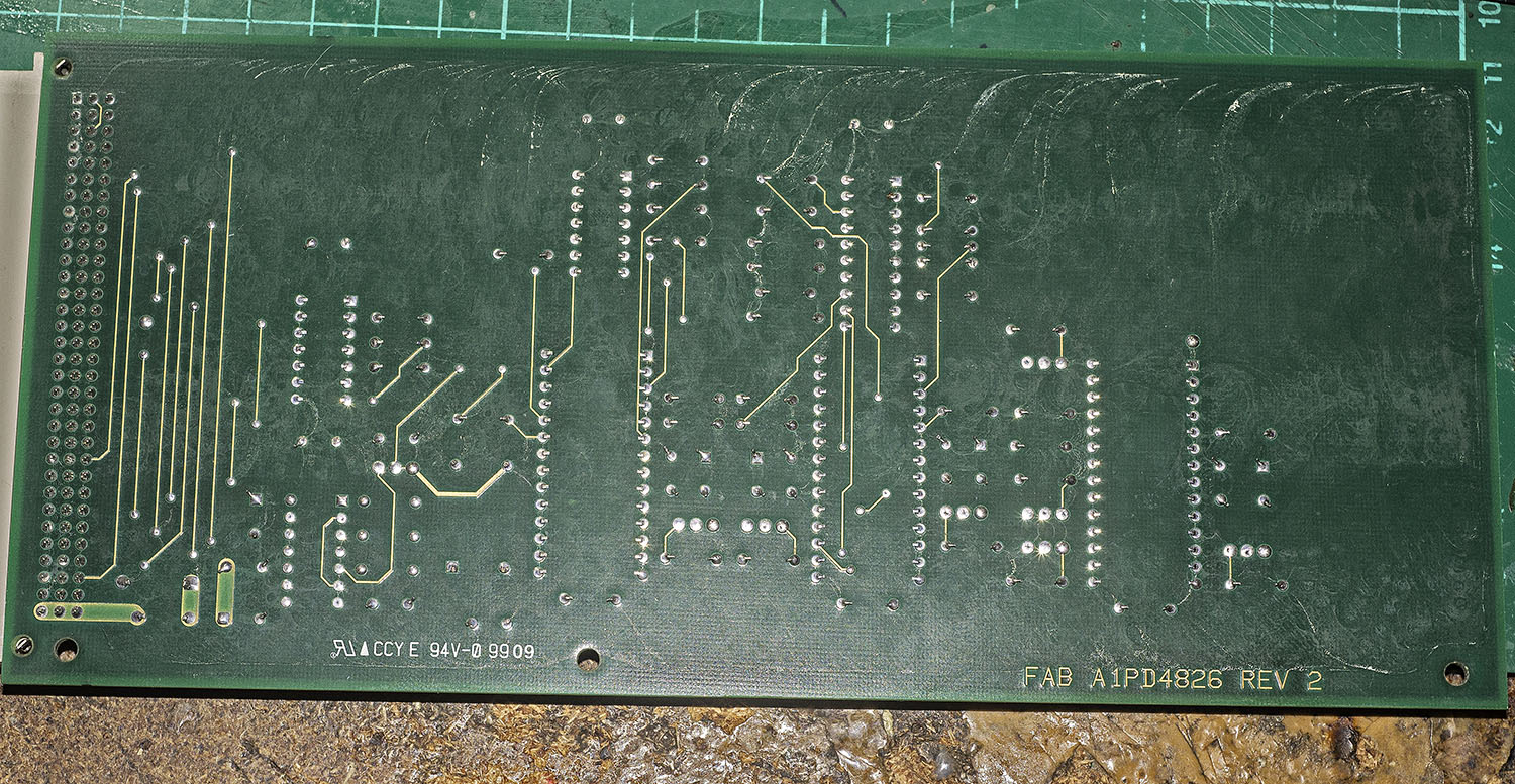

Here's some better quality pics of the board:

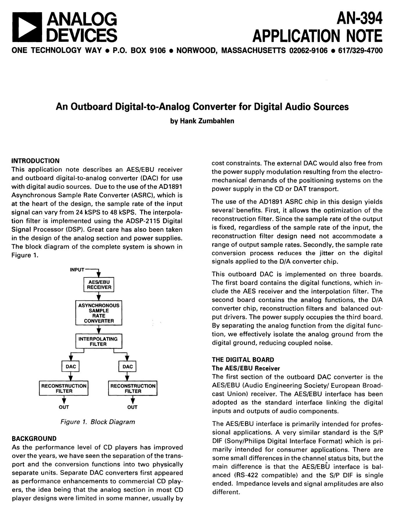

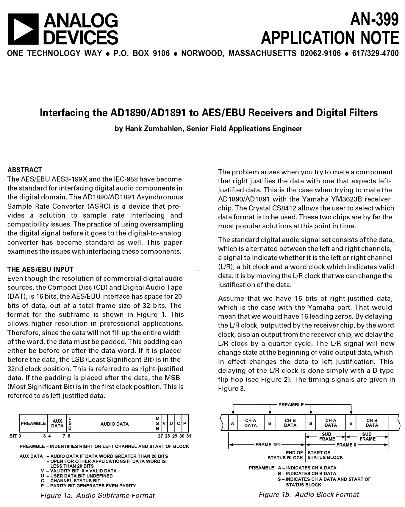

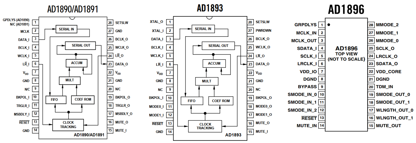

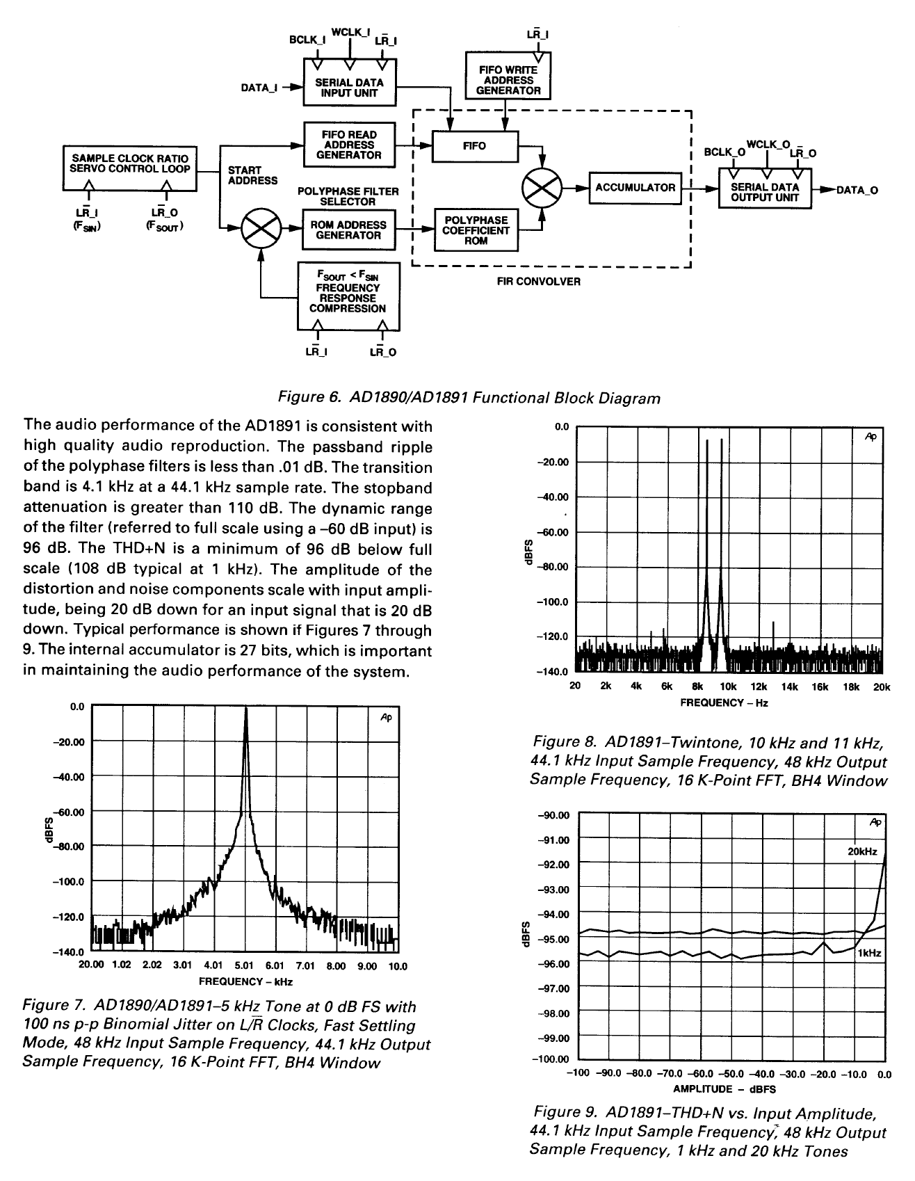

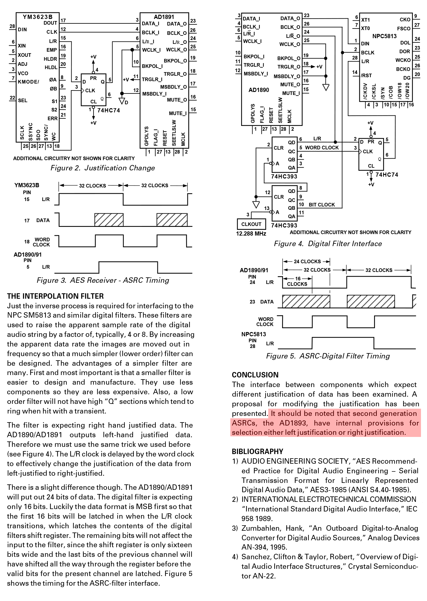

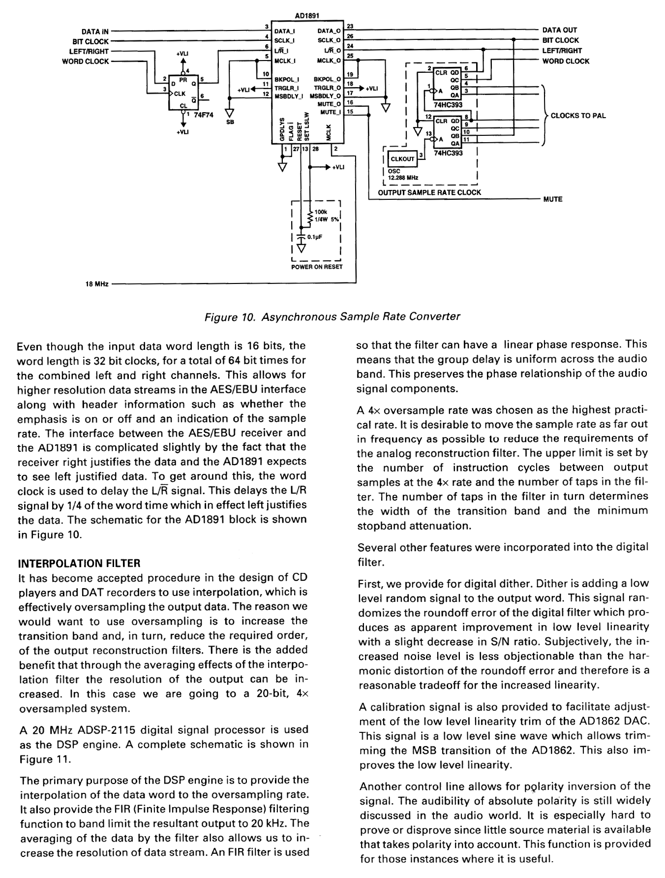

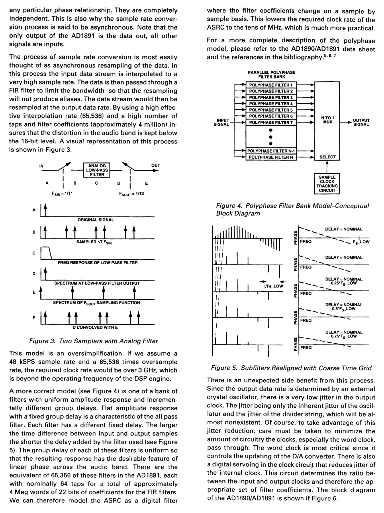

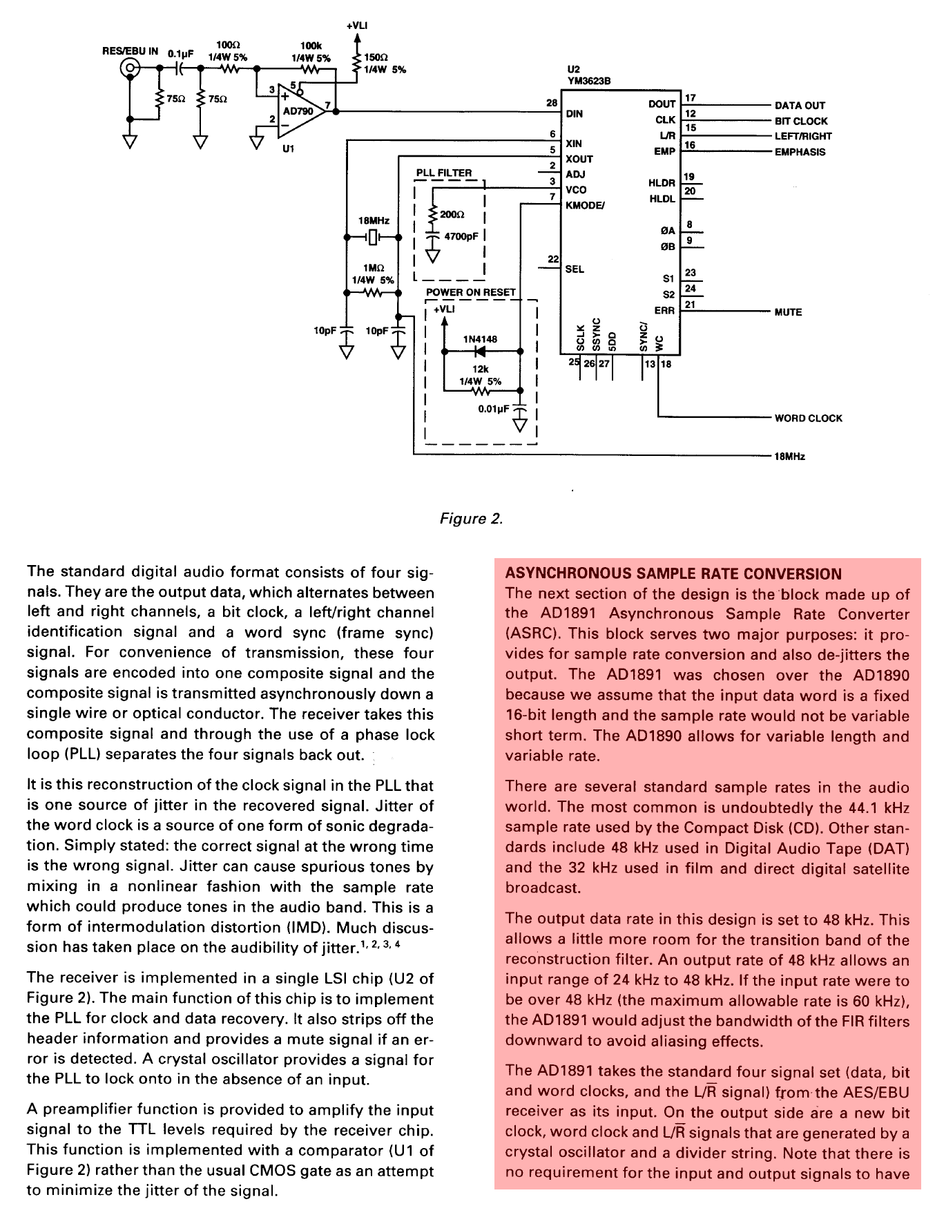

As there is such a paucity of info on the AD1893, I looked at what was available on the other Analog Devices SRC ICs such as the AD1890/1 and AD1896, they are similar but different.
I did find some information that is quite helpful in an Analog Devices application note:
Another app note about designing a DAC gives some details of how to implement the AD1890/1 and should also be applicable to the AD1893:
