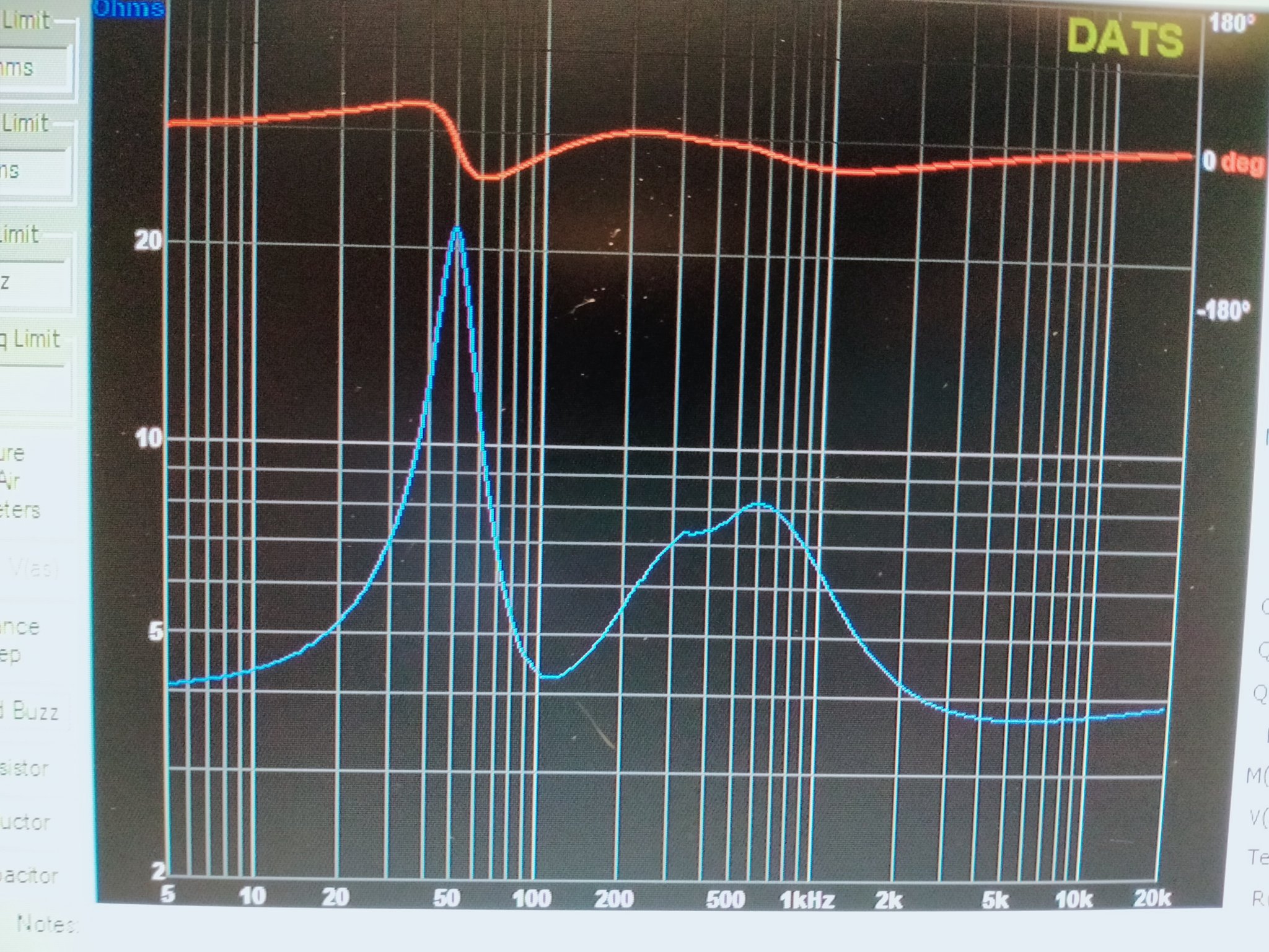

My loose plans are 2* 3way pairs 1* 2way bookshelf pair and a 3way centre style but any advice or suggestions would be greatly appreciated. I also had a play with the Dats v3 on my first builds (2way sealed cabinets) with the impedance sweep (attached). I would appreciate it if someone could point me in the right direction where to learn how to interpret this.

In general you don't want to try to use the driver where the big impedance rise is, 50 hz in your chart.
This article would be a quick start:
https://speakermakersjourney.blogspot.com/2016/12/crossover-basics-impedance.html
The single low frequency impedance peak in a sealed enclosure will always be higher than the driver's Fs, (free-air resonance). Your chart indicates a 50Hz low frequency impedance peak, so we can assume the LF driver(s) Fs is below 50Hz.
The upper peak is indicative of the crossover used on the HF driver(s).

Thank you for your response, you are correct in that the Dats v3 is essentially just a sound card but it comes with the resistor built in, the test leads and software to test the components. Yes by TS I was referring to theile small parameters.
With the big spike in impedance at 50hz I've been using the speakers (2way, first order crossover at 1khz) for ~8 years would you suggest adding some kind of filter to the crossover to mitigate this impedance spike? Or do I need to address the cabinet volume?

Thank you for your response, that article is brilliant. I'm now speculating that although I calculated to crossover frequency to be 1khz the second peak is at 600hz so I likely got some of my mathematics wrong.
