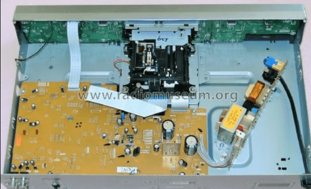

I think in this case the higher voltage just starts to push the relatively small transformer into the first stages of saturation. Also if you look at the circuit a couple of the rectified rails have 10,000uF reservoir caps which will give the transformer a hard time with very high current but short duration charging pulses. The resistors literally just take the edge off it.
This is off the web but shows the small physical size.

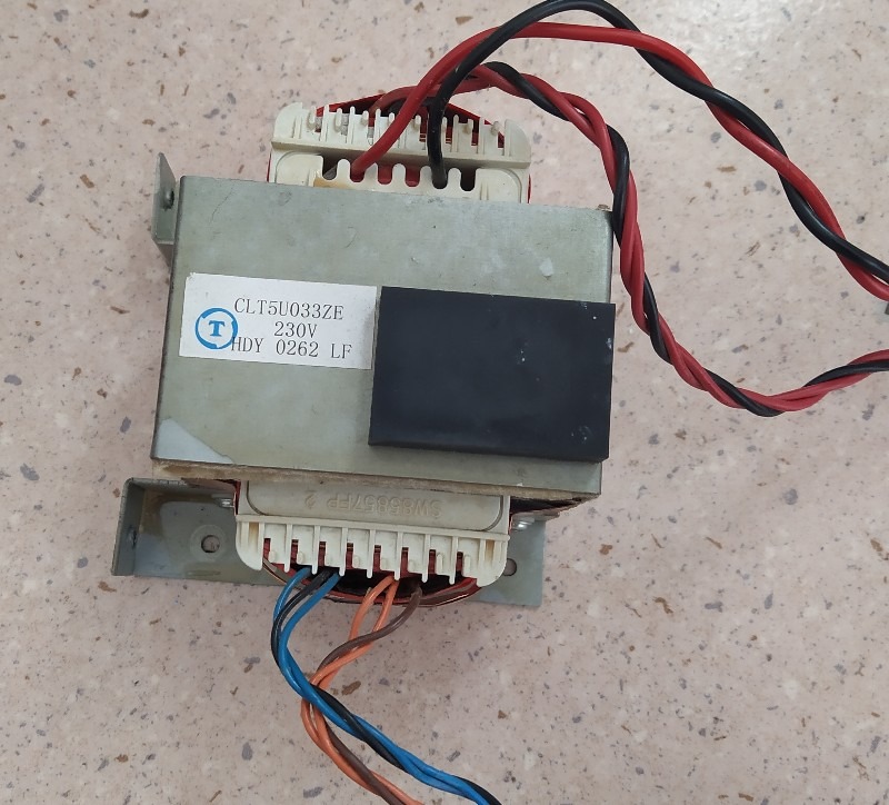

Yes, it is unthinkable, LOL. You can measure the voltage of that not-connected point on the transformer against the primary common. If it is higher than the input voltage you have a transformer with 220-240V taps. And connecting the 240V tap should improve the situation. If it is not tapped, there are a dozen of other, better options to reduce the mains voltage to the standby transformer. But none are as simple as the unthinkable series resistors. So if it works for you, it works.
You have actually just increased the primary resistance of the transformer, which has resistance anyway. Nothing ventured, nothing gained. An excellent solution to an irritating problem. You could have done this with an appropriate size capacitor as well, I guess. A lot of cheap Chinese products just employ capacitor droppers. It is illegal in Europe I take it but it is done. Capacitors don't radiate heat either unless broken.
Work it does fortunately. Next time it is out and with the top off I'll have a measure for curiosity. The very small standby transformer is silent, it was the main transformer that hummed.
I did actually measure the primary resistance at 310 ohms and was really surprised that the little cap across the relay contacts is able to maintain around 17 volts across the primary in standby. Perhaps just keeping a little voltage on that unregulated analogue line helps with a silent switch on although I think the muting transistors will be permanently on in standby as the system control is fed from regulated 3.3v rail from the tiny standby transformer.You have actually just increased the primary resistance of the transformer, which has resistance anyway. Nothing ventured, nothing gained. An excellent solution to an irritating problem. You could have done this with an appropriate size capacitor as well, I guess.

There is just one tap: 230 V

I agree. It's the heat buildup that kills the primary. I think at first isolation fails somewhere, creating a set of shorted windings. Those will get so hot it melts the wire. In the end the winding goes open and the transformer is scrap metal. Rewinding is mostly not feasable, hours and hours of work. Even more because the primary is usually under the secondaries so every winding has to come off and has to be redone.
