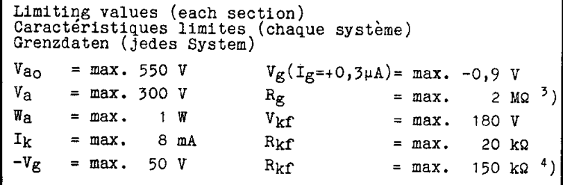

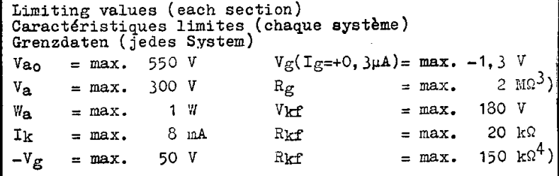

Valve datasheets almost never specify the DC grid current. Philips datasheets often specify how negative the grid voltage has to be to keep the grid current below 300 nA, but that is all there is to find; for example, the 2 February 1955 Philips ECC83 datasheet specifies that VGK < -1.3 V for IG < 300 nA and the 5 May 1960 Philips datasheet relaxes that to VGK < -0.9 V.
