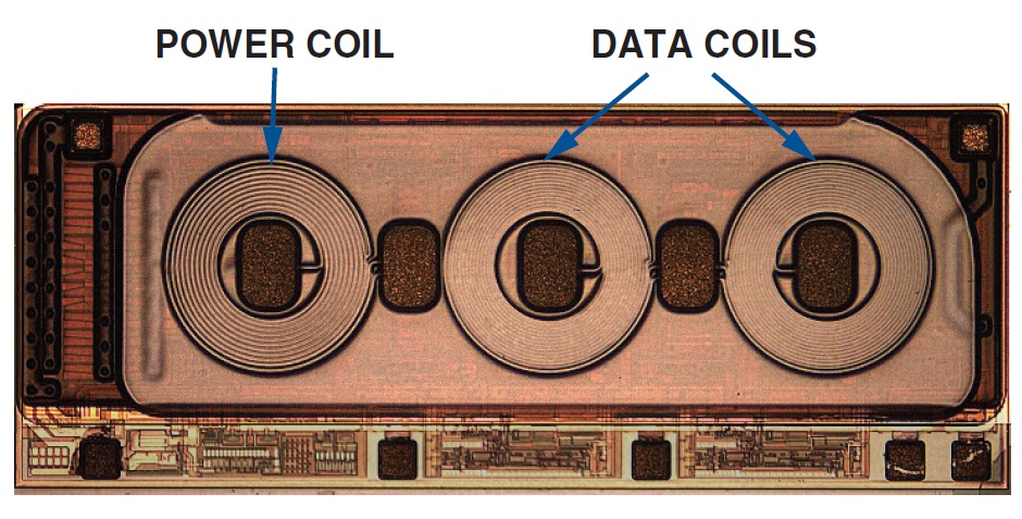

ADI iCoupler technology:
Digital Isolators | Interface & Isolation | Analog Devices
http://www.analog.com/static/imported-files/overviews/isoPower.pdf

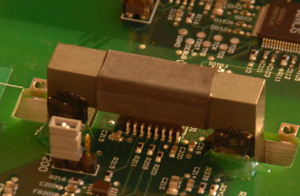

inside pic of the thing + the Berkeley implementation:
