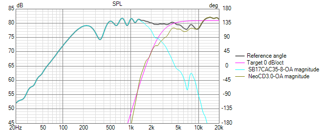

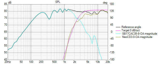

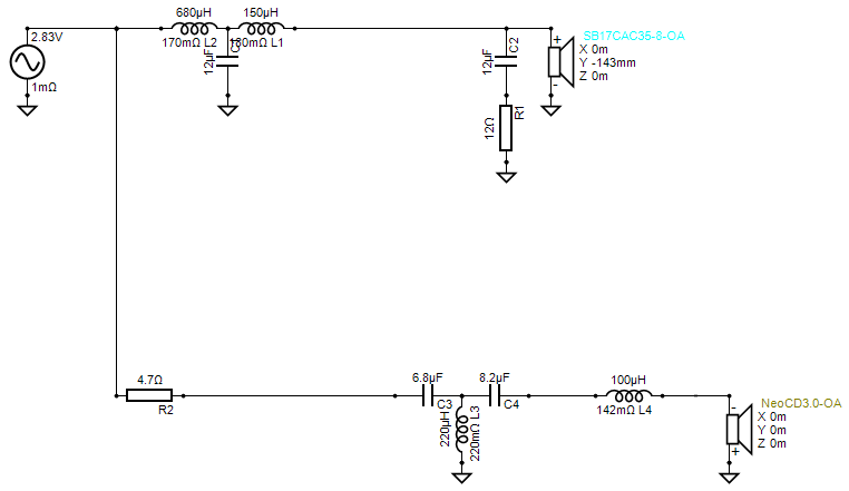

I say try it with and without an LP on the tweeter. I built some two ways with a Fountek ribbon and I didn't like the rising output above 10khz so I added a 100uH inductor after the high pass. I went back and forth with it and without it when testing. To my old ears it sounded pretty much the same either way, but I assume my dog is happy with the inductor in circuit so I left it in. Here is my schematic along with the predicted responses, you guess which is which.
