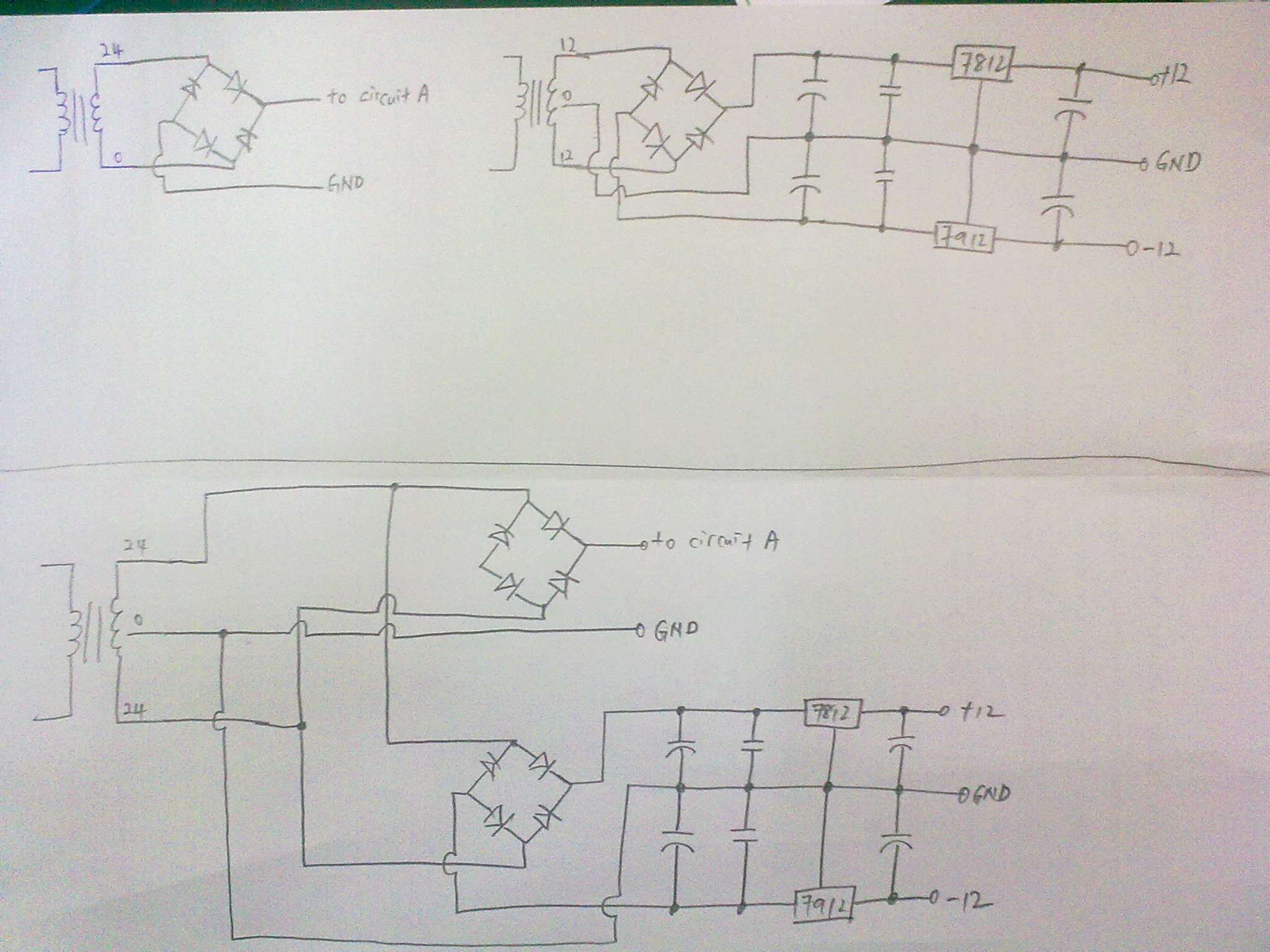

Actually i want to combine this two circuit(above part) by using only one center tap transformer. At the beginning i'm using two type of transformers but now i want to combine it to become using one type of transformer to save down one transformer. So instead of using one 24-0 and one 12-0-12 transformer i combine it together by just using one 24-0-24 center tap transformer as shown at the bottom part.
Does my circuit correct to get the final output voltage as the upper part?
thank you.
