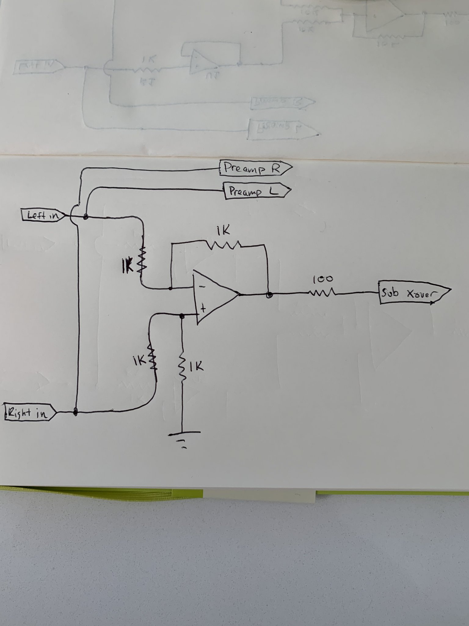

Does this summing amp circuit look correct?
I’m adding a sub to my 2ch setup.
Im wondering if I can omit U1, U2, R1 and R2 without degrading the signal to the preamp.
Is the buffer on the input necessary? I want to avoid any interaction of the two channels going to the preamp? Thanks
U1 and 2 are useless. The inverting input of the last is a "virtual ground" and no merge of one signal in to the other.
I suggest to try to substract both channels in place of add them. Better sounds appears in live recordings and with the 3rd speaker placed back in the listening site. Add a volume control to this 3rd channel too.

Interesting. Using a differential amp to merge right and left for the sub wasn’t something on my radar. Thanks for the info.
So would this work as a unity-gain subtraction circuit for me?

I think the virtual ground mixer (original post) is the way to go tbh and yes, you can omit the first opamps as long as you are OK with the 10k's setting the input impedance for each input.

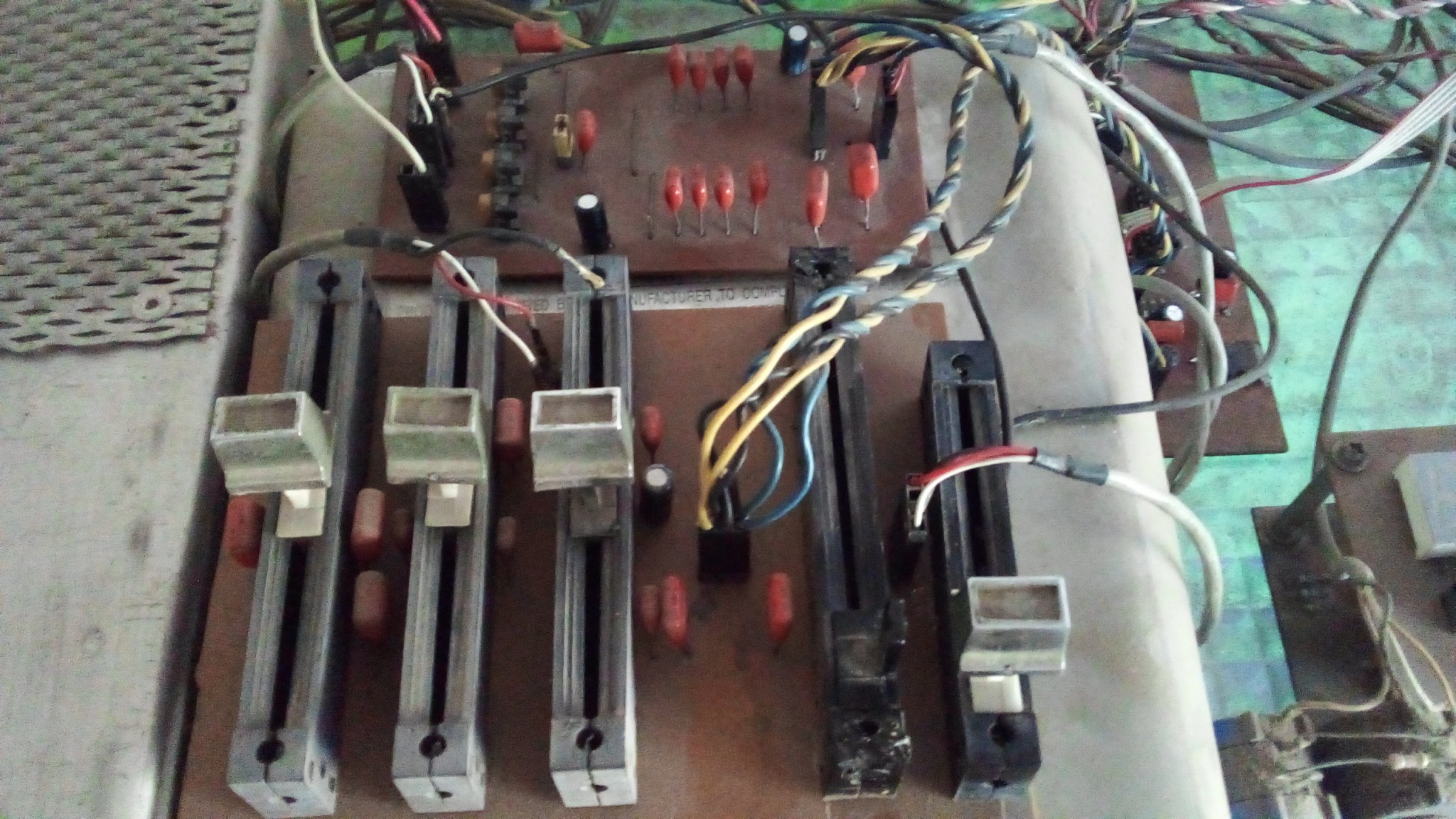

I'm not sure if Osvaldo is thinking of the old Hafler set up where you could connect a speaker between between the two 'plus' or live speaker terminals of a left/right stereo setup and get a 'difference' channel to a third speaker placed at the rear.
Reactions: rayma

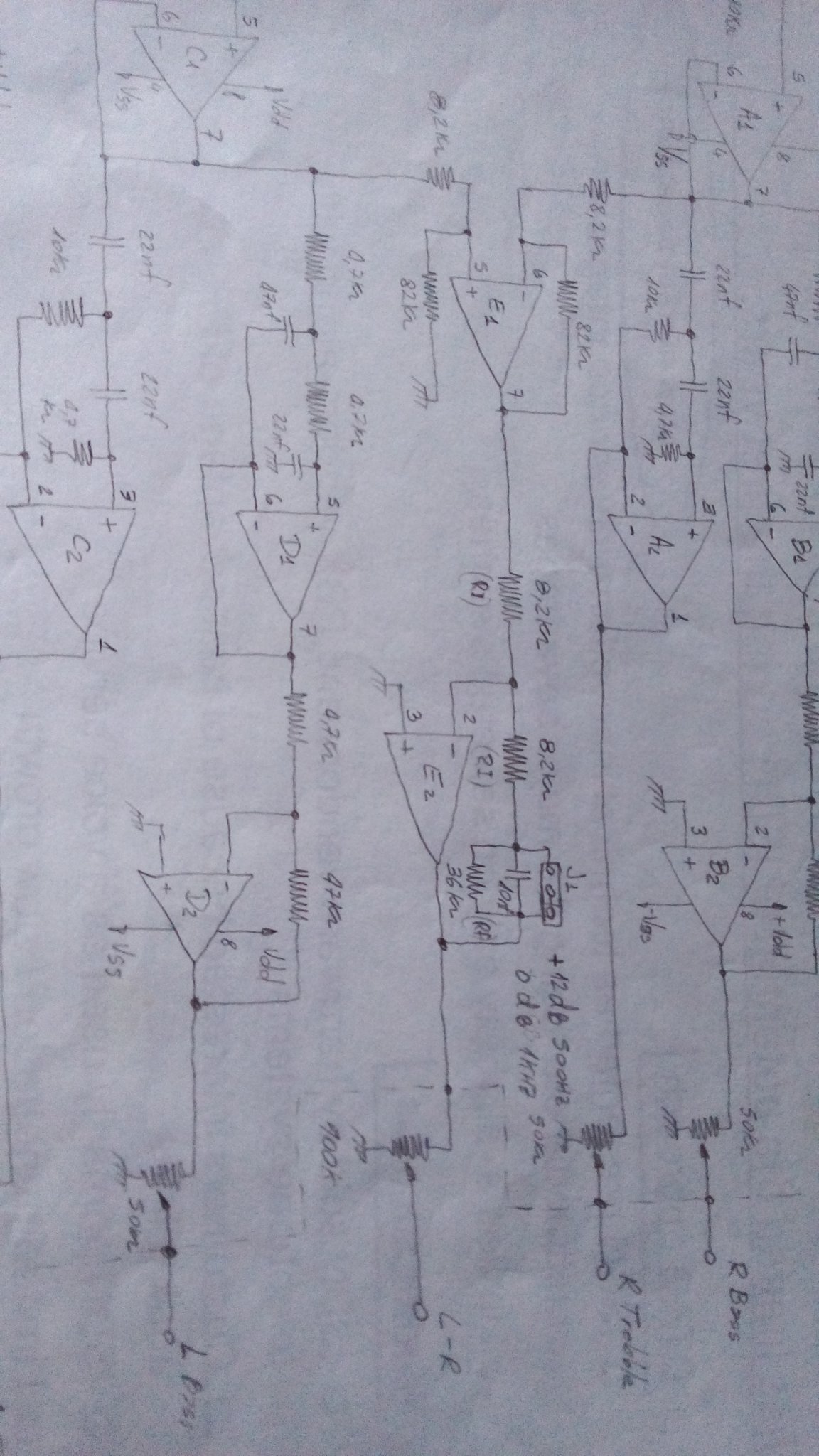

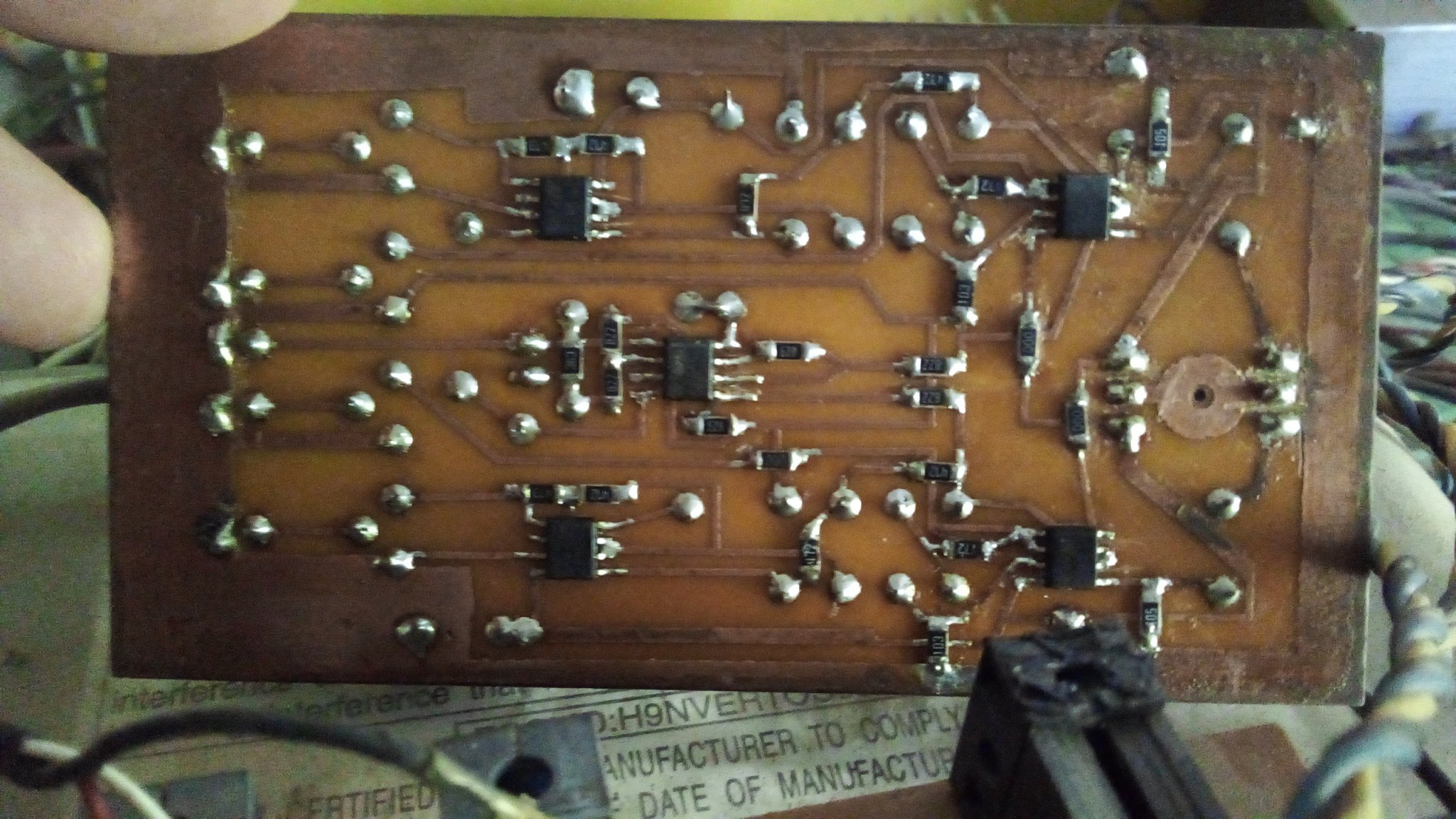

Exacly. I had implemented this idea using a "rester" in place of an adder. I saw this one in an old magazine about 1972 my dad collected, and I use the same idea but add a third volume control independent of the main and an own amplifier. Too low the setting of it, nulls the effect, and too high, strange sounds are created in general ugly. But there is an optimum setting that let you feel you are in the middle of the recording set.
This effect is much more pronounced in good sources recorded live and with, say, an MP3 of 320KB/S. Lower quality signals are very unpleasant and this pot must be at 0. The rightmost pot is my 3rd channel volume ctrl, and the middle TL082 in the second pic is my "rester".

Still more. I rescued my schematic 20 years old. In such magazine, the author suggested to add some kind of bass boost in the 3rd channel, this is why I added a second stage to behave as low pass but in practice and in my experience, it isn't good and the JP remains shorted (plain gain).

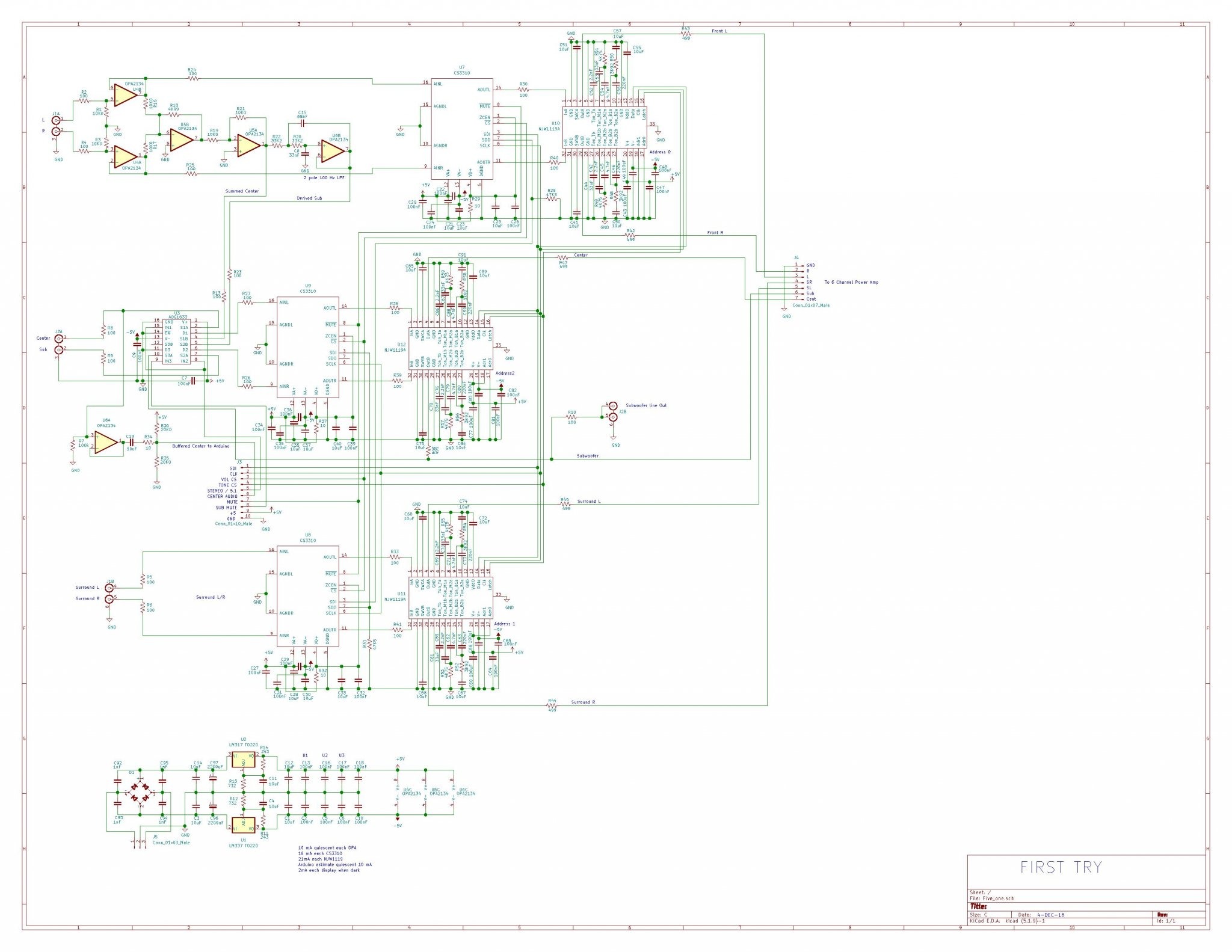

U1 and U2 are not useless. They raise the input impedance way beyond to
10K Ω of the actual summing amp. Not useless but also not needed if 10K Ω
is OK. I used them in the drawing to get back up to 10K Ω. You do not want
a differential amp as your summer as the output is only the difference which
is the opposite of what you want for the sub.
I included the 5.1 preamp for my TV project which has been used for almost
4 years. The upper left corner is what you want but my 80Hz filter is actually
100 Hz. Change the 33k2 resistors to 39k2 to correct that. The gain on my
summing amp is 1/2 of your initial drawing to be sure it doesn't clip.

Thanks! That circuit looks like exactly what I’m looking for.
What type of filter is that low pass? Butterworth?
Also, is that a volume control IC that the inverting inputs from the first stage go to?
The filter is a Butterworth which you can tell by the 2:1 ratio of C15 and C8.
The LP filter is for when it is in Stereo (3.1) mode where the mono mix is for
the center and sub channels. They are switched by U3 controlled by an Arduino.
The original writeup from 8-29-2019 if you're interested. Search
5.1 channel preamp.​
