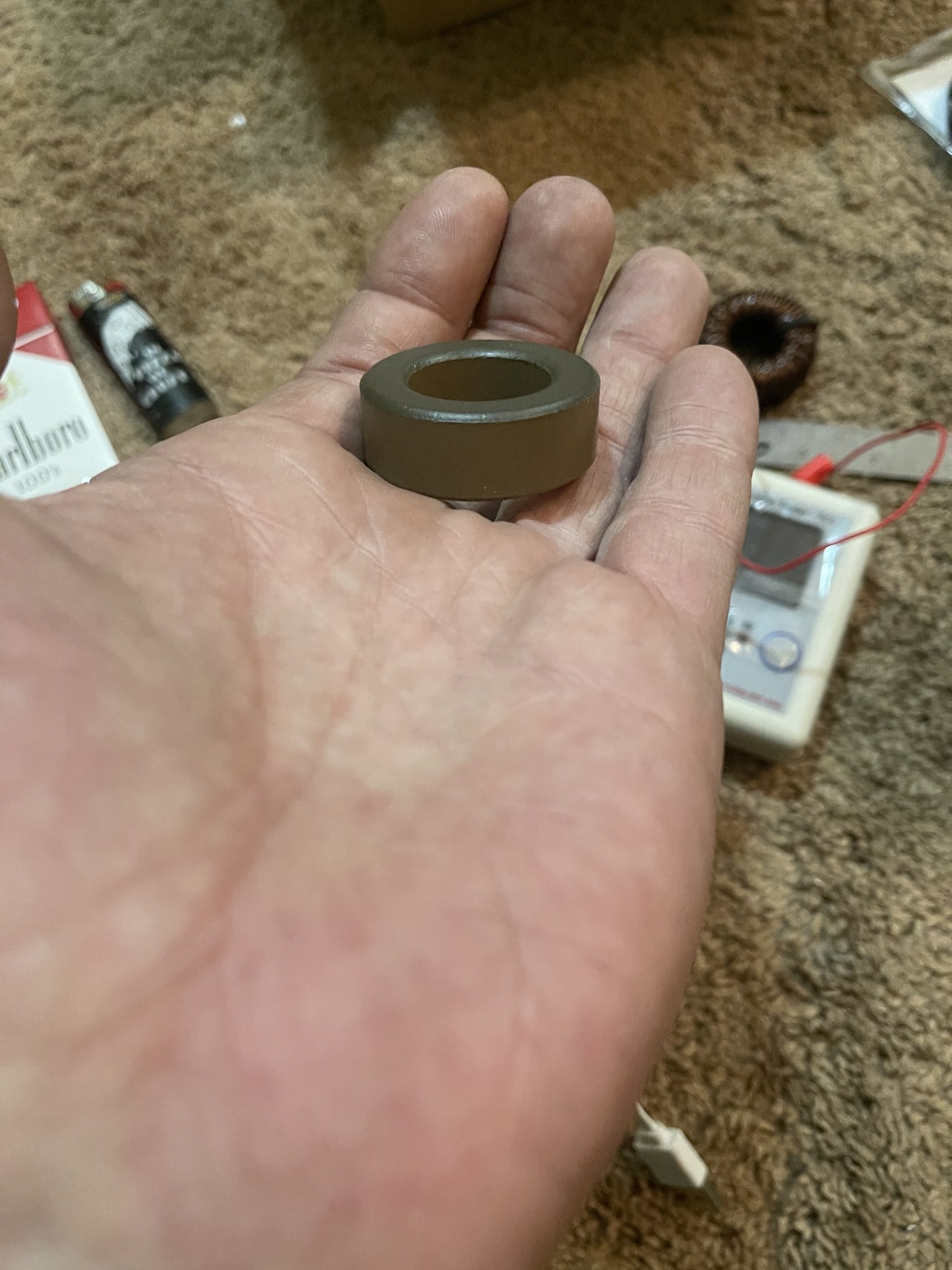

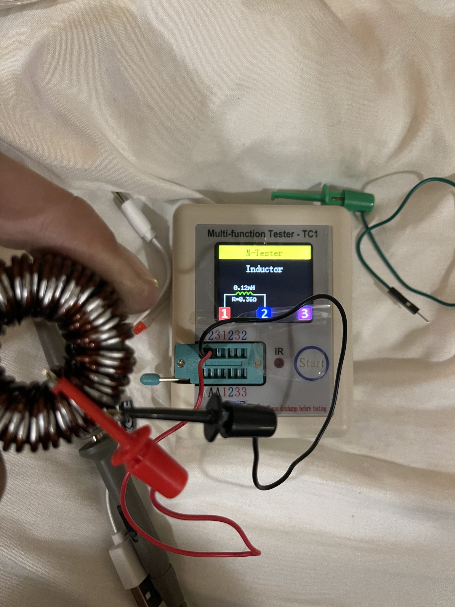

I’m rewrapping the inductors on my Kicker 06zx750.1 class d monoblock car amp as the shielding on 1 was compromised throughout, 2nd doesn’t look too bad to where it would malfunction so I tested it on my cheap-o LCR tester and got a reading of .12mH and .32-.36ohms. Does that seem anywhere near right for this amps inductors?

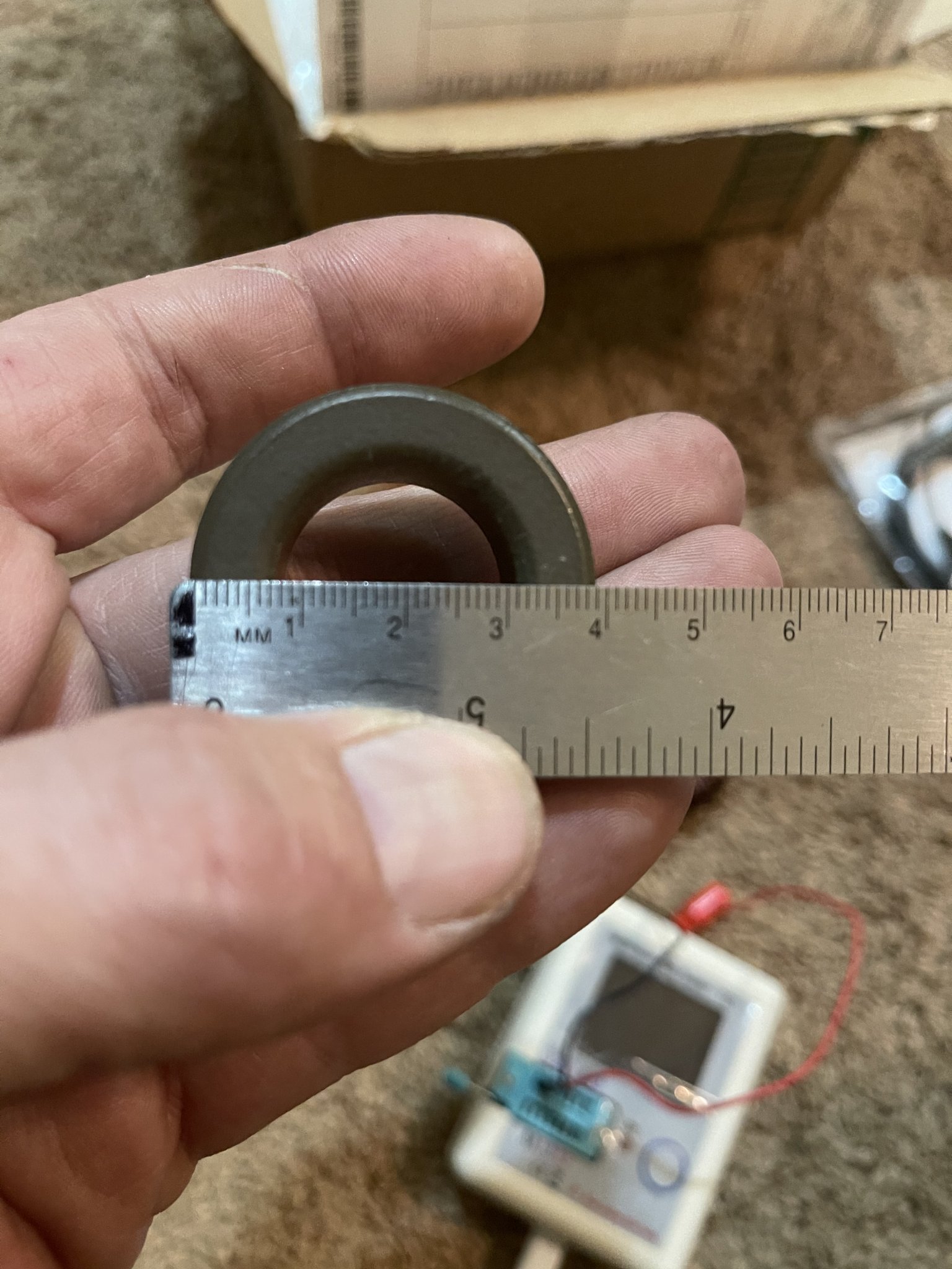

As far as the inductor itself has a brown(green on 1side) core that measures 40x23x15mm with what seems to be 10awg magnet wire (waiting for wire gauge) it has 35 turns total, 20 1st wrap, 152nd wrap. I apologize if some of this I go is off or not needed, still learning about inductors, etc.
Came across a calculator that says the core should be a 98 AL with above specs, seem legit? Still searching for a site that explains the type of inductors used in this amp, Im also seeing color of core has a play on what’s what as well, like a designation of building material? Can’t seem to find a brown/green combo unless it’s just discolored but both are same. I’ve included some pics. But ya any help or direction to self help would be appreciated, thx.
Also I guess I could just rewrap each core with appropriate length/size/turns of magnet wire and just be done with it, but I would like to know the what’s what of it, common ratings for a core this size like this used in this manner, etc. but ya, lol.
