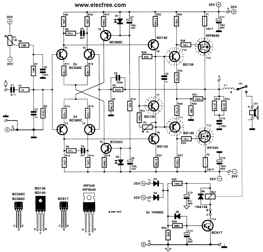

I found this scanned schematic in the net, I got interested and would like to construct it (for the reason of low power and parts availability), i was hoping my 200w 8ohm speakers won't blow
Seriously does this schematic looks promising?

Isn't this is the Elektor (Giesberts) Hexfet amp published in the december 1993 edition? There's also another higher powered version with IGBT's published in sept 1995. I have built the IGBT version 12 yrs ago, and experienced some stability problems (oscillations).

this uses a FET CFP output stage.
It could have oscillation problems.
The BD139/140 used for VAS are attrocious for VAS duty. They are good for drivers in the next stage.
However, I notice only a little stability compensation added elsewhere.
The use of the high Cob VAS transistors may be a way of incorporating Cdom without fitting/buying extra components.

The first amp makes a good oscillator. Avoid it.
The second amp's schematic has several errors too.
Quasi's NMOS amps are good designs - Quasi's DIY Audio Site

You could always build mine which uses Lateral FET'. It's all here but you would have to make your own boards. Super stable design due to the topology used.

is post1 in that link the recommended schematic? or do we search for later versions?
Circuit is correct, however 10 ohm non inductive resistor should be added across output inductor.
I would advise anyone contemplating this design to read all the thread to gain an insight into it's design and operation. It's very forgiving (in the best possible sense) for a DIY constructor and should be totally stable even with less than ideal layout.
