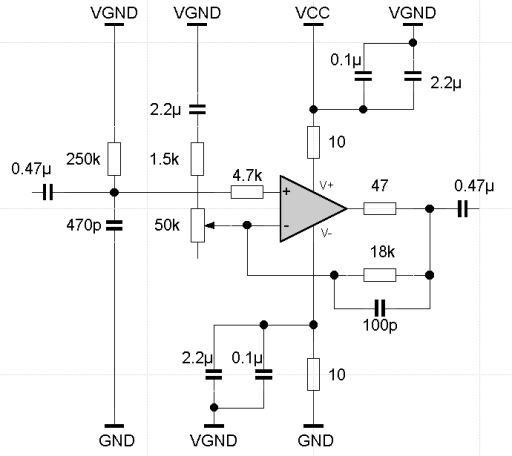

does this make sense?
This is one of the gain stages of the clean channel
of a guitar preamp I'm building. It is driven by a
unity gain buffer and following it is a tonestack and
then another gain stage.
More important than keeping the 'hi-fi-ness'
of the amp is to suppress all kinds of noise
as much as possible since the working environment
is usually not the best (long cables, bad grounding,
tons of other equipment inducing noise on powerlines
and into signal path)
I'm just wondering if there are any errors in the
schematic or anything that can be improved.

Hi nosegoblin!
The upper 10 Ohms resistor must be conncted between the positif rail and the point of connection of the upper capacitors and the + pin of the op amp.
In the negatif side ,the resistor is correct but must be connected to the - rail and not the ground .
Cheers 😉
PS: this will permit operation!

it might be for single rail application. With one slight change, it will work.
I haven't yet drawn the virtual ground driver
circuit. I figured a BUF634 would be perfect
for the job. Pretty common I guess. So if VCC
would be 30V then VGND is 15V and GND 0V.

Yes, I am uncertain about the placement of the
10 Ohm resistors and possibly the decoupling
should be done directly from the positive pin
to the negative pin. Also most examples assumes
double rail operation while single rail operation
is rarely touched.
So if I understand you guys the upper 10 Ohm
resistor is in the wrong place, but the rest is
pretty much okay.

as far as decoupling is concerned, the caps can pretty much be tied to anything, from Vcc to Vgnd to Gnd, as they all are "gound" for a/c signals.
the decoupling resistors should really be between the power supply (Vcc or Vgnd) and the decoupling caps. But in this case, the time constant is simply too small for them to have any real effect so I would take them out.
another thing, I would use a pot to alter the gain of the circuit. in your case, the gain goes from 1/2 to 2x. a lot of opamps aren't stable at close to unity gain.
I would have put the pot upfront, as an attenuator to the non-inverting terminal.

Hmm. My first intention was to make sure
that no rf noise wouldn't find its way to
the output of the opamp. When having long
cables it is not uncommon hearing long wave
radio broadcasts. Maybe just the caps are
more than enough?

One last question. The gain of this stage is
calculated according to G = 1+R1/R2, thus min
gain would be G = 1+18/(50+1.5) ~= 1.35, and
max gain G = 1+18/1.5 = 13 ( 2.6 dB to 22.3 dB ).
Or??? Is it just G = R1/R2? It's G = 1+R1/R2 for
non-inverting stages, right?

Yes !...you are right!! with your set up the minimal gain will be 1,35 and the maximal gain 13.
You got it! 😉
About op amp choice...i think guitar capsules have high impedance output...if that is the case then you must use a Fet input stage op amp for lower noise and not load the capsule.
