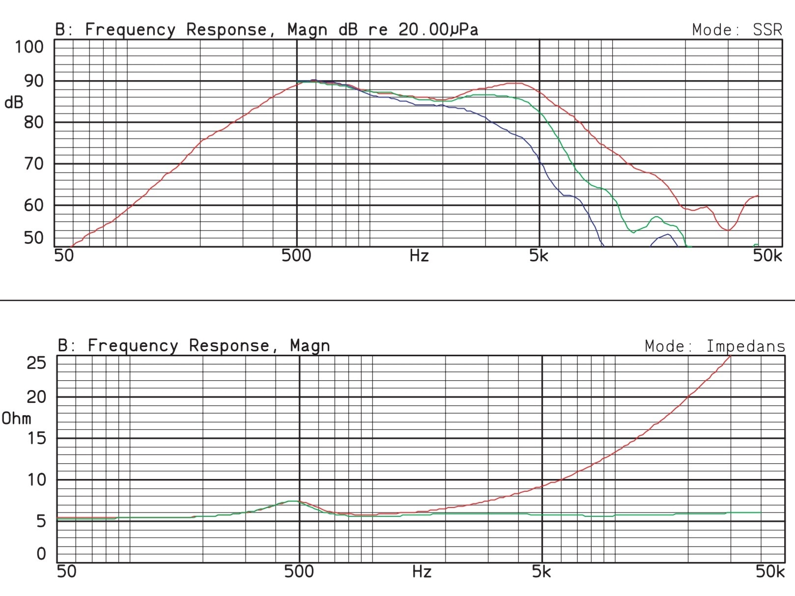

Two problems with the MD142 are low sensitivity (2.83v @ 4 ohms) and a small back chamber giving it higher Fs. Its designed for car ausio use, so compromises are made for this application. I'd use the Dynaudio mids that came in some older Volvos, which are more suited for home audio IMO.

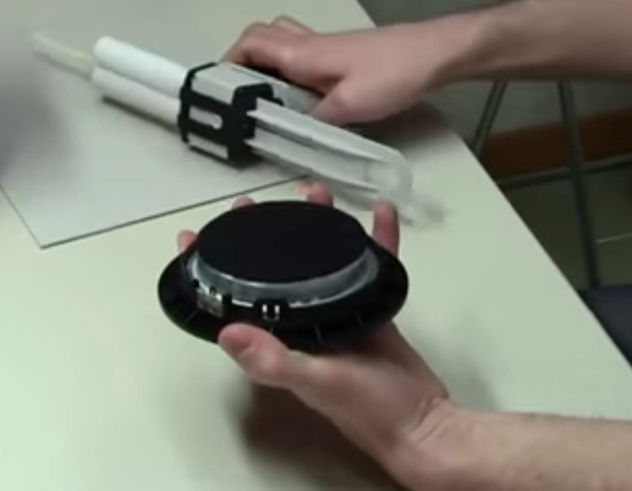

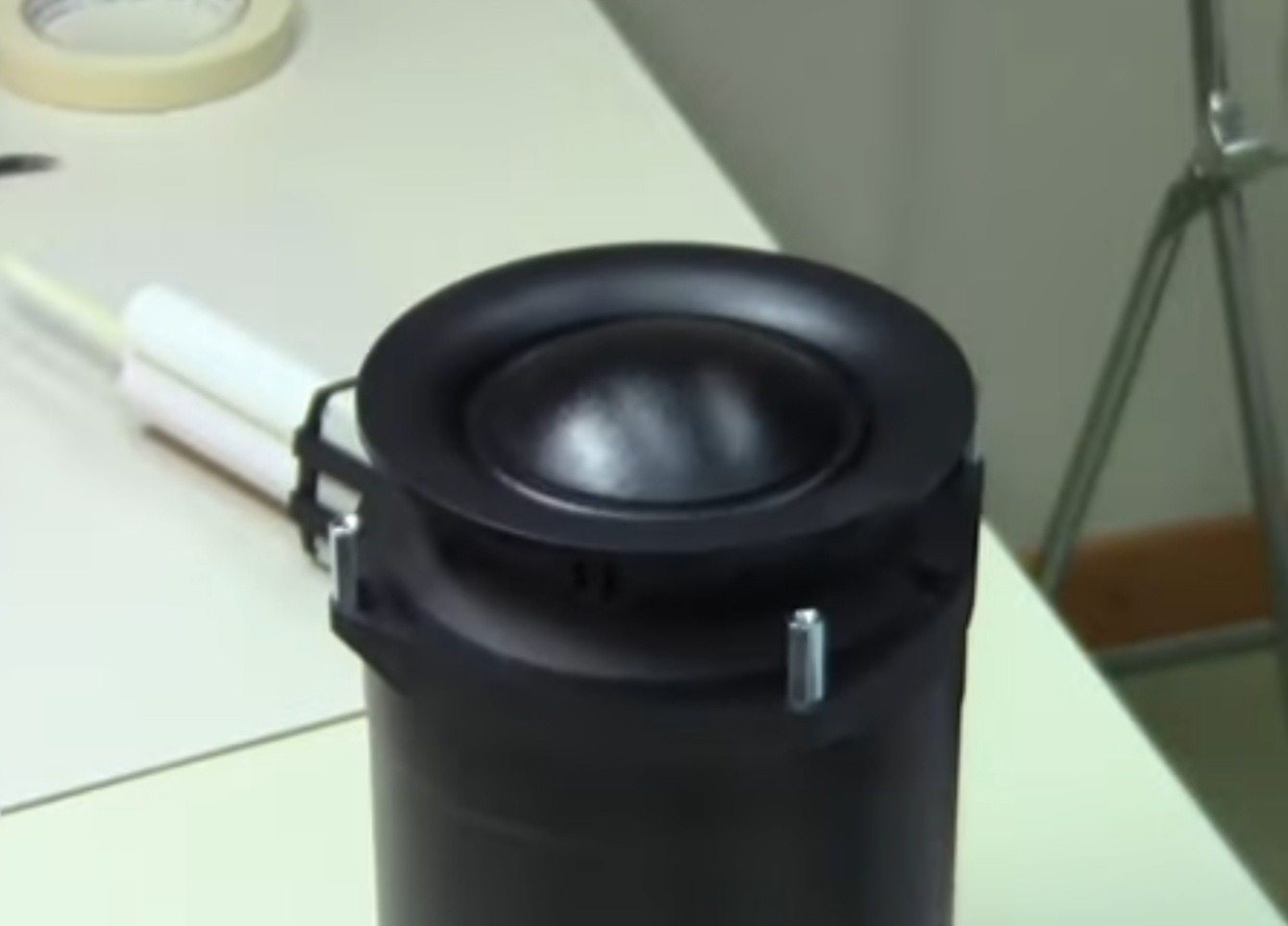

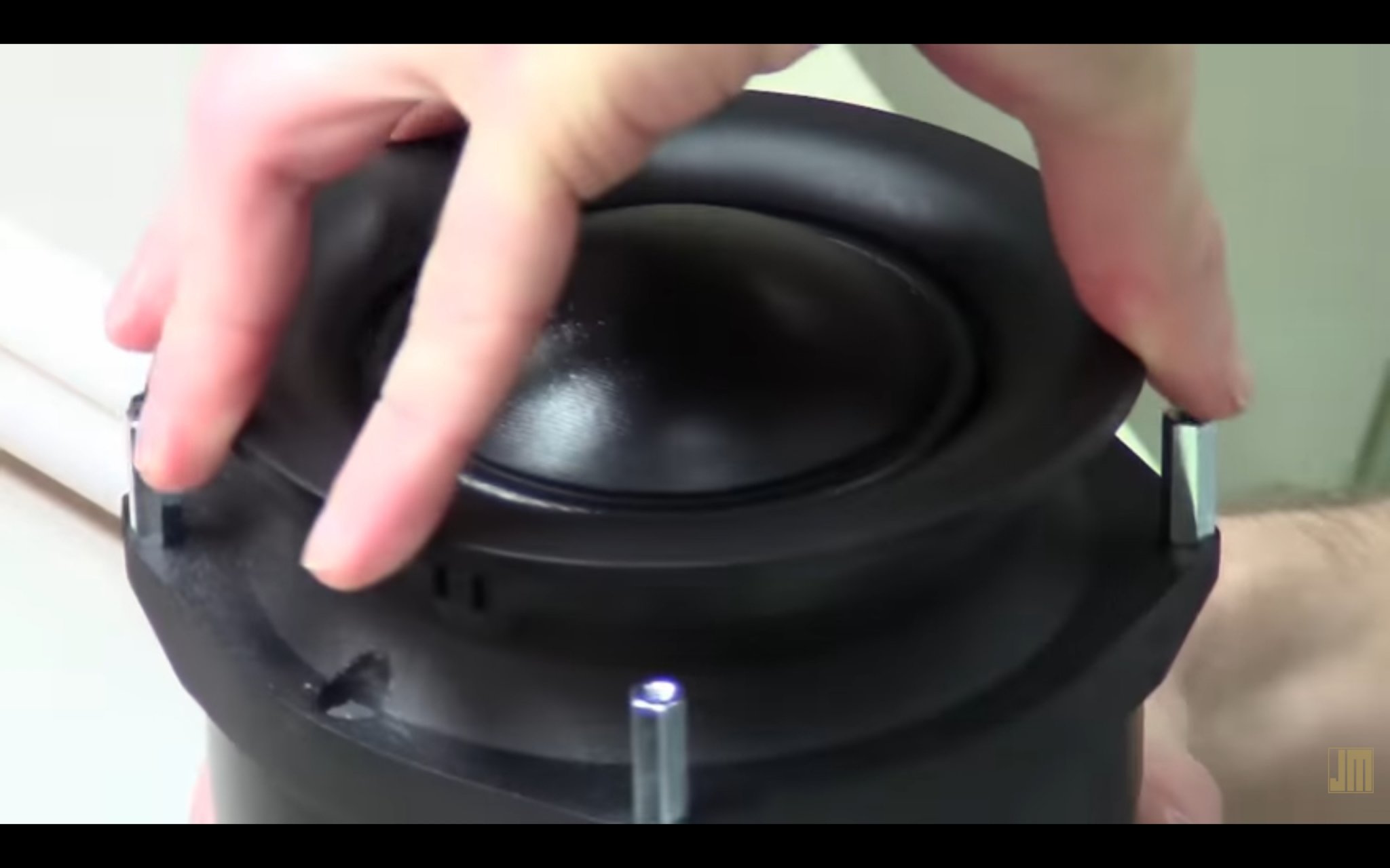

Take a look at these screen shots from a Jean Maurer speaker assembly video. Recognize the mid in these images? Yes, a variant of the Scanspeak D7608.
