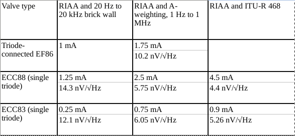

When you want to use tubes for moving magnet amplifiers, it's usually the tube's equivalent input voltage noise you have to worry about. You can reduce the white voltage noise by biasing the tube at a large current and reduce the 1/f voltage noise by biasing it at a low current. Clearly there is an optimum where the total noise is minimal, and that optimum depends on how you weigh different frequencies.
Based on data published by Merlin Blencowe (Merlinb on this forum), I once calculated the attached list. The triode-connected EF86 is based on my own measurements of only two tubes. In the table, you find optimal anode currents and an equivalent white voltage noise level that results in the same total noise as the white + 1/f noise of the tube.
Another thing is record surface noise. If you don't care about the noise level in between records, you really have to mess up big time to end up with an amplifier noise level that's not masked by record surface noise.
