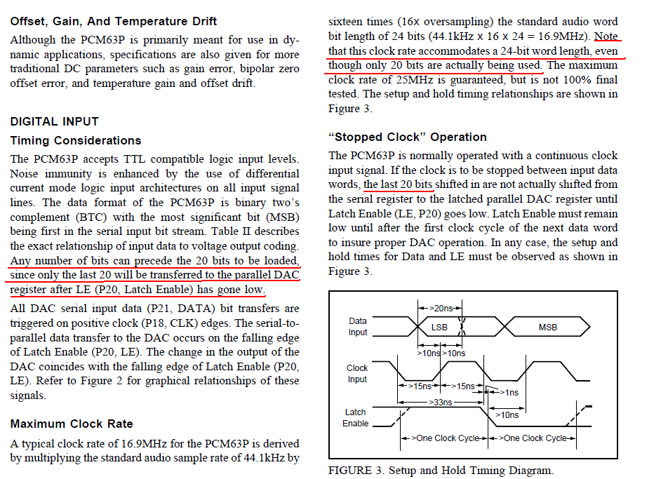

Does the PCM63 accept 16 bit input data only?...

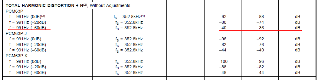

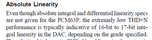

You can feed it with up to 24 bit, but only 20 will be used. Also the precision is guaranteed only up to 17 bit, but that's a different issue.

I think it should be working OK with 20 bit at input, even 24 bit (it wil be truncated, last 4 bit will be ignored).
