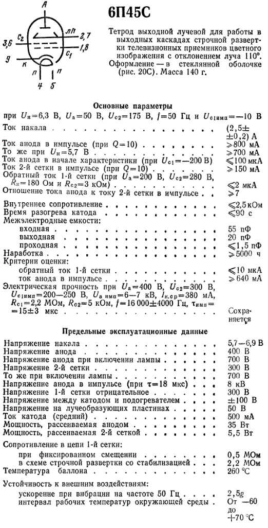

Does the EL519 and 6P45S have the same pinout?
Does this help?
