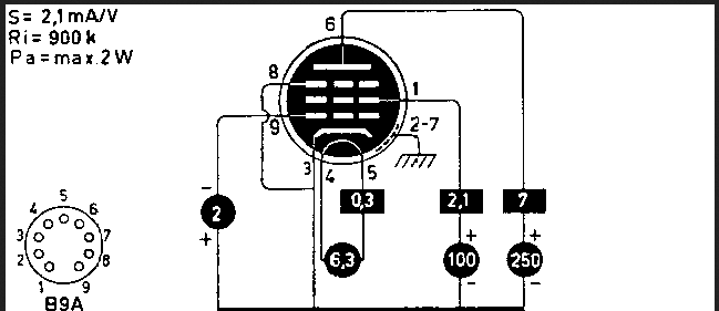

On Radiomuseum.org the EF88 has its own page, but I suspect this to be the result of the EF88 being mentioned in the Muiderkring handbook since the diagram for the EF88 comes from that handbook. The diagram does not show more information than de Babani guide does. Probably Muiderkring based their diagram on the data from the Babani guide.
EF 88, Tube EF88; Rohre EF 88 ID3876, Vacuum Pentode
At first sight it appears that there is some more info, like the pin-out diagram from a Telefunken handbook and a picture of the bottom side of the valve. But I could not find the EF88 in any Telefunken or Siemens handbook (but ofcourse I don't have acces to all their handbooks), so I suspect Radiomuseum.org used the pin-out diagram of the EF86 (or an other pentode with identical pin-out). And since the same picture of the bottom side of a Noval valve is also used on some pages of other Noval valves (mostly in cases where an actual picture of the valve type is not available) it is probably not a picture of the bottom side of an EF88.

According to the sources I mentioned in post #1 the pin-out of the EF88 is different than that of the EF80/E88F. The pin-out of the EF88 is however identical to that of the EF86, the EF83, the EF87 and the EF806S but the parameters of these tube types don't match with that of the EF88.

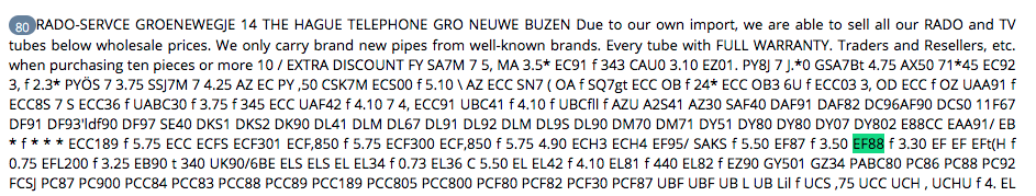

and a tube seller in the Hague also listed it for sale.

The diagram from Frank's site (your first attachement) is the diagram taken from the "Electronic Tube Handbook" by Muiderkring. The same diagram is also used on Radiomuseum.org.
Although the shop (called "Radio Twenthe") in The Hague still exists, it moved from the adress "Groenewegje 14" mentioned in your attachment a very long time ago. In the fifties, sixties and seventies that shop often published adverts in Dutch electronics magazines like "Radio Bulletin" and Radio Electronica". Most of these magazines are scanned and published on the NVHR site (see under the tab "Bibliotheek" on https://www.nvhr.nl ), so I'm pretty sure that the "EF88" in your second attachement is a misread "EF86" in one of those scanned magazines. I own a lot of those old magazines and never saw an EF88 being mentioned.
