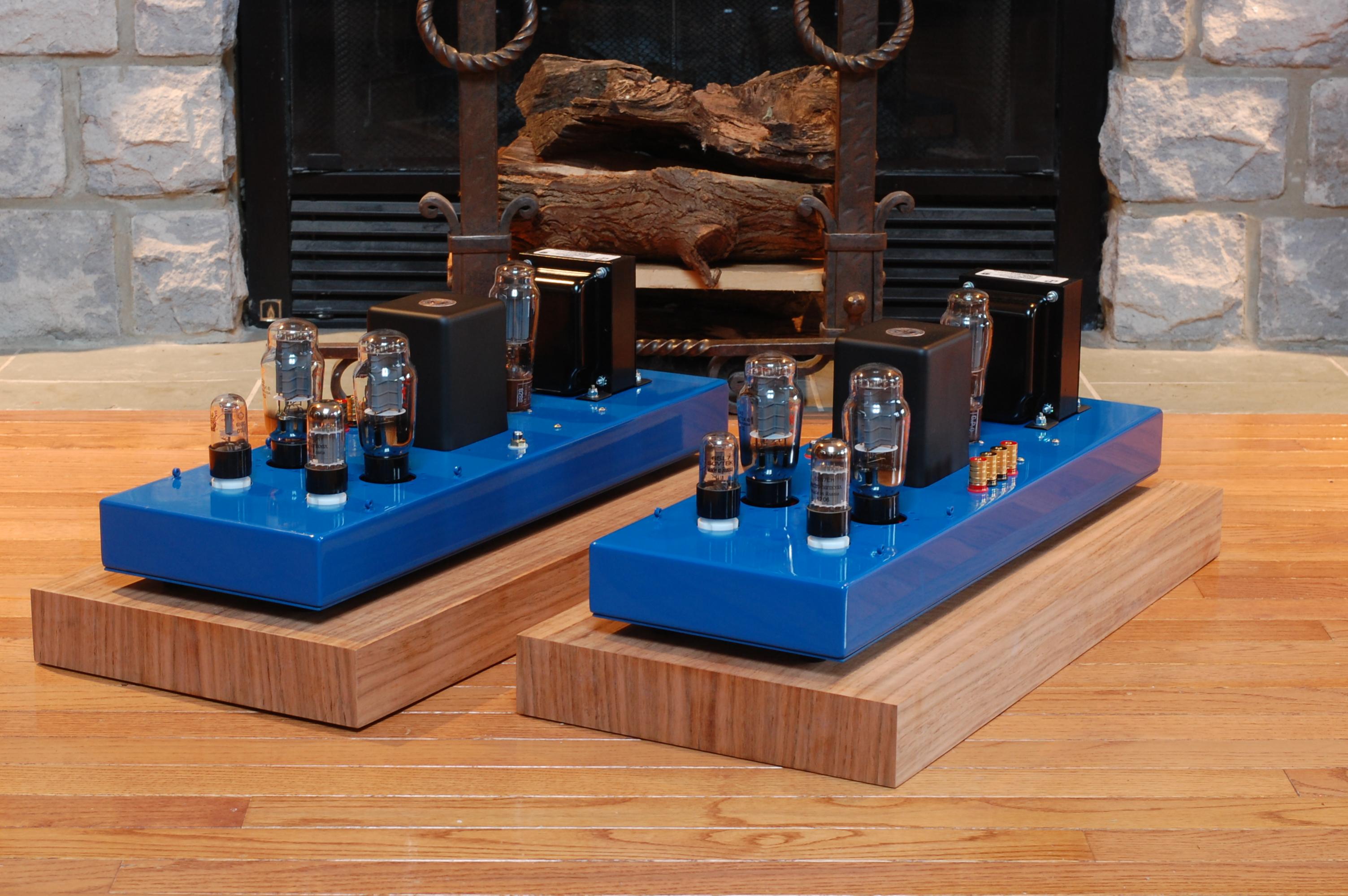

A sand amp will never look this cool... 🙂
